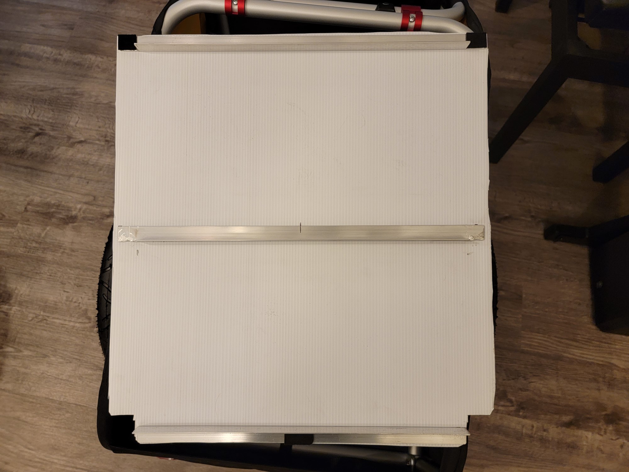

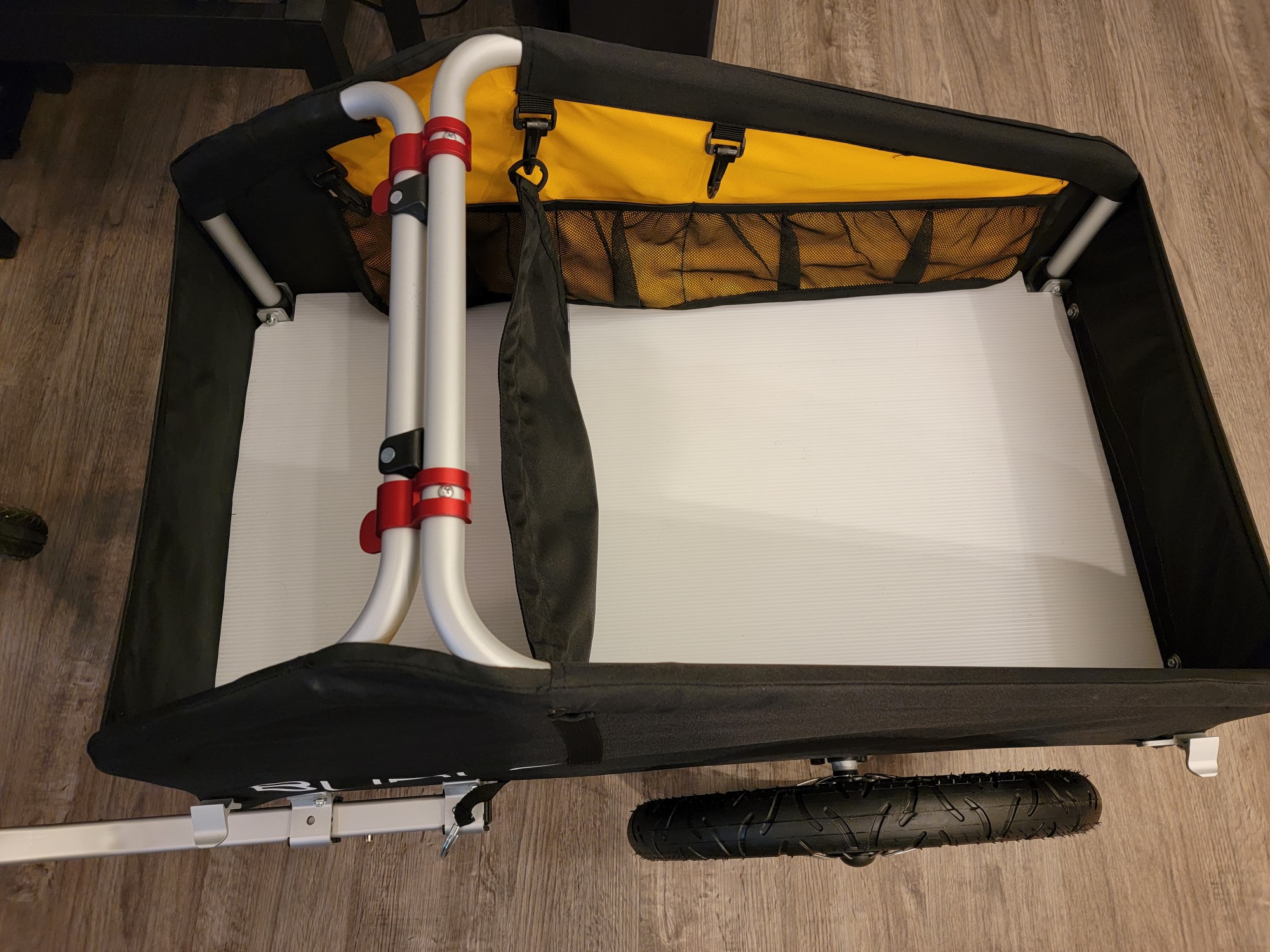

Here is the beginning of my build, using a Burley Nomad trailer. As others have noted, one drawback of the Nomad, depending on your use, is the nylon floor. The nylon walls should hold up well, but the floor may wear more quickly. I saw a YT video where someone used a single piece of 1/4 inch plywood, and painted it with a rubber waterproofing. I liked the idea, but thought I'd try corrugated plastic, as one of the YT commenters suggested.
I couldn't find thick, heavy duty corrugated plastic locally, so I bought what they had, and glued three identical pieces together, alternating the corrugations for strength. This gave me a floor that was about 1/4 inch, just like the other guy's plywood, but much lighter. It seemed a little more flexible in the middle than I would have liked, but probably would have been fine with reasonable loads. However, I decided to cut the floor in two, so I wouldn't loose the ability to use the nylon divider that the trailer has. This made the flexibility issue worse. So, back to the store for some angle aluminum (I want to call it angle iron, but it's aluminum) :)
Attached is a picture of the trailer with the floor installed (minus the cover), and another showing the underside of the large section of floor. Two pieces of aluminum are notched so they rest on the side of the frame, the third is cut short, so it rests on the rear of the frame. The short section of floor doesn't need a center support. I used 3M VHB tape to hold the aluminum, and Velcro to keep the floor pieces from bouncing around. It may look a little rough, but it's the best I could do with a hacksaw and a utility knife. Both sections of floor weigh 40 oz, total. I suspect that this is much less than plywood covered in rubber paint.
Adding a floor does slightly decrease the total cargo capacity, but the front of the trailer is deeper, so you have a hidden storage space beneath that section of floor. I plan on using that space for spare parts, and other items that I will rarely need. Thin items could go beneath the back section of floor.

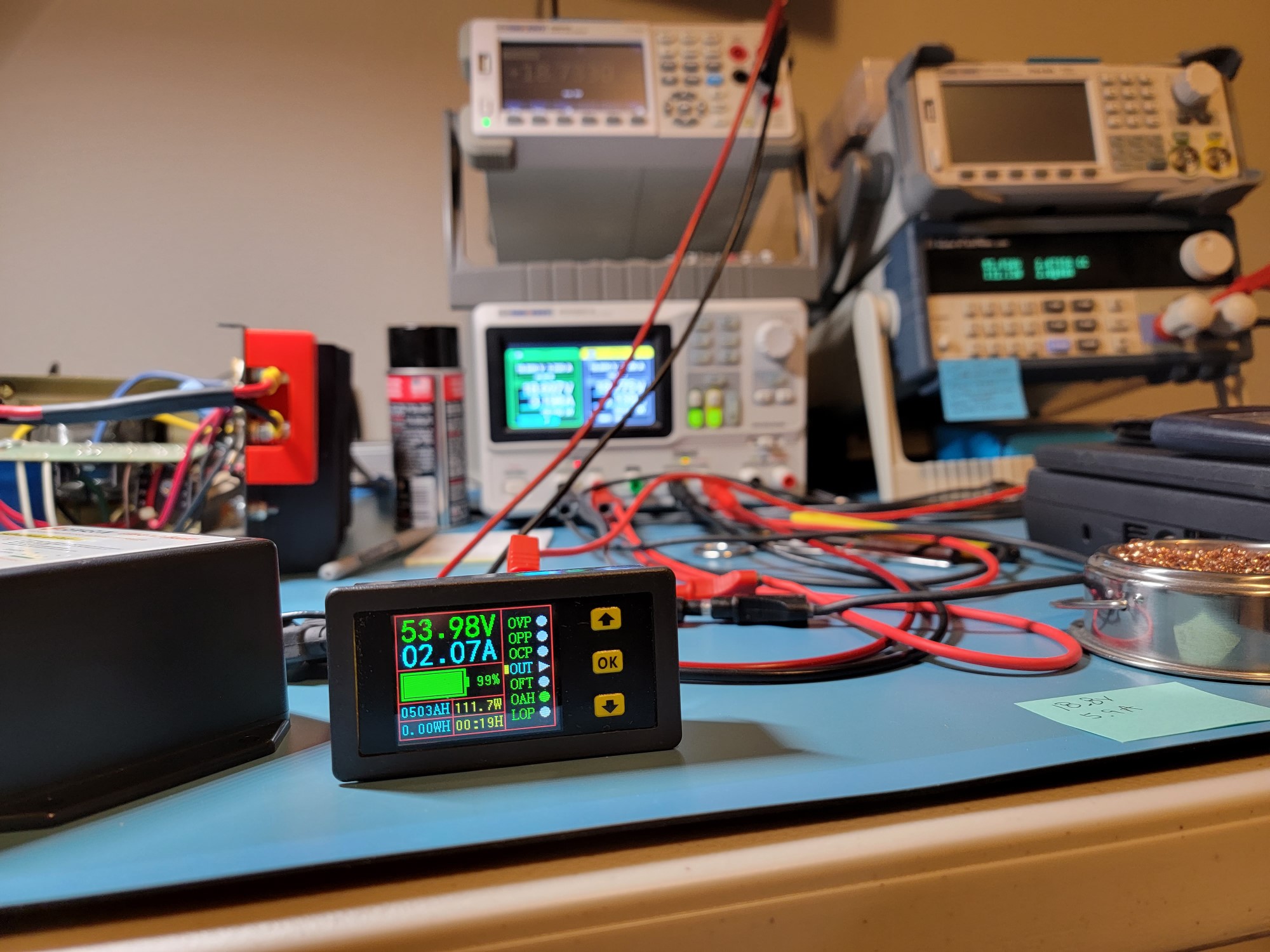

While I await the replacement solar panel, I hooked things up to do a load test. In the picture, you see the power supply (in the background) feeding the Genasun (half out of frame on the left), feeding a panel meter (center), feeding a DC electronic load (background, right). The power supply is simulating the solar panel, and the load is simulating the ebike battery.
The 110 W panel is rated for 18.8 V @ 5.9 A output, which equals 110.92 W. Of course, the panel won't give me 100% of this. I set the power supply to output 18.8 V, but 6.4 A, which is the maximum it can do. If you do the math, assuming 100 % efficiency, the Genasun should output 54.2 V @ 2.05 A from a 110 W panel. I managed to get the load to draw 2.08 A before the power supply went into current limit, and the Genasun started decreasing its output voltage. The panel meter seems to be quite accurate. Not lab grade accuracy, but more than enough for this use. BTW, ignore the accumulated AH reading, as I had something set wrong on the panel meter.
The panel meter is branded "DROK", and is their part number 200320. It is similar to many other such meters. Most of the ones you will find either use a Hall Effect sensor to measure current, or an external shunt. Most also are designed to measure 100's of Amps. This particular meter has an internal shunt for up to 20 A. Since I only need to measure a bit over 2 A, this is more than sufficient. Also, the high current meters will be less accurate at the very low end, where I am operating.
I let everything run for 20 minutes, to see if heat would be an issue. The panel meter was barely warm to the touch, and the Genasun was hardly any warmer. I shouldn't have a problem mounting everything into a waterproof box. I can always drill a few ventilation holes later, if needed. The box doesn't really have to be waterproof, as I don't plan on using this underwater, or dropping it into a big puddle. It will be housed inside the Nomad trailer. The critical part, the Genasun, is potted, so it is fully waterproof.
This setup will let me monitor the ebike battery while it charges from the solar panel. This isn't ideal, as I will have to keep an eye on things, to see when the battery is charged. Later, I may build a data logger, so I can track things better. That's a project for another day. During my initial testing, I'll just use an action camera, pointed at the panel meter. I will be able to review the video later, to see how long it takes for a full charge. A kludge, but it works.

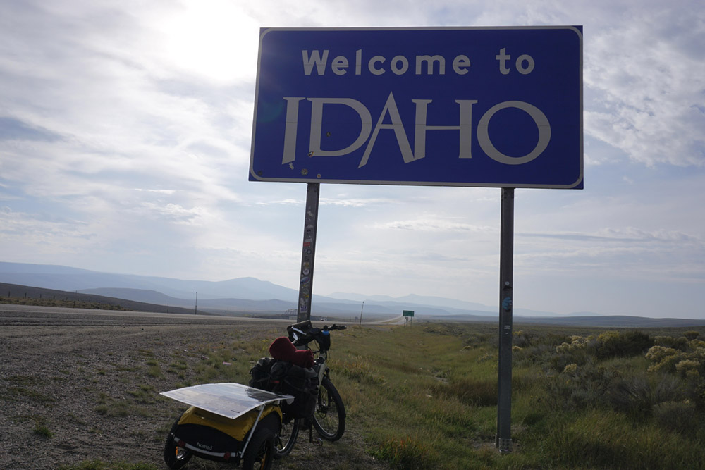

I did this last summer — a Sunpower 110W on the Nomad rack. I did not find additional support necessary. The POS rack did not fit the Nomad exactly — my biggest problem.

Seattle WA to Wash DC. Plenty of wind, no probs. Genasun, charging spare Bosch battery, no other option. Peak output in July -early Aug but dropped off dramatically in Sept. Biggest issues: crap tires on Nomad. Constant flatting. No theft attempts. Used motorcycle alarm, no locks.
