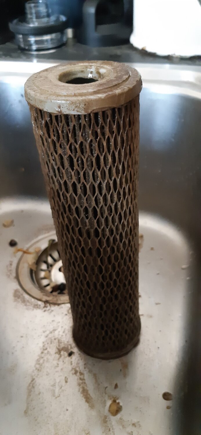

re your uv suggestion - it doesn't help reduce particles, so we still get premature wear on moving parts ( taps etc) . It also doesn't help with corrosion of the copper pipes - between the rotting bird sh1t and the times we've had ash from bush fires contaminate our water....lets just say a 90,000 liter battery isn't a good idea.
One filter from our drinking water tap
