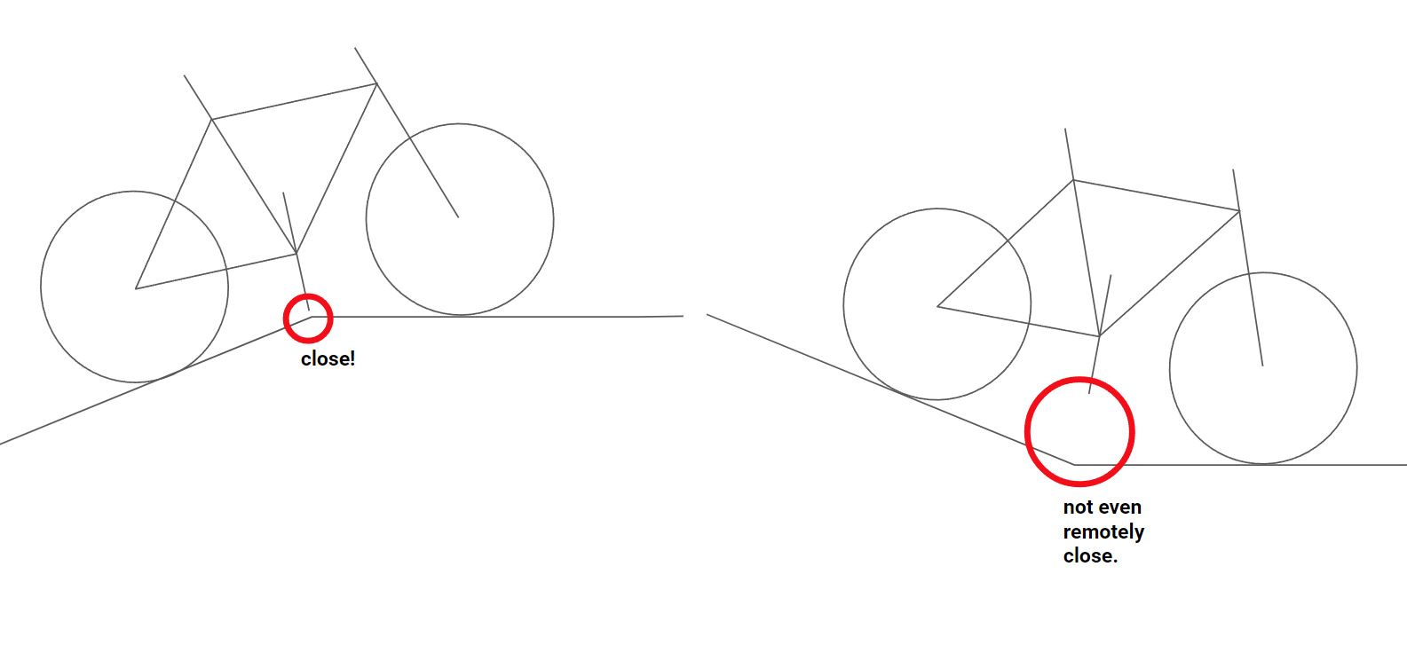

Secondarily, without creating a new thread, I ordered 160mm cranks and will see if that resolves my pedal strikes. As an example, I rolled out my driveway to leave the house today and the pedal struck the apron at the bottom of the driveway as I exited, which I found very odd. Not sure if I fully understand the "Q" factor and other changes that may or may not benefit or be a detriment with different cranks, but will try. Thoughts? Advice?
at the *bottom* of your driveway? it wouldn't be all that surprising to have a pedal strike if you had a pedal down at the top of a crest - with one wheel over the bend and the other below it, the ground in the middle (where the pedals are) is higher than flat. but the other way around makes no sense at all.

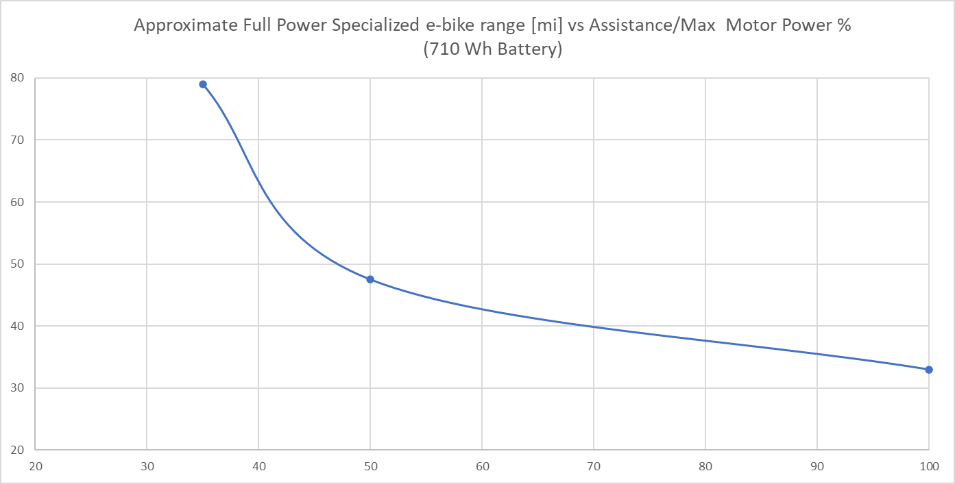

Guru, is your Como equipped with the 710 Wh battery? It is a plenty of juice, and I expect Smart Control would eventually keep you at very high assistance, leaving a lot of battery charge at the end of the ride. You would be disappointed with the SC performance again!
Just to explain the "Climb Response": SC makes use of the barometric altimeter to determine when you have started climbing. The CR value of 0 means "increase assistance as soon as a climb is detected". A higher value means "Increase assistance when a climb for a given value of elevation has been already detected". For a relatively short ride with low elevation gain, it is natural to keep the CR value at 0.
As I say, 22 miles and 450 ft is not very much as for the potential of the large battery Como. Let me give you some practical examples from my rides. Note: For practical reasons, I will use the battery consumption factor of Wh/km (Wh/mi). (Your 710 Wh battery has the usable charge of 675 Wh, or 95% of 710).
  • Assistance 35/35%: 5.3 Wh/km (8.5 Wh/mi). Your range: 79 miles.
  • Assistance 50/50% (the worst scenario): 8.8 Wh/km (14.2 Wh/mi). Your range: 47.5 miles.
  • Assistance: 100/100%: 12.60 Wh/km (20.3 Wh/mi). Your range: 33 miles.
The Max Motor Power % always set equal to the Assistance % . It is notable how much the Range can increase at Assistance/Power % less than 50%. It is due to lower travelling speed (less air drag). Note: The total elevation gain in the considerations has never exceeded 900 ft.
