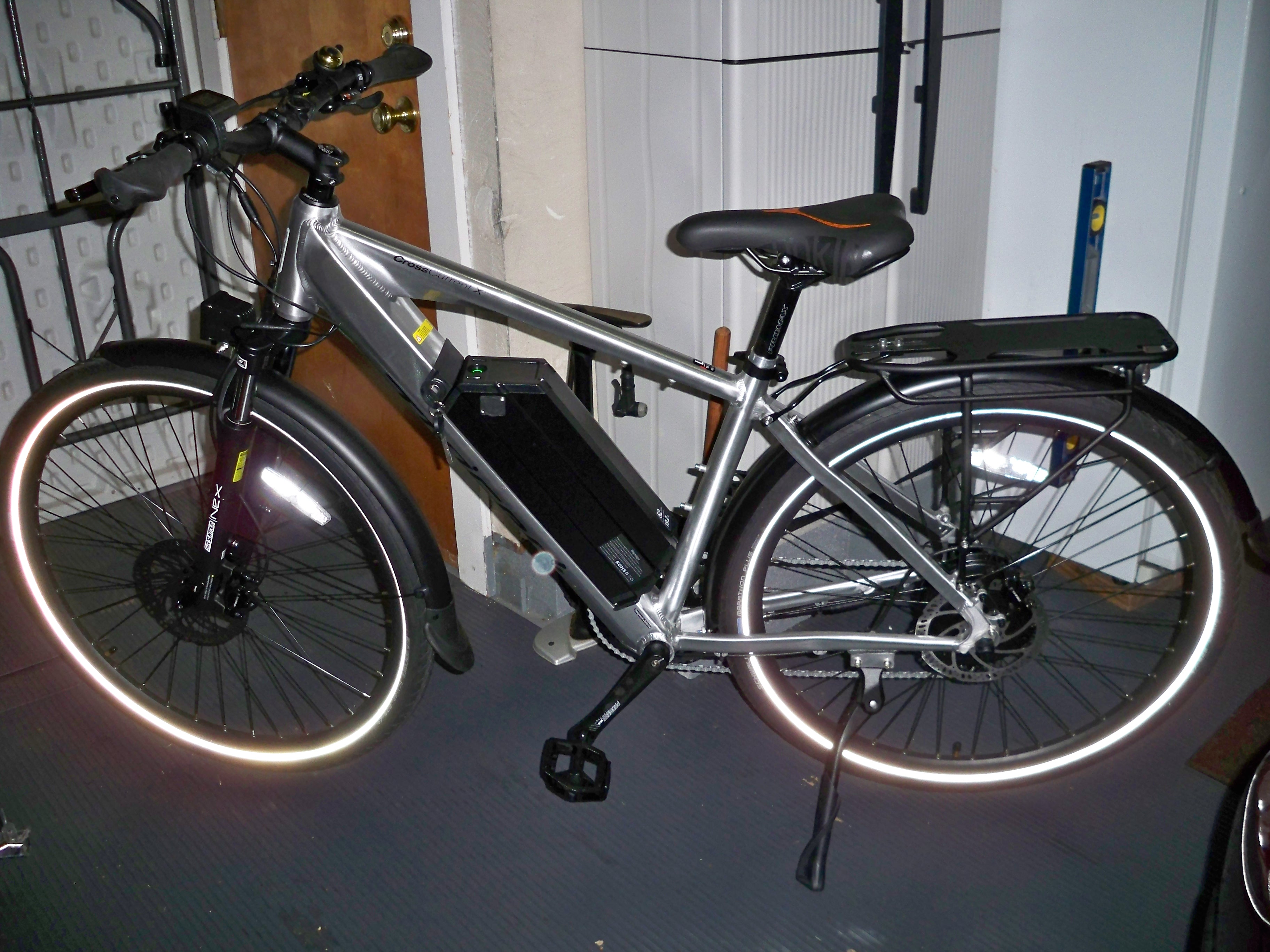

What made the brushed aluminum so likeable on the website was it had a tan/copper hue in it. Above picture is way different then the color shown on the website. Nothing taken from pic above but I would not have chosen a pure brushed aluminum as that bike is. Wonder why they're so different.
Yep, it's the lighting. Looks like flash was used on that particular picture and it's indoors. If you Google Juiced Brush Aluminum Cross Current and go to Images you'll get all kinds of pictures indoors, outdoors, night, day, etc. They all look very nice to me. They remind me of the old Titanium bikes put out years ago.
