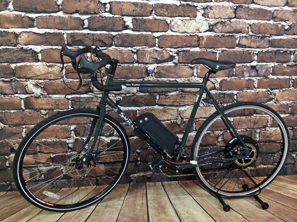

thanks for all the guidance, I've sucked it all in, completed my research and chosen a bike ( from http://longislandelectricbikes.com/ ). I have choosen a Trucker Disc with a Falco 500w motor. Very similar to the picture above.

I agree with many of the suggestions above. We love Surly bikes too! We actually did a Disc Trucker conversion with a 500W falco motor and it's one of the fastest bikes in the shop. I can hit 35mph on it and easily maintain a speed of 30mph. I added a pic below.
