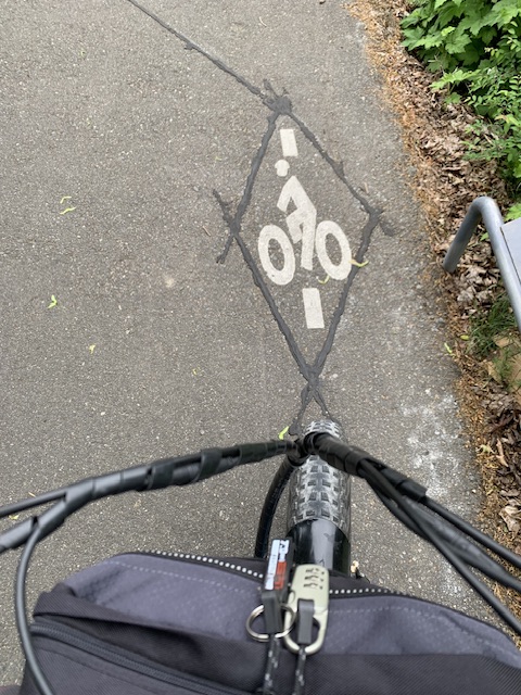

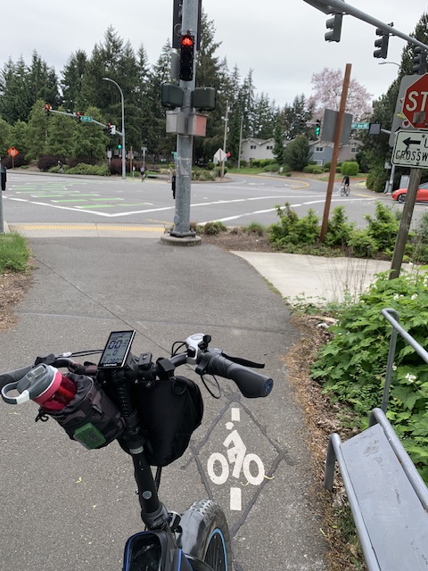

In my area (Seattle) I am seeing traffic lights specifically for bicycles. But until recently, I did not know how they activated. When I was stopped on a bike lane before an intersection, I saw an embedded diamond shape on the path. This is a sensor for us, like the large round shape that is embedded for cars. I moved my bike over the diamond & my traffic light went green. This particular intersection is on 148th Ave NE. near Microsoft campus in Redmond, WA.

BTW everywhere in the greater Seattle area you will see bikes (or sometimes just an "X") in traffic lanes where the sensor will pick up a bike.
we have a lot of them but they dont always work. one intersection I have to get o the sidewalk and push the button if no cars are waiting or if they turn.
Have yet to see these in bike paths in my area (coastal San Diego County), but I do deal with an automatic exit gate with an unmarked sensor under the pavement. Cars and many bikes have no problem triggering the gate, but not my ebike. Finally found a tiny spot that works if I go over it at walking speed, but it's very hard to hit.
Guessing the sensor's magnetic and my aluminum-framed hub-drive bike has too little ferrous metal close to the ground.
