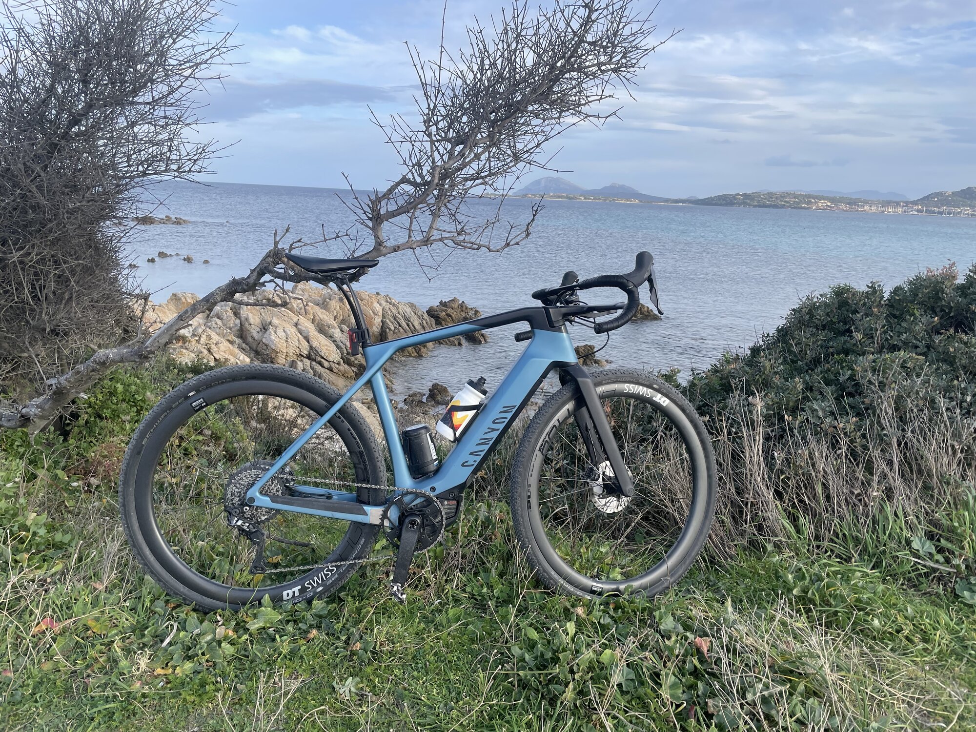

Here is my Grail. Thanks everyone for the kind advices
