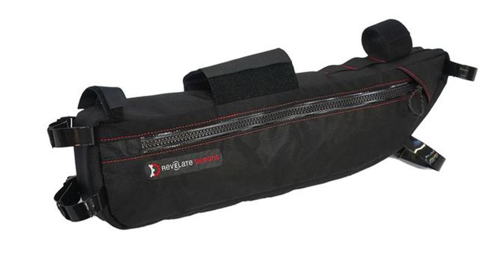

To carry the battery safe, secure and centered between the wheels, the Tangle top tube frame bag by Revelate (an Alaska maker of excellent bike bags). It fits the battery with the cover on it perfectly. The zipper closes easily but the battery is quite snug inside the bag. The bag is almost a perfect fit, hanging below the top tube.

I am in search of one more inexpensive add one to this setup - a soft fabric tube or sock in which to put the battery before it goes into the bag...this to protect the finish on the battery cover from chaffing or getting scuffed on any seams or grit that might inadvertently find its way into the bag and jostling around in there.
I'm contacting these guys tomorrow to see what they recommend.
I also was looking for a solution for second battery storage. I originally ordered a Salsa EXP medium size half frame bag, which fit perfectly in the large size Lefty 3. However, the zipper was slightly too short, and the second battery would not fit. I then ordered a Revelate Designs Ranger medium size full frame bag. It's a slightly tight fit in the triangle, but plenty of room is left to access the battery. The second battery fits easily into the Ranger frame bag.

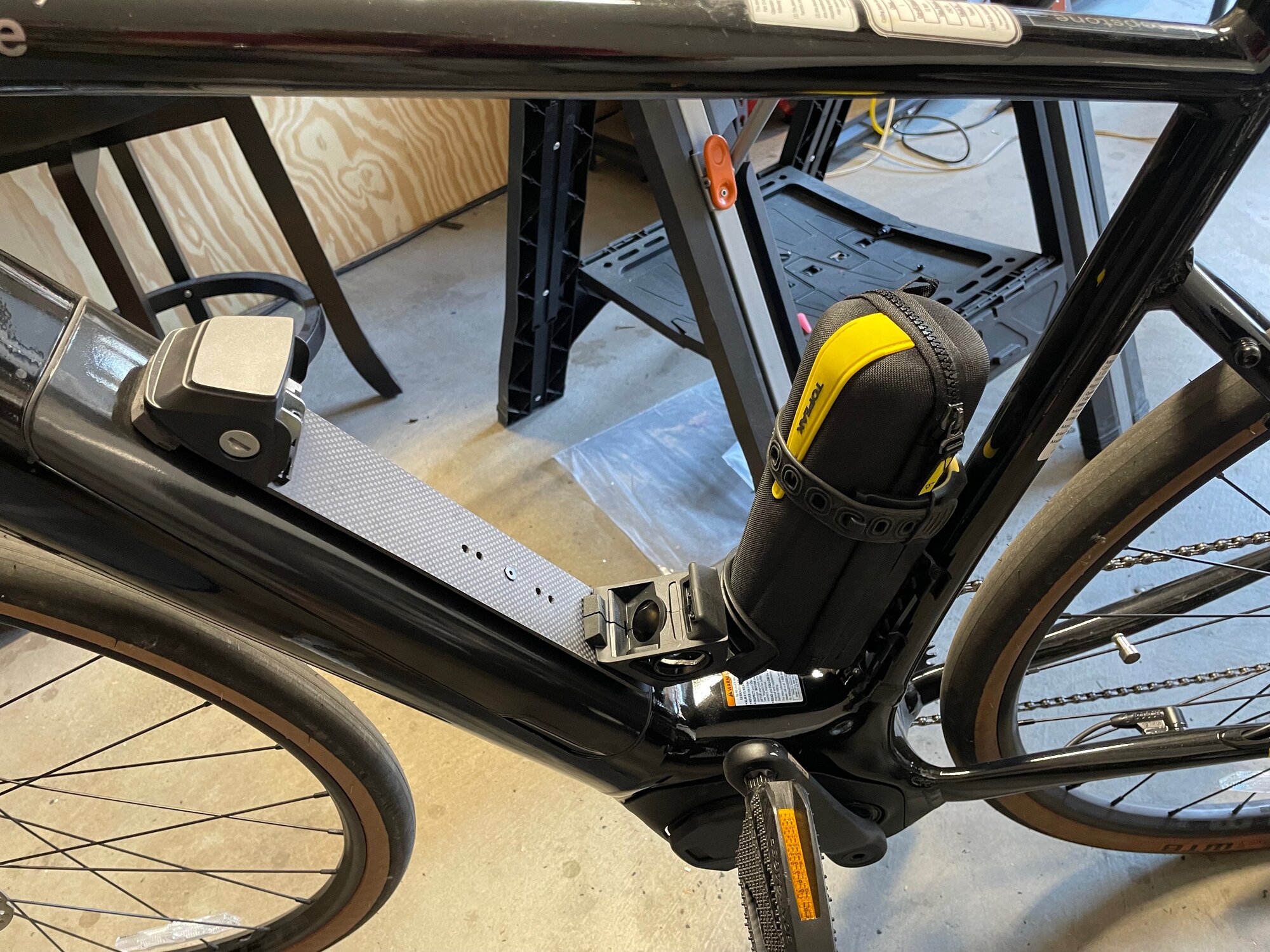

I just got my Capstone Neo 5 last month.
I came up with a different solution for extending the range... Using a Bosch 500 watt frame mount power pack battery.
I used a piece of 1/16" carbon fiber and cut a rectangular piece the size of a frame mount 500 watt Bosch PowerPack. I placed it on the protrusion in the lower middle of the battery cover. I drilled 5mm holes to match the five holes on the protrusion. At the top end, i.e.closer to the cross-bar, I drilled two 3 mm holes. I got two 3 mm bolts and ground the heads into a "T-shape". These slide into the grooves of the battery. I put 5/16" carbon fiber space at the top of the rectangular carbon fiber plate I had previously cut (roughly 13" x 3 1/2"). This plate nicely mounts onto the battery cover, held on by the protrusion screws, i.e.screws that otherwise might be used for a water bottle cage, and the top end by those T-screws.
I mounted the upper and lower brackets onto the carbon fiber plate. The description of parts you need are on: https://www.ebike24.com/blog/bosch-dualbattery-compatibility-installation
Bosch makes a Y-harness that connects two batteries, so wiring is relatively straightforward.
If I don't want to have a second battery, I put the water bottle cage on, and if I want the second battery, vice versa. See pictures... The yellow and black case in the second water bottle cage is tools, an extra tube, and a pump.
The Bosch system auto-recognizes the second battery and automatically uses and charges them together.
Hi John, this looks like a very interesting approach.
Have you had a chance to you use it much? Has it worked well? I'm curious as to how you arranged the wiring - how were you able to get the Y-adapter to work? If you are willing to provide more details, I'd be very appreciative.

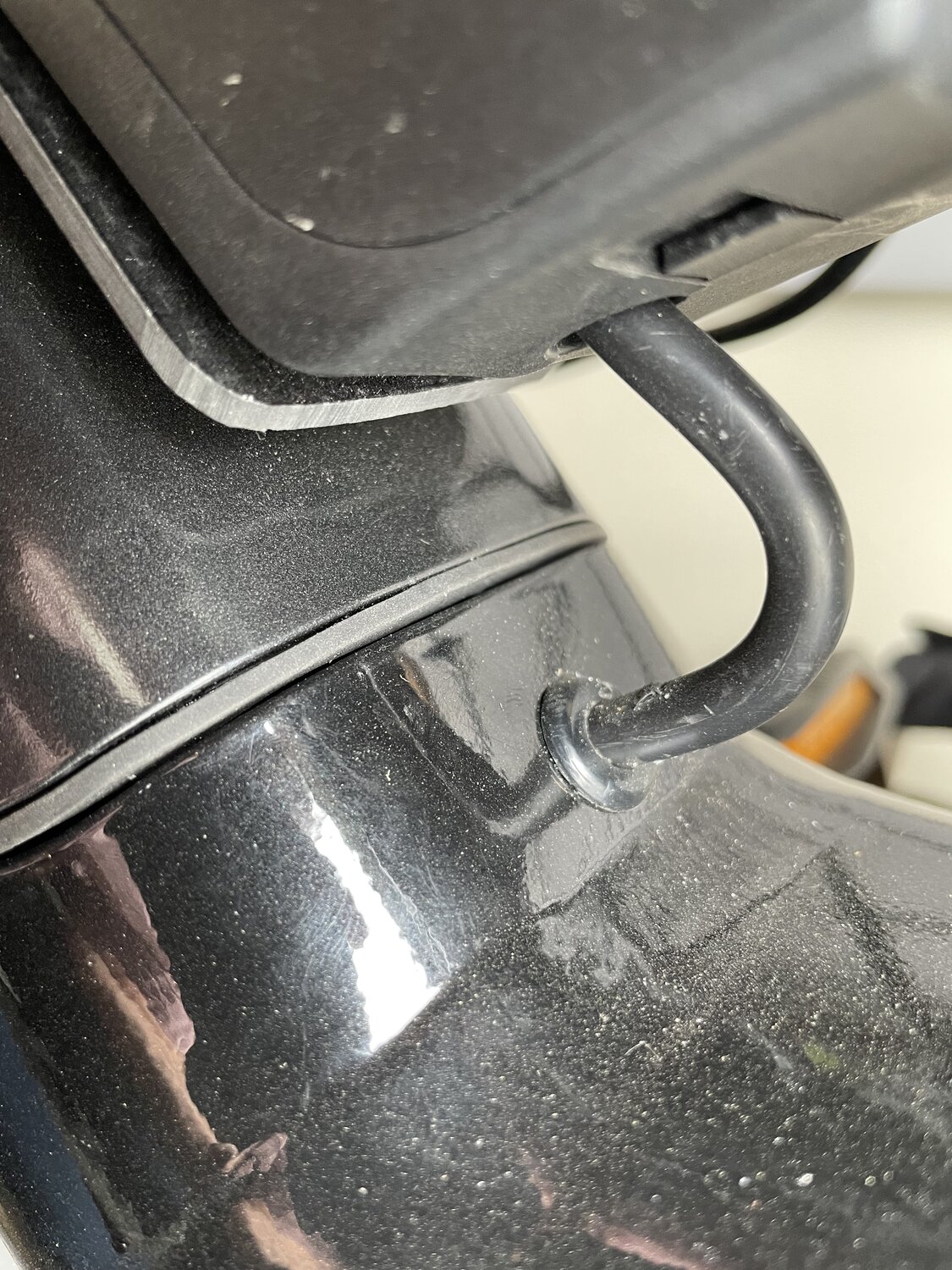

Hi,
Yes, I have been riding extensively with the two battery setup I described. When I connected the second battery, using the y-cable, the Bosch automatically incorporated the second battery into using it while discharging and while charging. The estimated range > 200km, all works fine.
Quite a pleasure having, for me, a virtually unlimited range at whatever power I choose. The batteries last long than my butt…
I drilled a small hole on the frame, just at the bottom of the new battery and ran the wire through (a grommet) the hole. To connect to the motor, I did remove the motor bolts (six of them) to drop the motor down about an inch. This allowed easy running of the y-cable and replugging the original frame battery to the y-cable. The other branch of the y-cable to the new battery left too much excess wire and plugs. So I cut that arm of the y-cable and the cable from the new battery, and soldered/heat shrinked to a better length. Here is the picture of wire into frame…

Hi,
Very nice - thanks for the added detail.
You have impressive fabrication skills!
