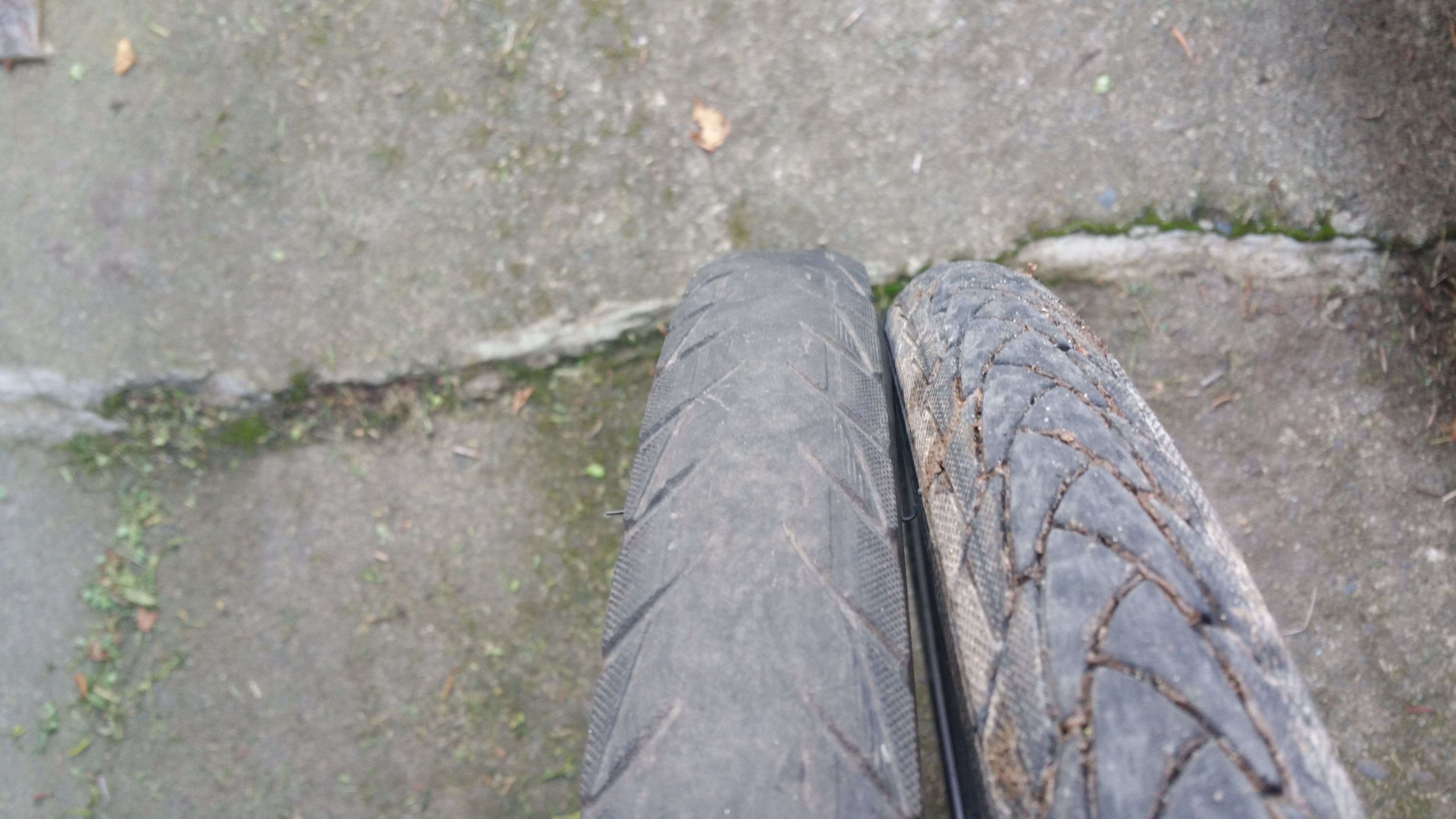

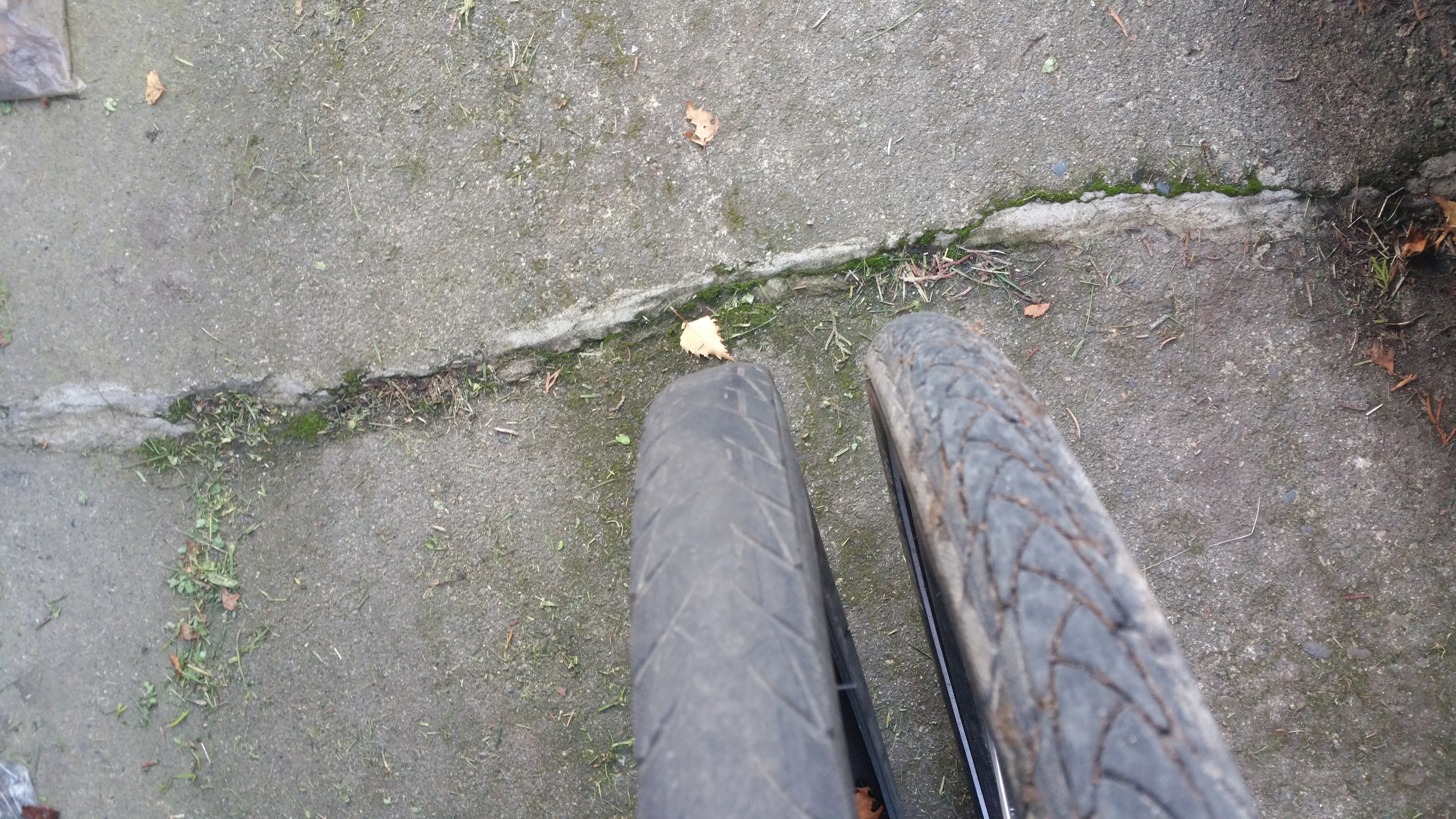

So I "upgraded" to Schwalbe Marathon Plus because that's what Juiced's new CCX have and so I was like ok it must be better.
Right off the bat the braking performance was a lot worse and my braking distance was increased dramatically.
Especially in the rain, if I lock the rear brake I feel like it will keep sliding forever and if I grab the front brake a little hard, I can lock the front brake quite easily, and you know how dangerous that is.
Even on dry condition, yes the overall brake performance is worse.
Just to let you know, I commute on daily basis, same road, same kind of condition, and I am VERY FAIMILAR with my bike with Kenda tires, so not, it's not placebo.
Anyways, I thought I would give Schwalbe a couple weeks because I thought it might needed to break in. (I remember from my motorcycle that brand new tires are very slipperly and had to be broken in)
So fast forward 3 weeks or so, the performance was not up to the Kenda tires that I used to have.
I was like what the heck is wrong and decided to compare my old tires (I haven't disposed yet) and noticed that tire structures are completely different.
The Schwalbe has oval shape and Kenda has flatter shape.
Yes, I realize that Kenda tires are "squared off" due to everyday use, but despite that, original design of Kenda had more flatter shape than Schwalbe.
Also Kenda seems a little wider, even though they're both same size at 700c-45c
Needless to say, this will result in the different contact patch.
Don't get me wrong, I know Schwalbe is a better tire in terms build quality, it was a lot heavier than Kenda and had this "heavy duty" feel to it.
I'm guessing the this shape will give a lot lower rolling resistance too.
But maybe the less rolling resistance = worse braking performance?
Anyways, I don't know if it's just me but I imagine there are other Juiced owners who switched from Kenda to Schwalbe, and I'm just wondering if you guys noticed the same thing.

Perhaps you may have contaminated your rotors and/or pads when you swapped tires? Even oils from your hands on rotors are enough to cause poor brake performance. Try cleaning with isopropyl alcohol and/or light sanding.
Changing tires shouldn't have much effect on braking performance absent new tires losing traction (ie skidding)
The Schwalbe feels like it has a harder compound than the stock Kendas. Just like in auto racing, softer tires = better grip. I suppose it comes down to whether you
1) believe the Schwalbes actually provide more puncture protection
2) are willing to trade handling performance for that protection
I have a Marathon Plus on my rear tire, and yes, it's more slippery in the rain.
Schwalbe makes great products. Very occasionally there may be a QC problem but overall I have had excellent experience.
Marathon Plus is a quintessential touring and long distance tire. They are built for maximum protection but they are not made for wet conditions. In fact, they give wet surface performance metric for each tire (along with protection, road grip, durability etc).
Almotions, GT 365 and Energizer plus have slightly different compound that are made for road grip (hence braking). If a man chooses German Shephard dog and expect it to behave like a small beagle puppy, should we blame the dog? :)
It would be wise to pick the tires suited for each one's needs.
