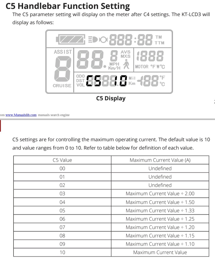

Try turning the power down on your new controller.
Your old controller was 12 amps, and your motor has a maximum power rating of 12.5 amps, but your new controller puts out 15 amps.
A C5 value of 06 will bring your maximum current down to 12 amps.
