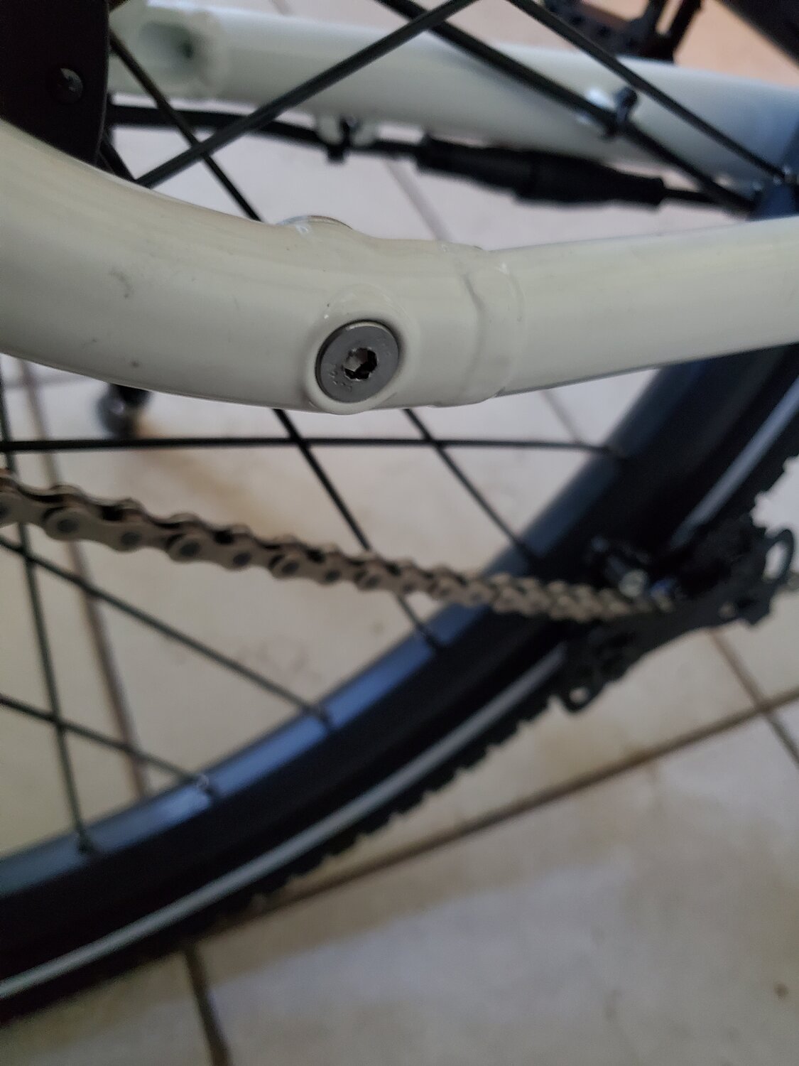

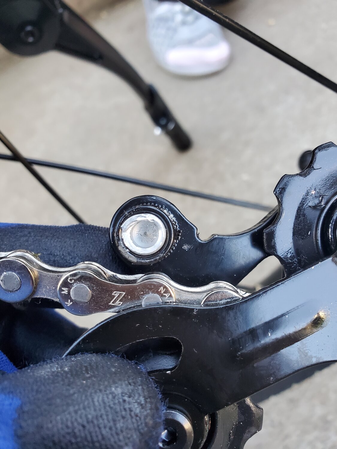

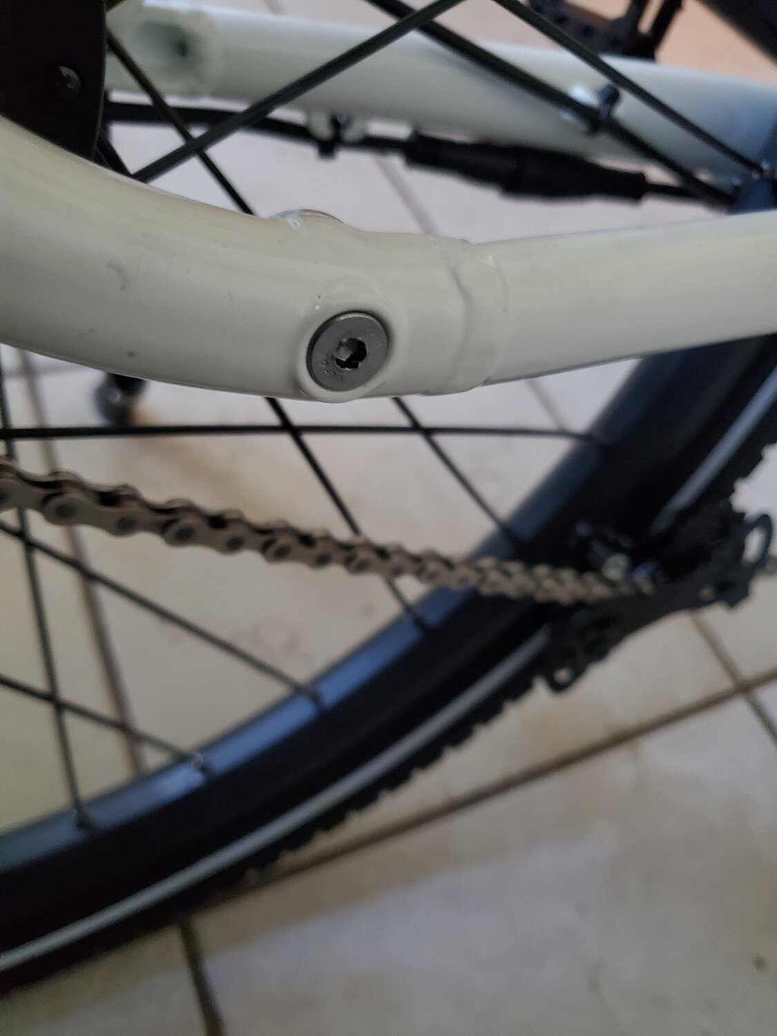

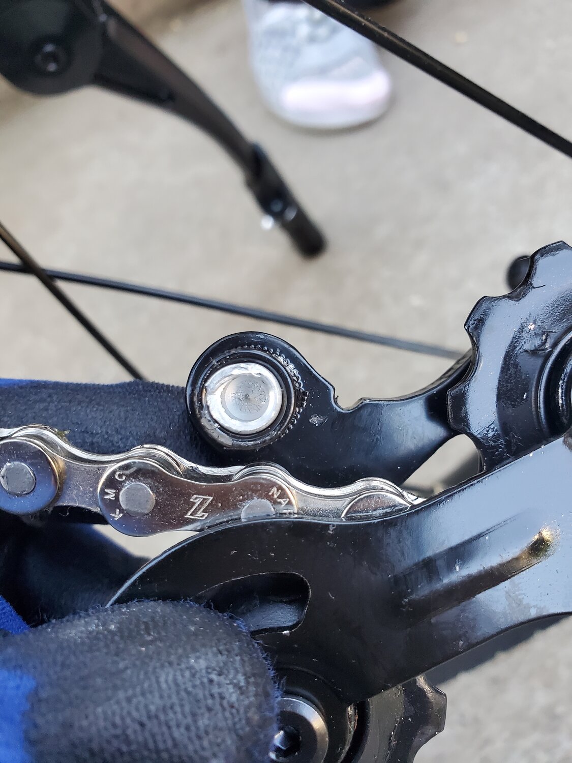

Just want to chime in that I have also had trouble with the chain tensioner. The original failed and was replaced. A month later and 173 miles later, and the replacement has failed in the same way as the original. Working with Rad on a 2nd replacement, but I'll also see if the local bike shop has any ideas for a quality replacement.
If you have this problem you'll know because the chain tensioner hitting the spokes is loud (and not good for the spokes long term)
The failure I experienced is a bolt breaking off / failling out same as the original poster.

Got my Radmission yesterday and my chain tensioner broke on my first ride. Not sure if it got caught in the spoke or what but I'm so disappointed right now. I was pedaling and I heard some grinding noise and then saw the chain tensioner just hanging there on the chain. The bolt that secures the chain tensioner to the frame broke in half and now it is stuck in the frameView attachment 89952 View attachment 89953
Edit: Contacted support through email and they are sending me a replacement chain tensioner. I was surprised how fast they responded as all the things you read online suggest it takes them some time to respond. Will keep you all updated once the new part is installed.
Update: I ended up finding a local mechanic that was able to repair and improve the old chain tensioner with a sturdier steel bolt instead of the weak aluminum bolt. Rides good now. The replacement chain tensioner is on the way but I don't need it anymore.
