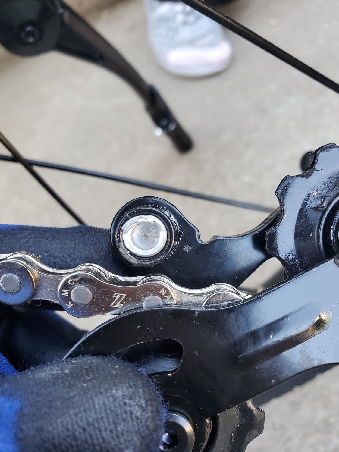

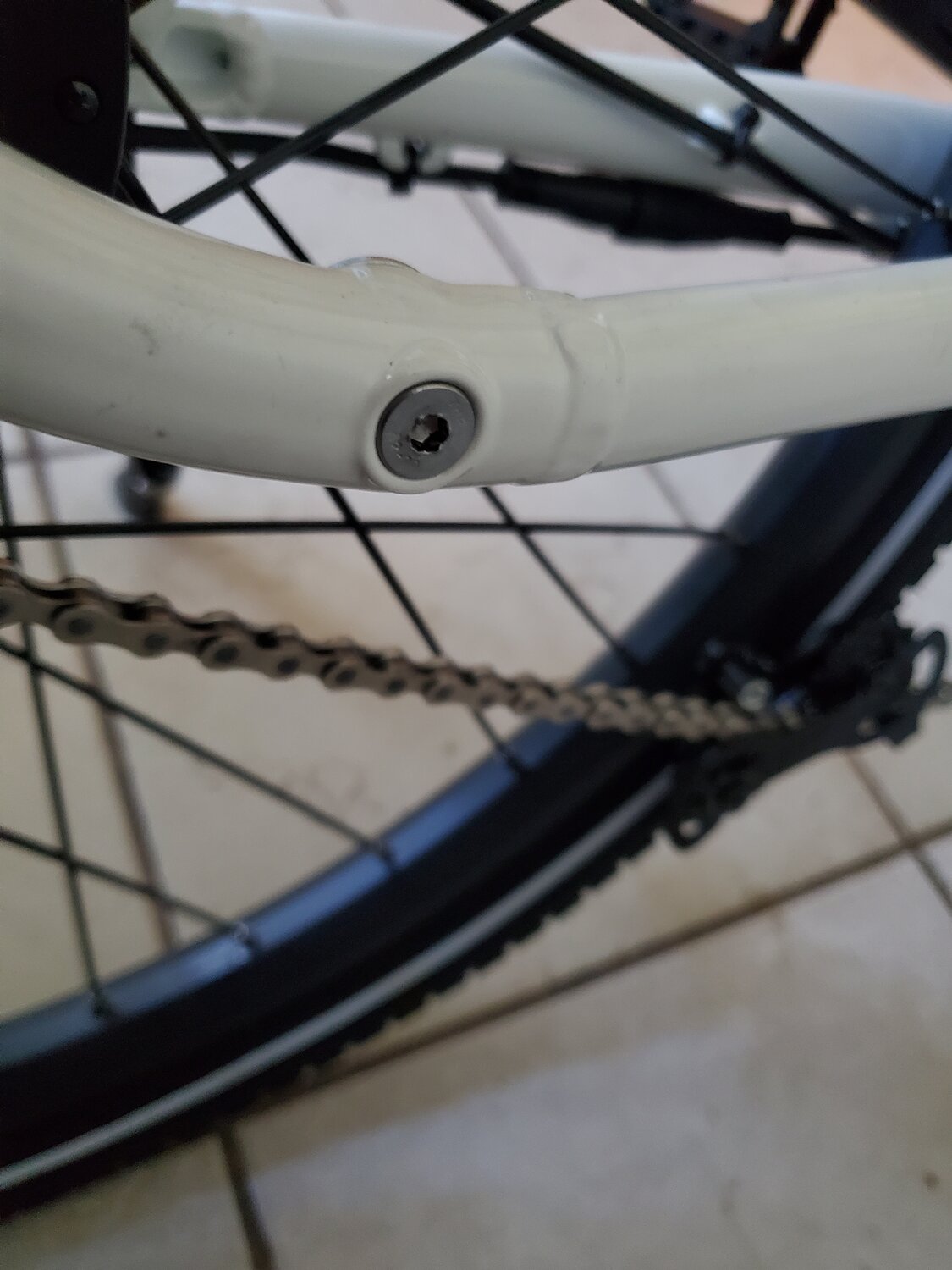

In a very short time, the Chain Tensioner Pulley Cage ended up rubbing against the spokes. I first thought it was poor design and replaced the button-head screw with a countersunk one to increase the clearance. Yesterday the Tensioner COMPLETELY FAILED and drifted over hard into the spokes. Upon close inspection, the only thing retaining the pulley cage on it's pivot mount, away from the wheel, is a small soft aluminum roll-pin, which wears down and/or shears off after minimal use.
The RAD website already shows a How-To for replacement of the tensioner, which leads me to believe that they are aware of the problem, but are treating it on a case by case basis.
Based on the possibility that such a failure could lock up the rear wheel ejecting the rider and causing injury , I would feel RAD should, at minimum, potentially contact ALL Mission owners advising of the potential risk and provide an inspection protocol.

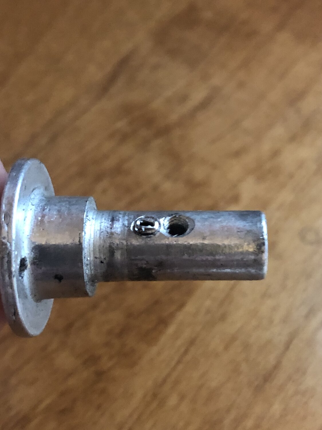

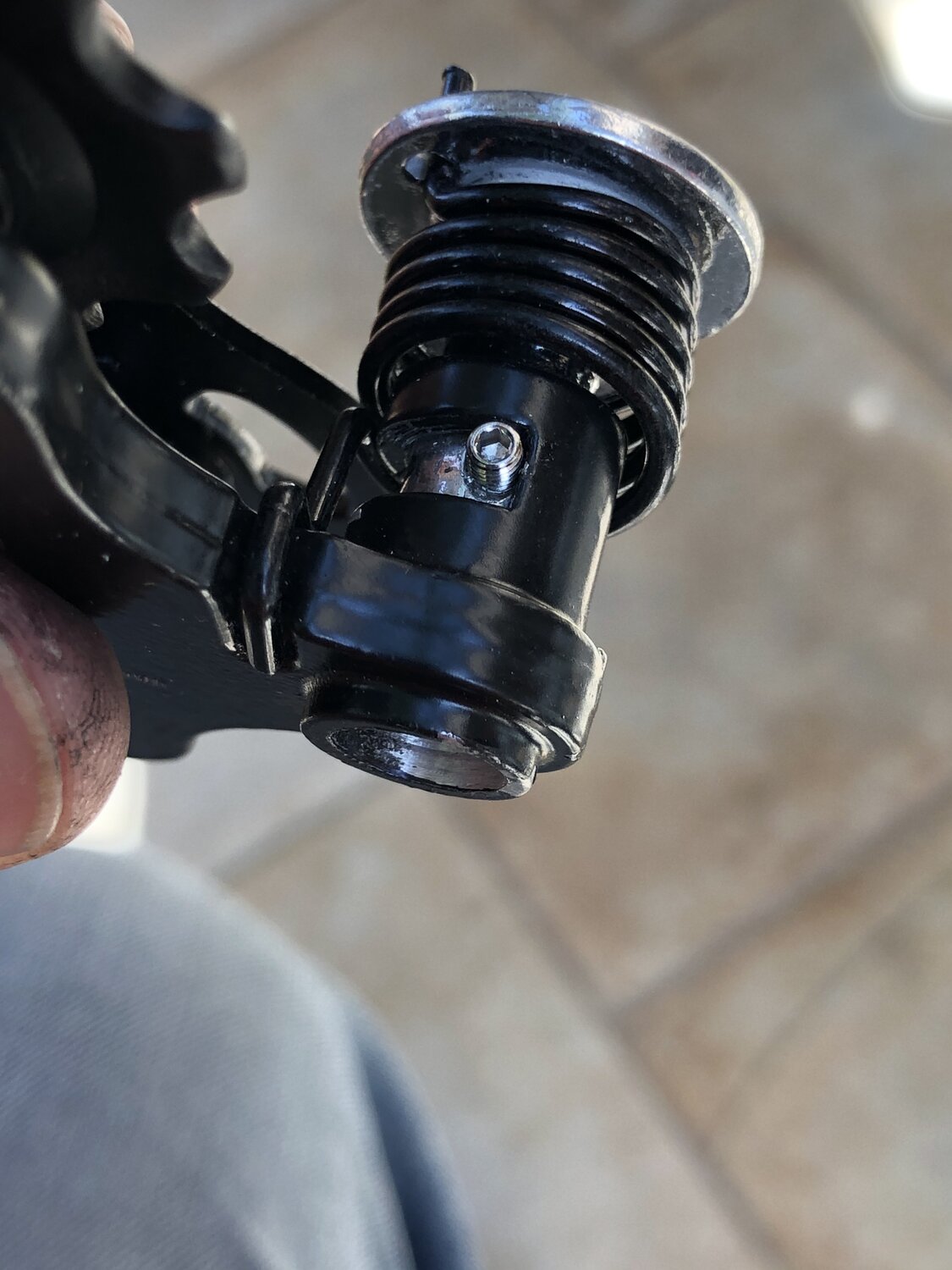

Finally received/installed the replacement tensioner from RAD. While the bike is good-to-go, there are more questions than answers about how this came to be and WTF is going on at RAD and the QC at it's suppliers.
First photo shows the new one with a nice new stainless hex set screw, hopefully loctite-secured. The second photo shows the shaft of the OEM tensioner, now disassembled with what I thought was a roll-pin either sheared or cut off, and an empty threaded hole, that may or may not at one point have contained a set screw like my new one. Did this occur during original manufacture? Did it occur during final assembly? Was there a set screw in the fresh hole at one point that fell out because of no loctite? I don't have a microscope handy, but there is no evidence of loctite that I can see. Why two holes in the first place? QC in the asian market sometimes requires close supervision and strict guidelines. I suspect this happened at the lowest level in production where someone maybe missed and decided F-it just snip it off and drill/tap a second hole. I can't come up with any other explanation, and I don't get the feeling RAD cares other than to send me a new one and move on.

Thank you. Do you know (or have reason to believe) if the new one has a second hole) alongside the one in which that hex-head is now secured? Do you suspect that your first flawed tensioner originally had a hex-head set screw in one of the two (?) holes and that it quickly popped out? And that there were *two* holes because the "first" one was unsuitable and so the assembly-person just added a second hole alongside it and popped-in (not very well) the standard set-screw?
Thanks! (I'm just trying to get this clear in my head.) If the new one has only the one hole, the scenario just described (asked-about) would all make sense, right?
As far as I can tell, the new one only has the one hole. And, with the mindset of "if it works don't F-with it", I'm not game for further disassembly to find out absolutely.

Got my Radmission yesterday and my chain tensioner broke on my first ride. Not sure if it got caught in the spoke or what but I'm so disappointed right now. I was pedaling and I heard some grinding noise and then saw the chain tensioner just hanging there on the chain. The bolt that secures the chain tensioner to the frame broke in half and now it is stuck in the frame20210608_180329.jpg 20210608_181337.jpg
Edit: Contacted support through email and they are sending me a replacement chain tensioner. I was surprised how fast they responded as all the things you read online suggest it takes them some time to respond. Will keep you all updated once the new part is installed.
Update: I ended up finding a local mechanic that was able to repair and improve the old chain tensioner with a sturdier steel bolt instead of the weak aluminum bolt. Rides good now. The replacement chain tensioner is on the way but I don't need it anymore.
