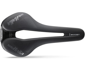

Hello fellow cyclists,
I'm reaching out to this knowledgeable community for some advice regarding an issue I've started to notice and its potential long-term effects. I'm 59 years old and enjoy riding my e-bike daily, covering around 12Km. Despite using a saddle designed to be safer for the perineum, with an empty center area to reduce pressure, I've been experiencing some numbness during and after my rides. (I do use a Selle Italia FLITE BOOST TM SUPERFLOW)
Given my age, I'm also facing natural changes in my sexual function. While I still maintain an active sex life with my wife, achieving and maintaining an erection has become more challenging, often requiring more libido and manual stimulation. We manage to be intimate once or twice a week, but it's important for me to ensure that my cycling doesn't exacerbate these issues!!

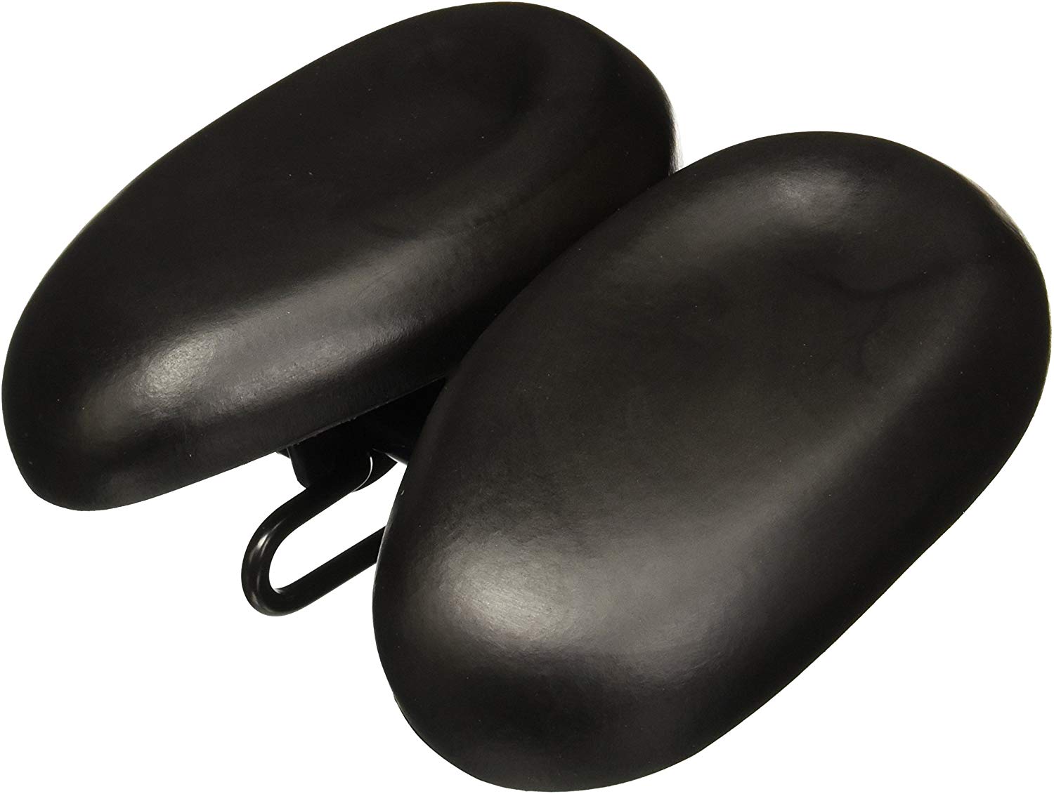

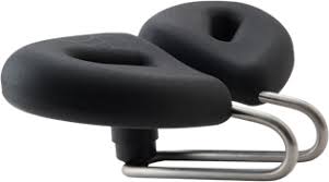

I've heard about noseless saddles as a potential solution (spongy wonder, all wings saddle) to reduce pressure and prevent numbness. I'm curious if anyone here has made the switch and can share their experiences. How effective are they in alleviating pressure and potential risks to sexual health? Are there specific models you'd recommend for someone in my situation?
Any advice on adjustments, saddle types, or other measures to mitigate these concerns would be greatly appreciated. My goal is to continue enjoying my daily rides without compromising my health or sexual well-being.
Thank you in advance for your insights and suggestions.
I switched to a noseless saddle in my early 40's due to numbness. Doctor said to do it or give up cycling.
I've tried a couple of dozen styles, including the cutout designs. I hesitate to recommend a specific saddle since there are so many to choose from and every butt is different.
FWIW, personally, I found the Spiderflex to be the most comfortable:
The Hobson Easyseat was a close second but lacks the shock absorber of the Spiderflex.
The results are amazing! No more numbness! There is a learning curve associated with a noseless saddle though. It's like sitting on a barstool rather than straddling a split rail fence. Unfortunately, you give up most of the ability to control the bike with your hips, which makes riding no hands quite difficult.
Many bike shops will let you try a saddle before buying. Another trick is to order online, try it and return if it doesn't work out.
Keep in mind, every rider is different and what works for some, may not for all.
Good luck!

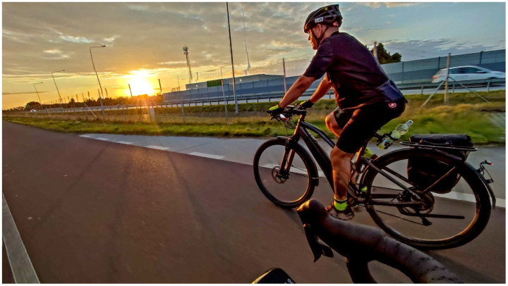

There is no perfect saddle. It is a wrong riding position. You say "12 km", and I say "208 km and no numbness in the private parts, no pain in the ass". How come? If you are riding in an upright position, almost the whole body weight of yours rests on the saddle. If you wear padded shorts or bibs in that position, your private parts will be squeezed even more. If you try a big, wide and soft "comfortable saddle" it would be even worse (sit on a sofa and try pedalling...)
The major change in my own cycling occured when I watched my gravel cycling ultramarathon buddies. They ride narrow and firm saddles (the cut for the perineal area is OK) but they lean forward as they are riding. This way, the big part of their body weight rests on the pedals and the bars. I did a similar thing:
  • Changed the stems on my both e-bikes to longer ones. Lowered (slammed) them. Flipped them for even more forward riding position. I stopped and increased the stem height a little when I felt I had overdone the thing.
  • Installed Innerbarends on my handlebars to "ride in the hoods".
  • Narrow and firm "sporty" saddles.
  • Carefully tuned the position of the saddle: on the horizontal and with the tilt (my favourite tilt is 0 deg, or purely horizontal saddle)
  • Wear chamois on long rides only.
  • Wear gloves for the hand comfort.
Outcome:
  • No numbness in the private parts
  • No pain in the ass
  • No pain in the lumbar
  • No pain in the back
  • No pain in the neck.
  • No numb hands.
I said: "208 km on a single day, 263 km over two days and no pain".
My riding position on a road cycling group workout. When riding against the headwind, I bend my arms in the elbows to lower my body even more.
My riding position at the finish of the 263 km race. (Another e-bike).
