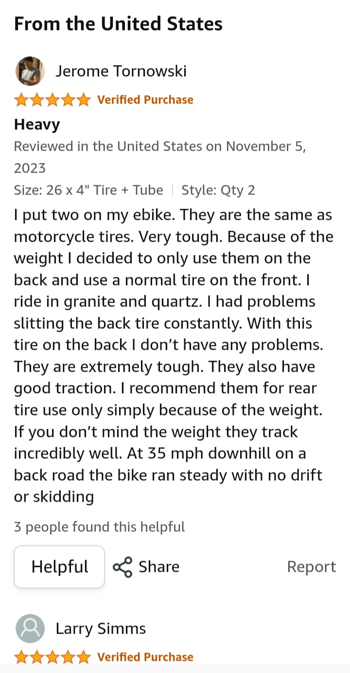

At first I thought that you were getting too much for your money with those tires, but then I found this,..
It looks like it's an old-school type tire like what we had as kids.
It weighs a ton but it's tough as nails.
It's old-school rubber that doesn't wear as well, but it's an inch thick to make up for it. 😂
I'd maybe just put one on the back like he did.
You'd use up more battery spinning those tires too.
