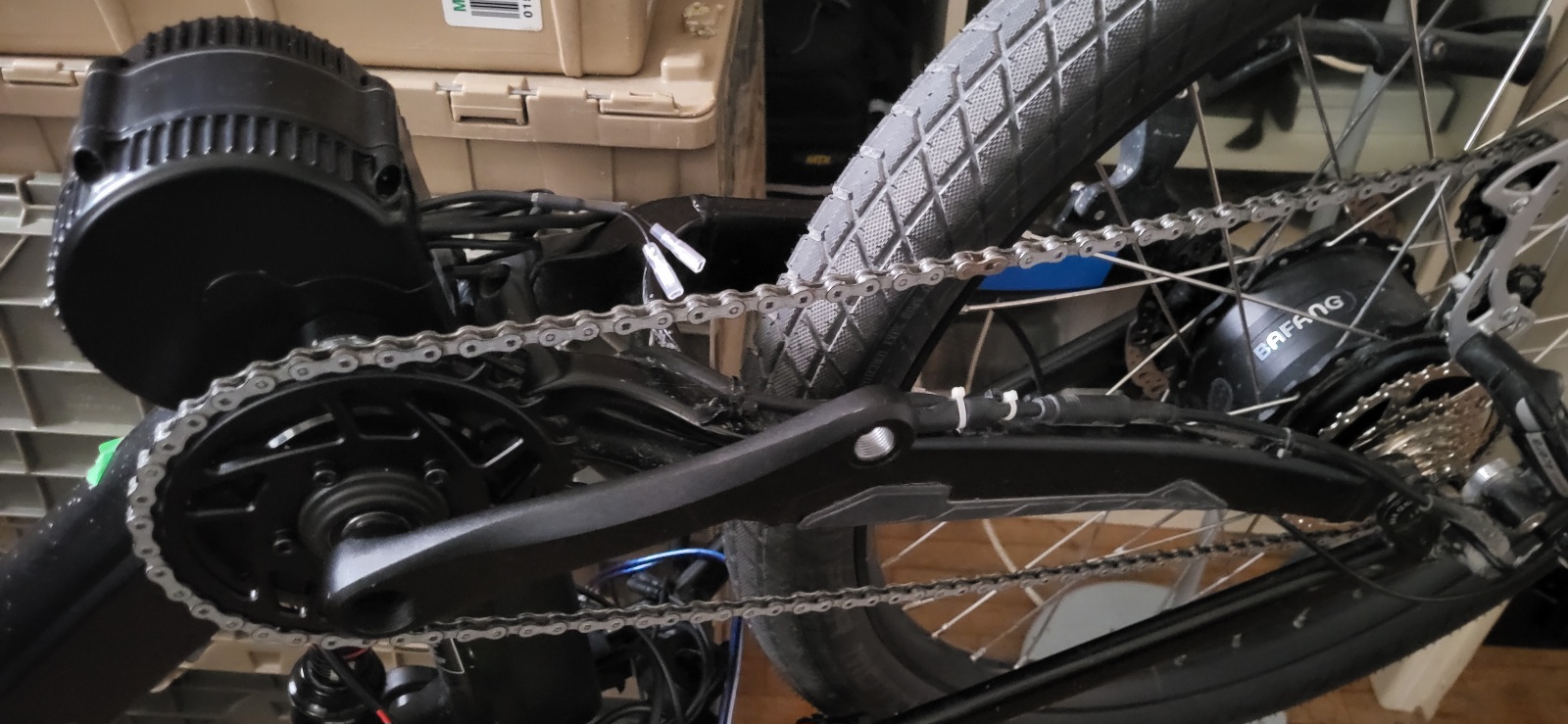

All this Rohloff talk, now I want one.
I could put my hub drive on the front with the Rohloff on the back connected to my BBS02B?🤔
Sounds like a new project for me. 😁
