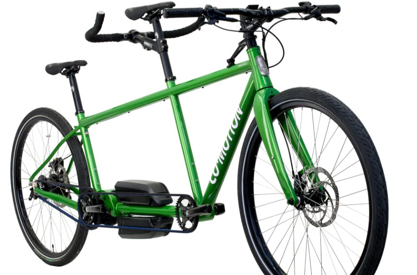

I just acquired a new Co-motion Metolius tandem with a Bosch / Rohloff E-14 drive train.
This is my second Co-motion tandem and like the first one, the build quality is superb. The bike handles well and is a joy to ride, except . .
The drive train is rather disappointing. The Rohloff E-14 hub too often grinds into gears rather than shifting smoothly. It sounds like the gears aren’t meshing properly. Interestingly, the problem seems worse in the tour mode (2nd level assist). Occasionally it reminds of a derailleur that is out of adjustment. The other day I was leaving a stop sign and it seemed to slip for a moment before it engaged. Again, like a derailleur that had been shifted while stopped. I have it set to shift into 9th gear at a stop and had been riding in 11 – 12th gears. I should also note that we are not pushing hard during the shifts and try to initiate shifts at the bottom of the pedal stroke.
I’ve really tried everything I can think of to correct this. The belt tension is correct, the quick release skewer is not too tight and I’ve recalibrated the hub several times. All to no avail. The one thing that I think may be an issue, is the fact that I can’t feel any change in the motor output while shifting. I know this is very brief (186 ms???) but I seem to recall it being obvious on another similar system I rode a couple years ago. The one other thing that may be a hint to someone more knowledgeable than I, is the output of the Rohloff E-14 diagnostic app reported 23 failed shifts after about 250 miles of mostly flat pavement. Not sure if this is something to be concerned about, or to be expected.
Any ideas would be much appreciated!

So the motor is on the rear crank? Which rider does the shifting, front or rear? Does letting off the pedals momentarily apply to both riders? Have you experienced your issues riding solo or with a partner?
OEM -motor at rear cranks, shifter up front.
