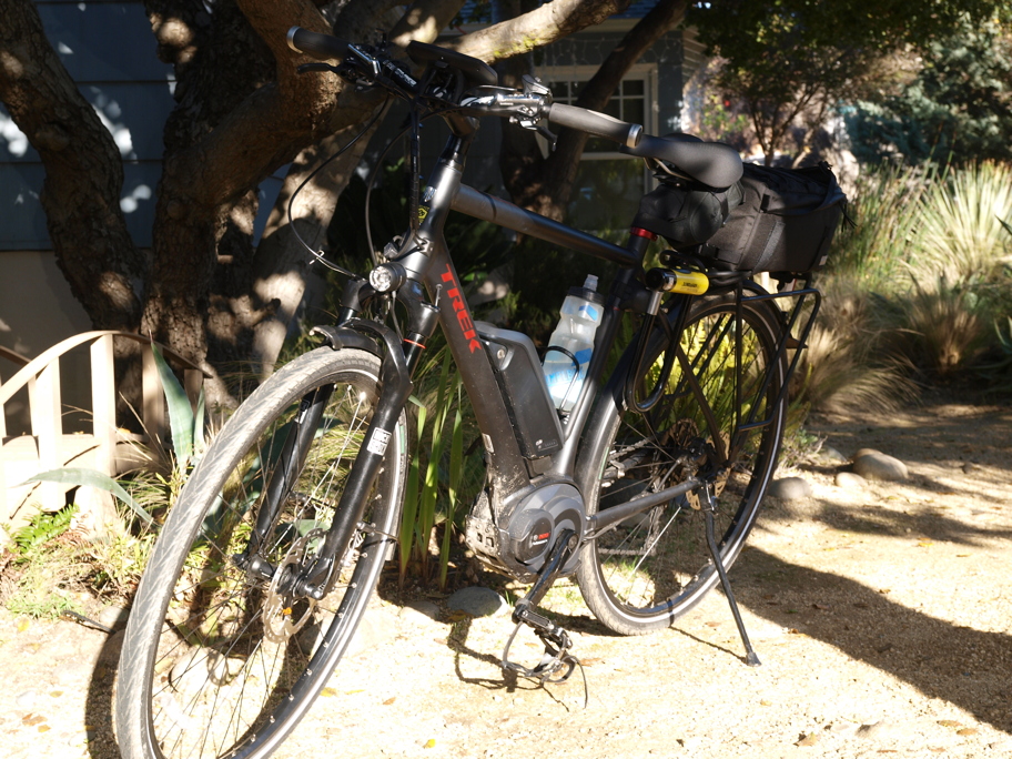

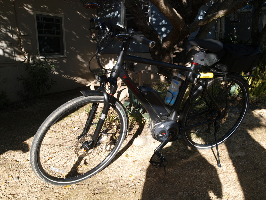

I replace the front end on my Trek XM700 with this same fork. Works great, looks sharp!
jeff
That's a nice upgrade. By chance any pics of the bike with the Rock Shox? I didn't like the stock suspension much when I test rode the XM700+ although I didn't have a chance to find out if it was adjustable. IMO, a suspension upgrade promotes the XM700+ from a really good bike to a great one.
Here are a few pictures of my bike.
Opps, wrong bike. Let me try that again.
jeff
