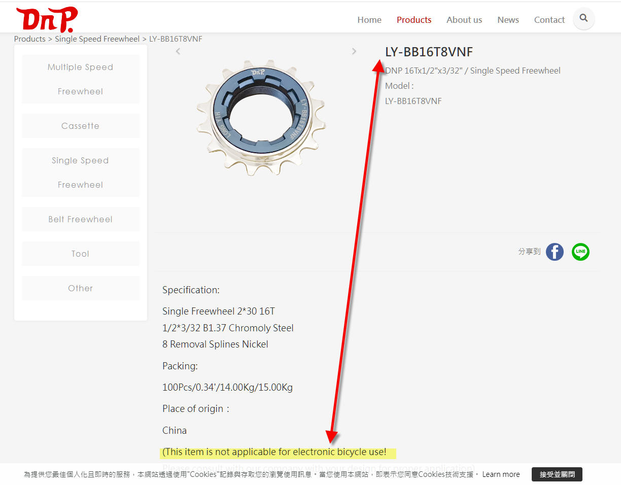

Hello Scooter,
After a little less than one year of daily driving (40 minutes per day) in warm dry southern California, our factory installed single speed freewheel also needs replacing. When we google search the part number, the manufacture says that this part is not even for ebikes.
My question for you is how is your ACS freewheel, 16 tooth, from Planet BMX holding up?

I spoke to the new owner of the 'Runner recently. She reported no issues at all, just have no idea of how many miles she put on it because it has the original LED display screen on it. FYI, the Dicta 3/32" is a good replacement as well.
The reason it's not recommended for ebikes is because the manufacturer assumes you have a high-powered mid-drive. On a hub drive ebike it doesn't matter.
