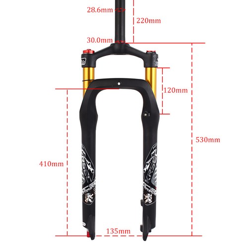

Somebody sent me a direct message they also have the Ripcurrent S and he changed his fork to a Bolton ebikes fork. It will fit on my bike and it has good reviews and people have been swapping out their rad bikes forks with this one. I think this is the best route for me to go otherwise if I go with rockshox and what not I will be spending more on this upgrade than what the entire bike is worth. This may not be top of the line but if it's even a little better for the cost it's fine with me and way less hassle. I already ordered it and will have my local bike shop put it on.

It's going to be a few weeks or so until it arrives. It was out of stock and on pre order and so it was on a special price as well $169 flat with free shipping and no tax reg price is $199. They said they are expecting the shipment to arrive mid Dec and that they will have them shipped out within 24 hrs. So it's going to be a while until my update but I definitely will.
The person that told me about it said he's had it on for about a year with no problems. He also mentioned the following: "For the same money the bolton fork feel and responds a lot better on the road and in the trails. I am a recreational rider putting 1500 or more miles a year on each bike." Also the reviews on the product page are all good by the rad owners except for a couple that left a bad review because they couldn't install it.
I was out of town but back now and received my bolton fork my Ripcurrent is in the shop now getting it installed. Should be ready by end of this week and I will update with my review. So far by looking at it, feels solid and built well. Let's see in practice when I'm riding around if it actually works and absorbs impact unlike my stock fork which doesn't do crap. Even if it's a little bit better for $169 can't really beat it. Looks really nice too all black and red trim/knob, matches the Ripcurrent well. Will take pics once I get the bike back.
I just received my 100mm fork from Amazon. I started to replace the fork but needed a Headset kit. The original lower bearing crown race cannot be easily removed and swapped over. You will need a new one. Does anyone know what Neco or equivalent headset kit is needed? The RCS fork tube I have is 185mm long and the replacement is 220mm long. You will have to add spacers or cut the tube to the 185mm length.

I just received my 100mm fork from Amazon. I started to replace the fork but needed a Headset kit. The original lower bearing race cannot be removed and swapped over. You will need a new one. Does anyone know what Neco or equivalent headset kit is needed? The RCS fork tube I have is 185mm long and the replacement is 220mm long. You will have to add spacers or cut the tube to the 185mm length.

I could not see if they cut the shock tube down or shimmed it up. Did they reuse the stock headset? I have my new headset with sealed bearings and will have to do the install when I get back home. I have my shock pressure set to 100 psi and get good compression when trail riding. Yesterday was a 7 mile torture ride on the RCS at a local bike park. The most beating the bike takes is when going uphill over roots. Pedaling and level 1 gets me up just about any hill. Tire pressure is 15psi. I am interested in seeing what the 100mm shocks offer over the stock 80mm on the trails.
