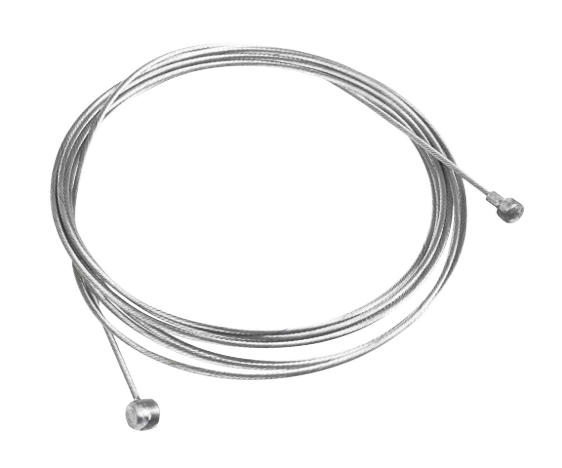

I had the same problem.
The cables that operate the enviolo hub had become frayed inside of the cable tube. Eventually it snapped and i could only work the hub in one direction on the way home.
This was the solution:
proxy-image
Nah. They just take standard shift cables, but the stock ones are kind of low-quality. Any decent stainless shift cable will be an upgrade.
No idea what @VarioHSDelite intended to post, but you definitely can't run an Eviolio with brake cables.
