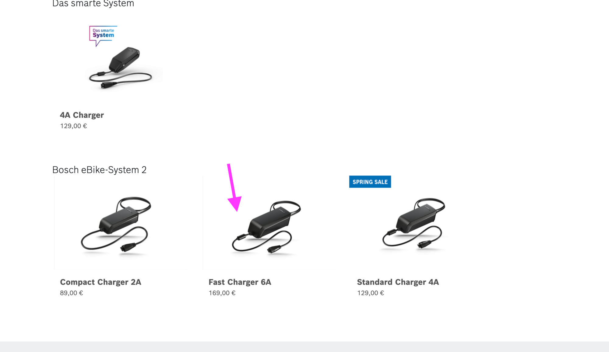

Only the top charger is compatible with your bike. It charges at a rate of 6A. The lower charger is a 4A charger compatible (different plug) with Bosch's recently introduced 'Smart System,' which did not exist at the time of your bike's manufacture.

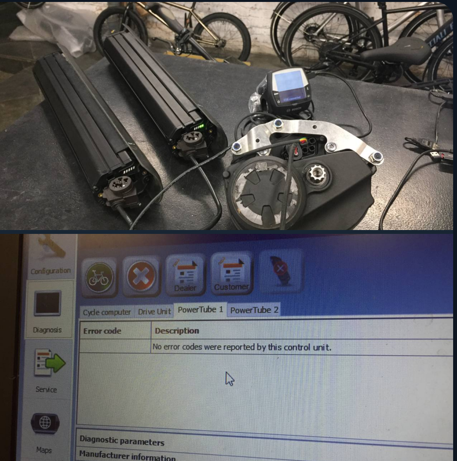

This one for me too , right ?

It depends how you implement the second battery.
If you mount the second battery but only connect one battery at a time, by disconnecting the used battery when empty and connecting the fresh one, and if the second battery is the same as the first one and a Bosch battery, there should be nothing needed.
If you use a battery combiner that allows you to connect both battery at the same time but keep the same voltage for the combined battery, it should not matter for the controller.
Worst normally the battery charge capacity indicator may not be accurate.
But you never know if Bosch has implemented something that would detect the non Bosch battery and cause problem.
And as far as I know, there is no way to touch the Bosch programing except with dealer tools
Guys said diagnostic tool does not see issues , but i still do not understand how bosch computer will calculate the distance

Sounds good.
I can't be sure how bosh calculates the remaining distance, but without reprogramming the battery characteristics, it will most likely be wrong, as it will extrapolate the voltage it reads based on the assumption of the single original one.
That said even if the Bosch computer reports a wrong number, it will probably be in the same ratio as the new battery combo versus the single original one (like one to two), so easy to extrapolate.
