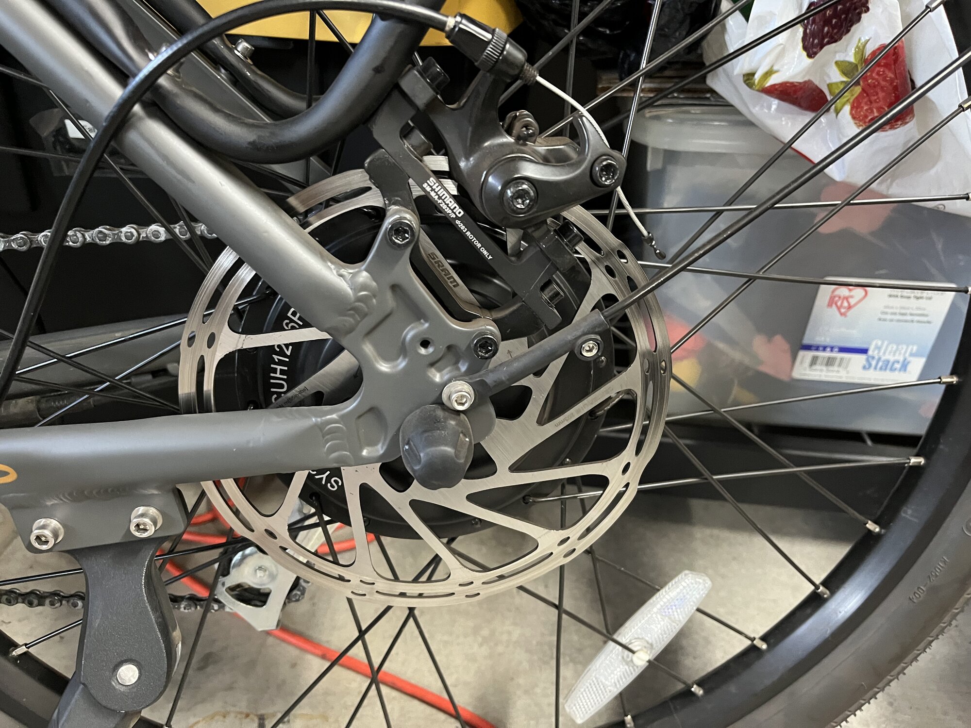

Anyone having an issue trying to adjust the rear brake pad near HUB motor? Using stubby and low profile wrenches wont fit. Being advised to buy a grinder by CS to grind down the hex wrench even more. You should be able to make adjustments with caliper in place without removing completely. Shouldn't have to spend money to make a specialty tool to maintain a simple task adjusting the brake caliper.
I had the same problem. You can grind your hex wrench into a pile of dust but it will never fit. The gap is just too small. I fixed my problem by purchasing Shimano 203mm disks and a proper spacer. Clearance of the 203 spacer required me to file down the outside corner a bit. The brake went on easily and is now simple to access the adjustment hex AND the braking is phenomenal. Have over 1,200 miles since the upgrade and very satisfied with the results. Cost to upgrade was about $30. Uses the same brake pads and calipers.

Here’s the upgrade. Ride1up 500ST. I kept the front brake stock at 180mm. Don’t fix what ain’t broke logic.

My 500 ST came with 160mm disks. I tried some cheap 180mm disks. It pulsated badly on the front so I switched back to the 160. The back worked fine and now has easy access to the adjuster.
