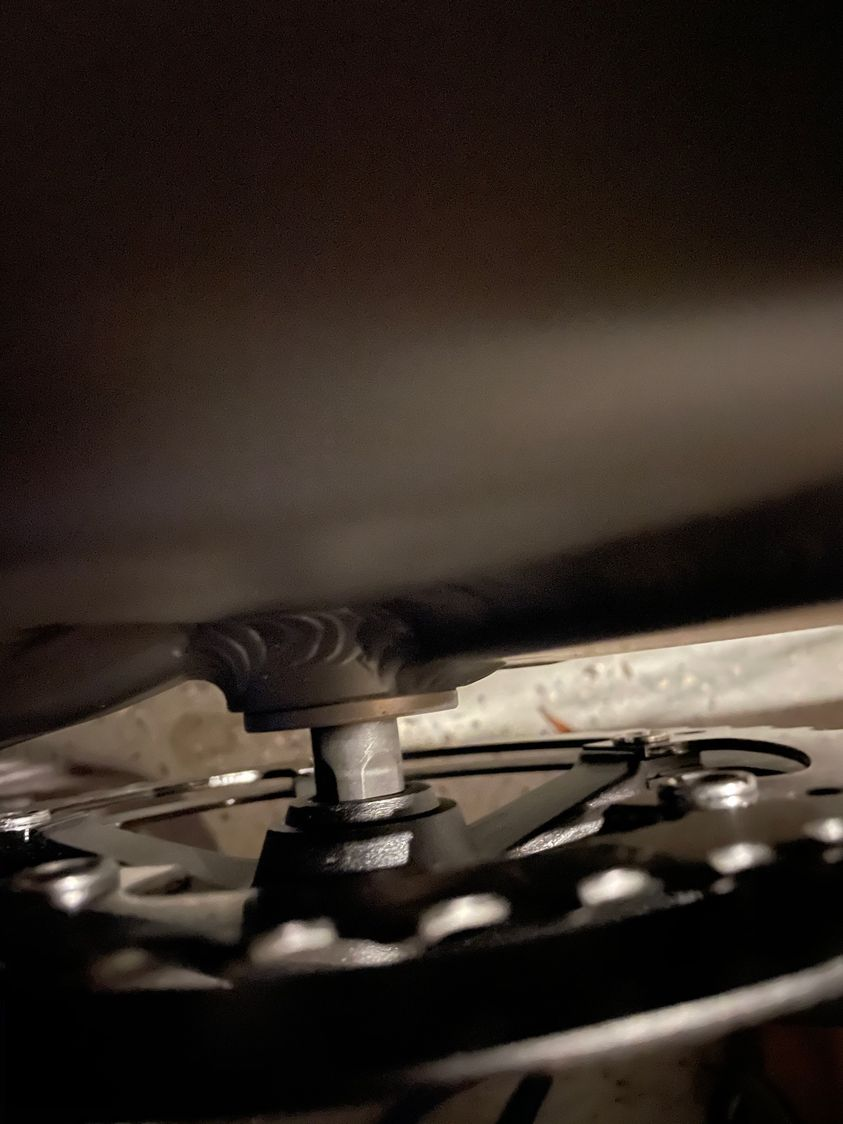

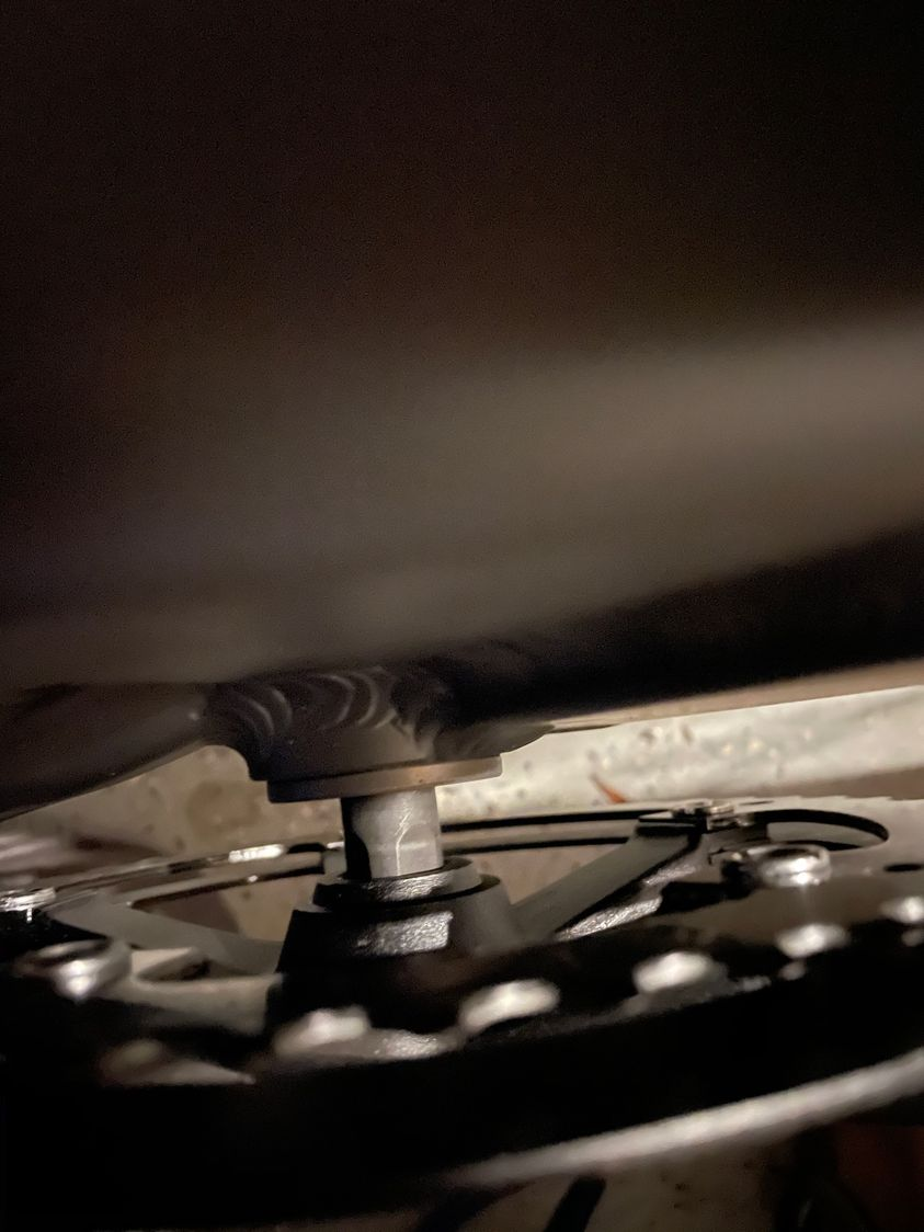

A recent poster on the FB group worried that their crank was not sitting very far onto shaft during install. Of course that could be a simple matter of not torqueing it down all the way onto the taper but it could also be a defect preventing proper mating.

Their pic - not mine.
If the crank got any closer then the chain ring guard area would be touching the rear part of the bike frame. I also thought that my crank wasn't sitting far enough inside the shaft, since I can still see flat sides of the shaft on mine similar to the pic posted.
Looks like there's close to 1/4" clearance between my chainring and chainstay. Earlier poster mentions millimeters of adjustment made a difference for him. My 700's chain hasn't fallen off, but I haven't had it long and almost always ride in the higher gears.
