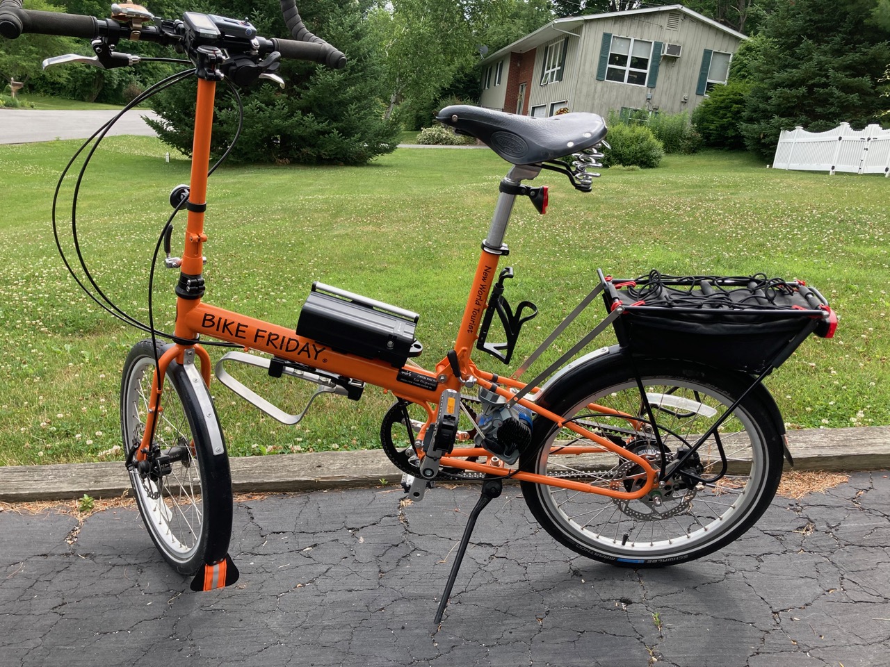

I'm a newbie. I've just installed my OM on my Bike Friday NWT Silk and it is impressive. I installed the motor within the rear triangle using a specially designed mounting block that Jeff at OM designed "on the fly," built and shipped. The people at OM are very helpful. Here's a pic of the install. I got the larger battery, shown mounted on the crossbar. The motor tucks nicely into the rear triangle.
I have the rear triangle mount on my BF pakiT! I love that it doesn't interfere with the quick fold at all. I personally think this is the best solution out there for Bike Fridays. Everything else adds too much weight.
I agree, and orange is the best!
