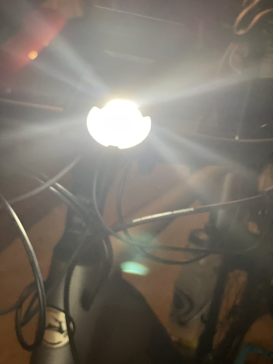

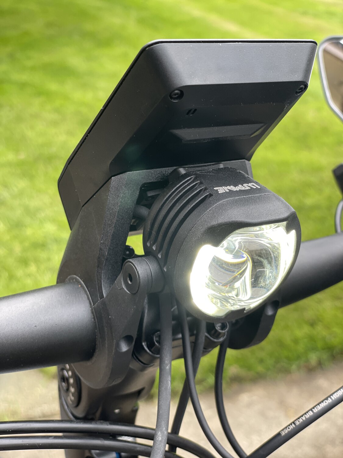

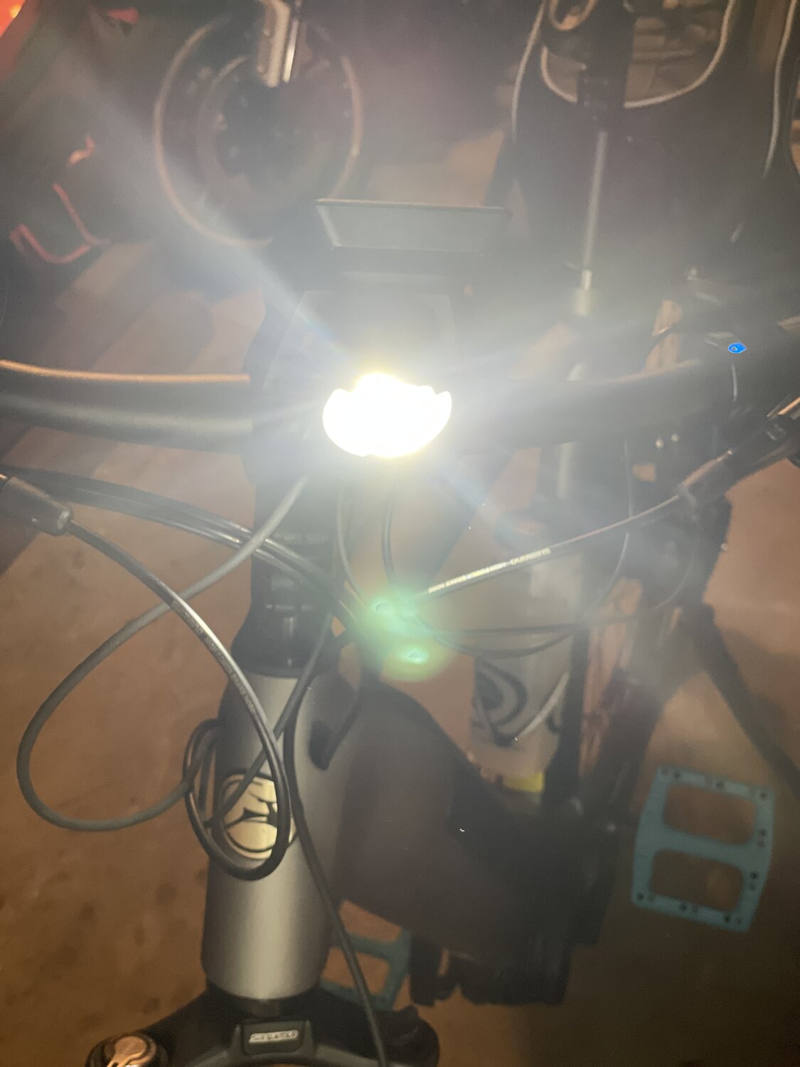

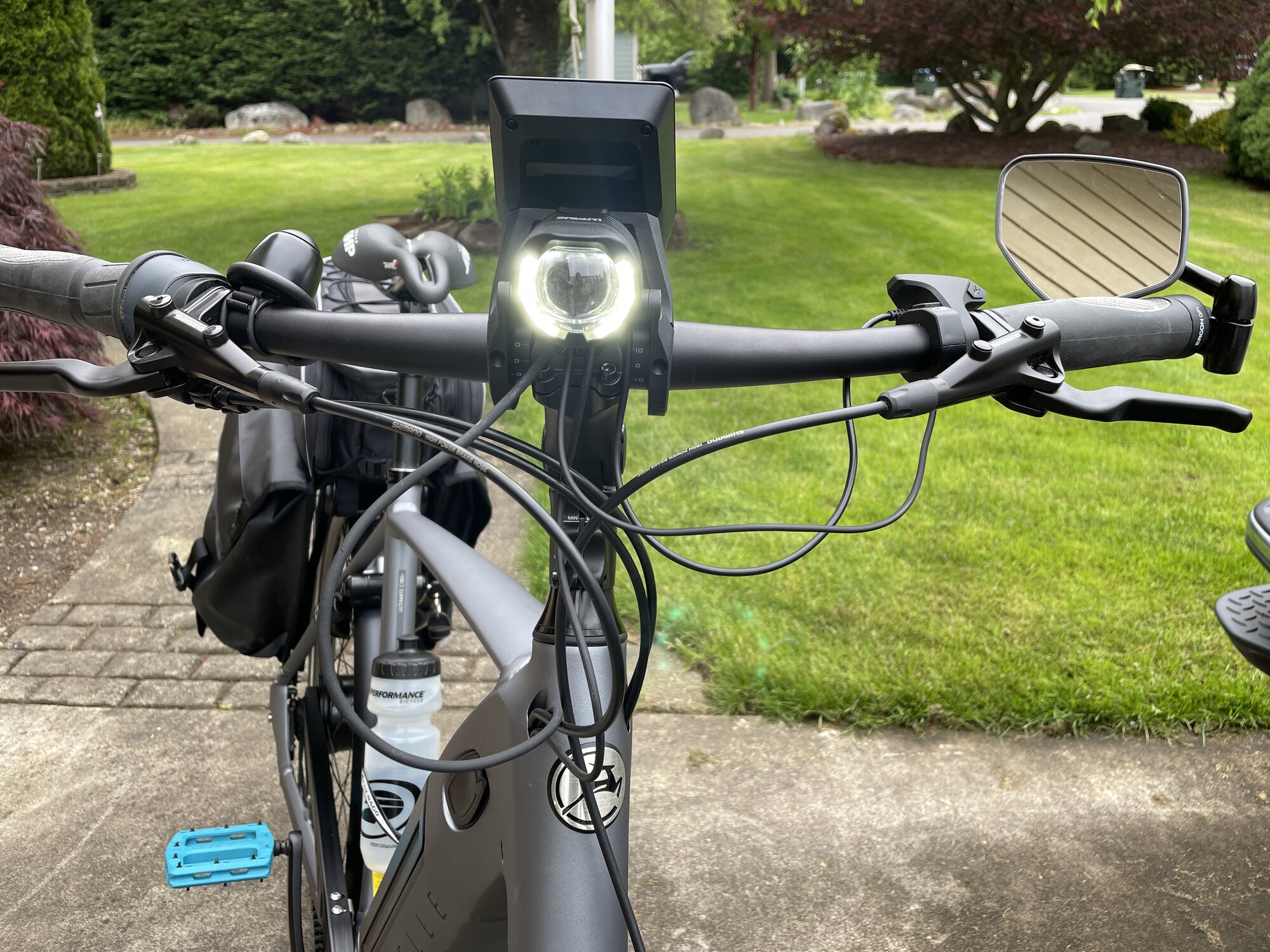

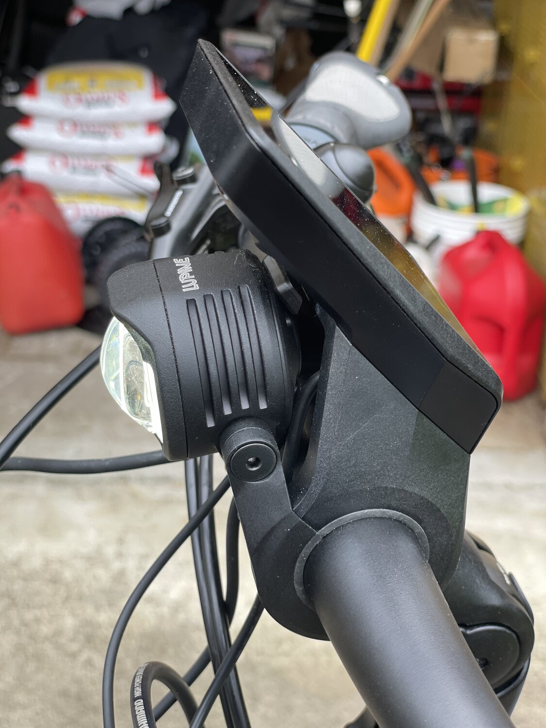

This setup is a lot brighter then stock!
Stock light is just a day light, pretty useless in darkness. Had to replace it since didn't feel safe commuting after the sunset with stock light.
Like the lupine light you choose and it is relatively affordable - I paid more for my Supernova M99 MINI PRO. However it really works well, so this was a great investment!

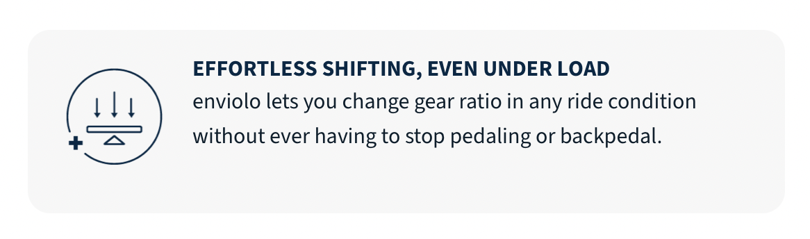

Checking out the Enviolo website this is perplexing. They advertise this ability prominently.
Definitely not the experience we're having so far. There is a troubleshooting page, but I think this will have to be dealt with by the dealer.
