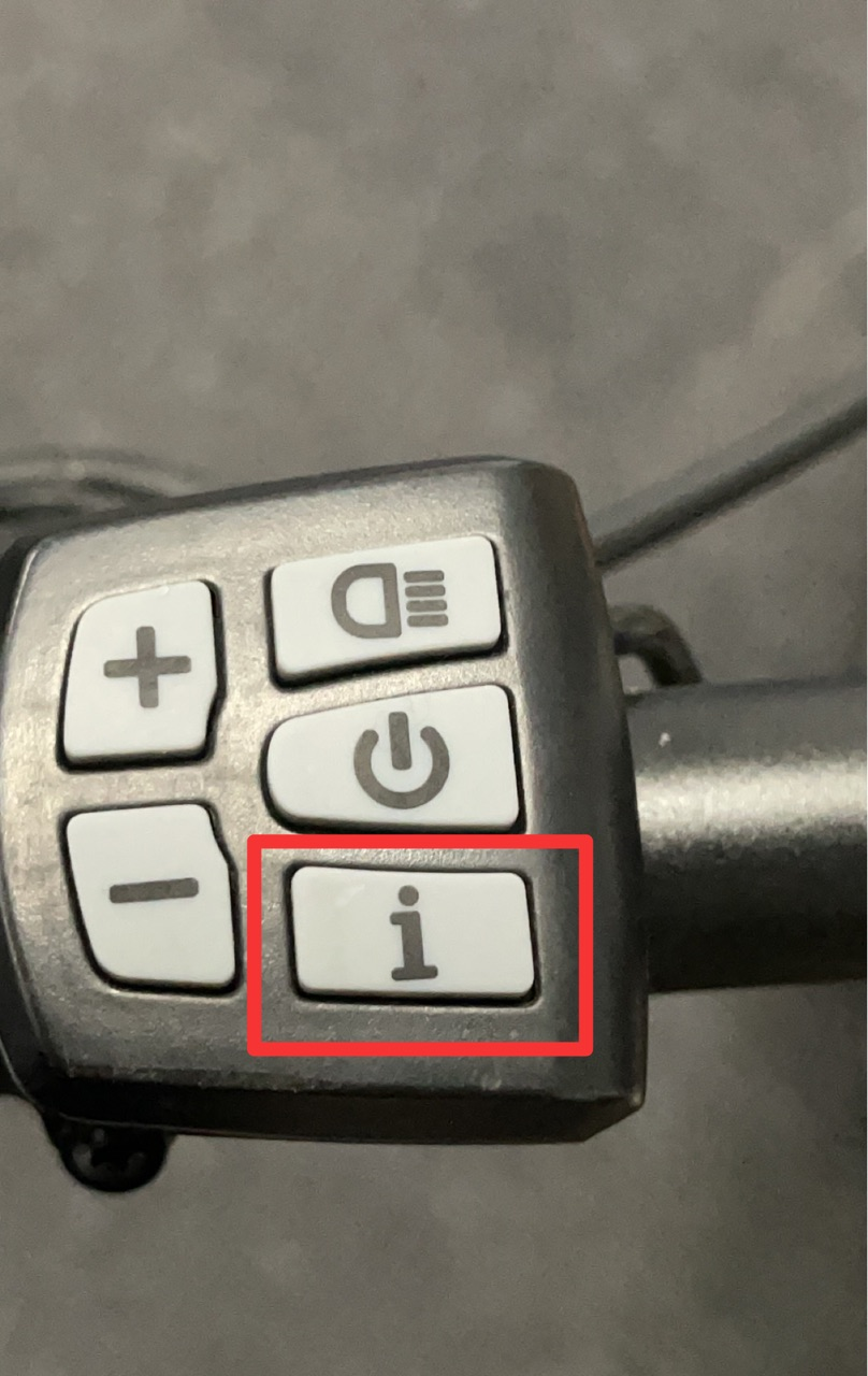

I just received my Frey Runner and am loving it so far. I got the 1000w rear hub motor. The computer is a DPC-18 and I noticed it is programmed for 29" wheels, but I got the 27.5 inch. It doesn't appear I can change this directly in the computer. My two questions are 1) If I don't change the wheel size in the computer, won't my mileage, MPH, etc be off? 2) Can this be reprogrammed? I see programming cables, but only for mid-drive.
If you haven't figured it out yet, you should be able to change the wheel size in the "I" menu on the DPC-18. There will be a handful of settings in there including speed limit and trip reset.
Thank you, I'll take a look. I saw wheel size somewhere in the menu system, but it was greyed out and I couldn't select it.
This is what I got from BAFANG DPC-18 manual, hope it can help you: After turn on the display, briefly press (<0.5S) for two times to enter into the“SETTING” interface. “Wheel” --- set the wheel diameter.
Briefly press (<0.5S) or to select “Wheel”, and then briefly press (<0.5S) . This moment, briefly press (<0.5S) or to select the wheel diameter as “6”/“7”/“8”/……/“32”/“33”/“34”. After confirmation, briefly press (<0.5S) to save the set and exit back to “Wheel”. Briefly press for two times (interval time is less than 0.5S) to exit back to main interface or select “BACK” → “EXIT” to exit back to main menu.
