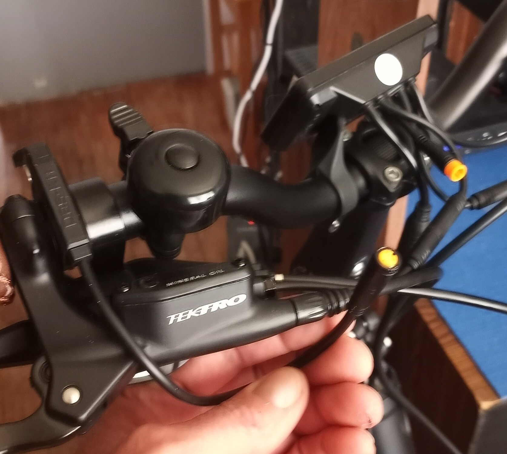

I have an ET Cycles f720 (das-kit motor) and the thumb throttle gets stuck. I want to replace it but don't know about compatibility. How do I find a new one?
I don't see any washers. What kind of wiring issues would I run into with a generic throttle?

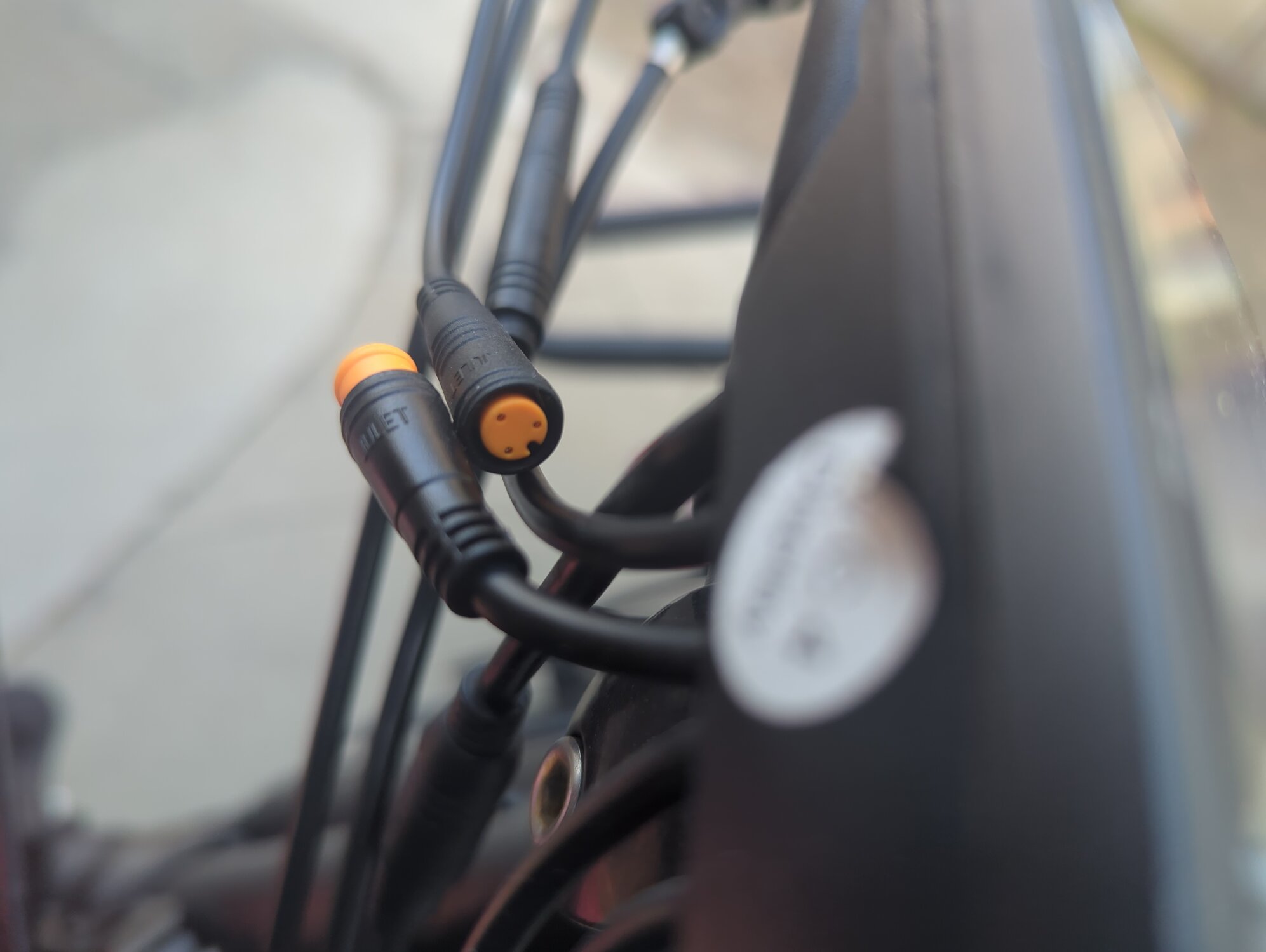

This is what the Das Kit looks like
If the grip rubs without washers, that is a problem. That photo is a standard set up. On some bikes the red and black are reversed, it requires a cross splice.

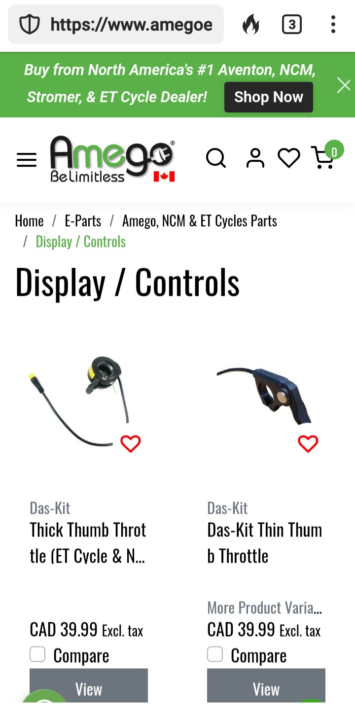

Amego in Toronto has two throttles to choose from for an Et.Cycle

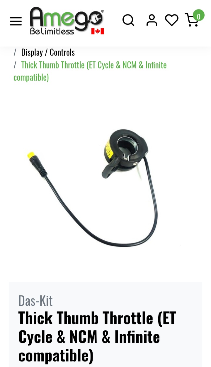

That thick thumb throttle at Amego looks wrong.

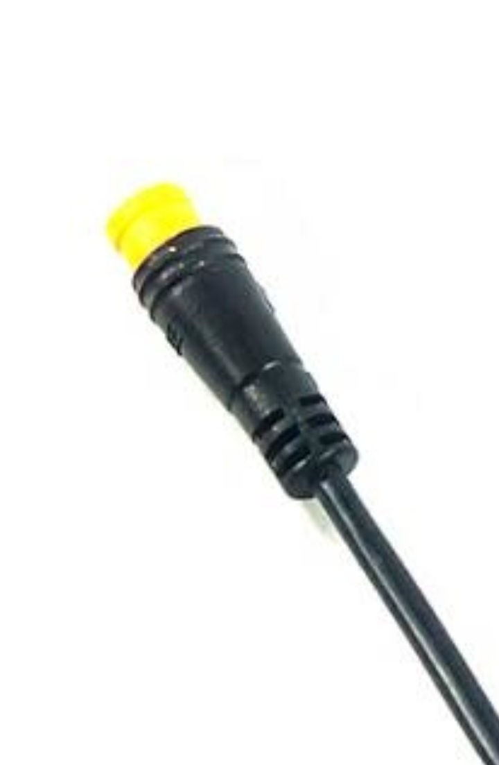

It's got a female plug,..
My thin throttle had a male plug,..
Perhaps they posted the wrong picture?
