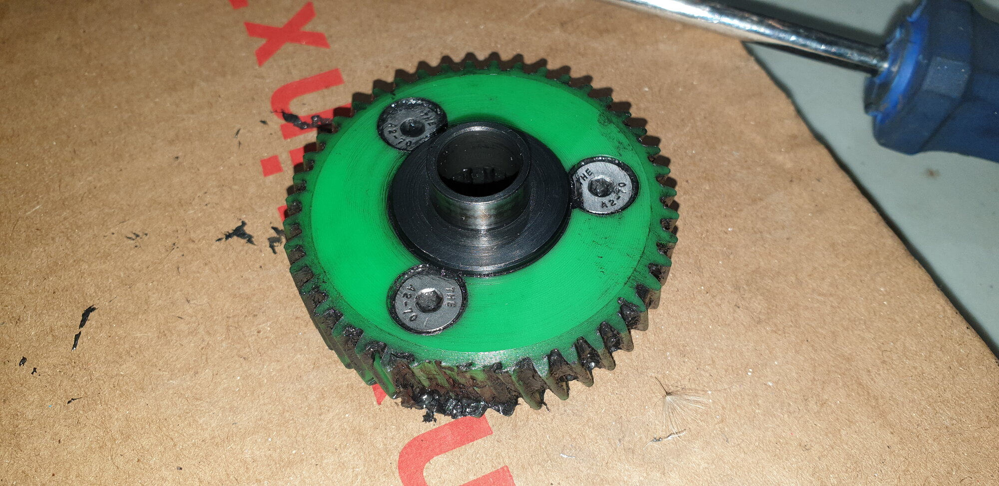

My Dapu mid-drive in an Ariel Rider C-class, supposed to be a 500W motor, broke down after about 1000 miles. I drive street-only continous uphill sections; something I would think a motor should more easily handle. After taking it apart, I found the synthetic gear to be the culprit (see attached) that made the motor snap when it tried to support. The indication during riding was a "tok-tok" kind of sound that made the support push from the motor erratic. I saw on ebay people selling gears for Bafang motors but I wasn't able to find really any spare parts for Dapu let alone a replacement of the gear. I wonder if anyone knows a source or has any suggestions. The motor model number printed on the bottom of the motor is 1909A067. I tried to email Dapu but the email address mentioned on their website bounces.

most gears are standard but without the 3 screw holes or the correct bore. Take it to a gear supplier to see if you can get a match up and then go to a machine shop and have them copy the bore and 3 mounting bolts. my c class just started making the tick tick sound. I can not see from the pic what is wrong with the gear. If I have to replace mine I'll put in bronze gear and live with the extra noise.
I have a couple tsdz2 on bikes. They are great DIY conversion kits that, for many bikes, are a simple installation to a person who knows which end of a screwdriver to hold (many on this forum apparently don't). I'm sort of perplexed when I read of people take weeks to months to install the kit (or buy one to never use it). I have the plastic gears in both of mine without any problems. I took one of the motors apart to convert to coaster brake capable, the plastic gear in that motor still looked new after ~1000 miles of riding very hilly terrain. Replacements are inexpensive and easy to install, if necessary, so I wouldn't bother with the metal gear myself. For comparison I also have a Yamaha powered mid drive gravel bike, it is excellent, similar to the Tongsheng but if I ever need parts for that bike I will be out of luck.
One additional thing. Your motor is available both with plastic and metal gears. Must be a reason they offer metal....

Paranoia, and after market pitch. 3500 miles and replaced the plastic gear on a bike that climbs a steep bridge grade across the Mississippi River On every ride and back.
