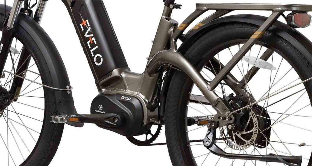

Did you ever find a replacement for your green reduction gear? I have the same problem on my Evelo Aurora Limited Edition that has the Dapu MD250 motor. In my case all three stainless steel flat head screws holding the gear to the roller clutch were sheared off and the screw holes in the gear were slightly elongated in the rotation direction. It lasted almost 3,000 miles so I can't be too upset but a more durable reduction gear design that was still non-metal would have been quite helpful. The only way Evelo can find me a replacement gear is to disassemble one of their spare Dapu motors. I'll never buy a bike with a Dapu motor again because of the impossibility of getting replacement parts.
