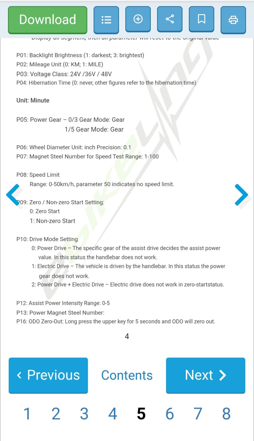

I have a 36v 250w motor, the controller I’m replacing is a 36v 12a with a 36v 20a my question is will the controller cause problems with the motor
Most likely it won't cause a problem. Best if you buy a controller kit that has an included display. Displays tend to be specific to a particular controller (though some you can run without a display). Nice to get all the other bits to minimize the splices and soldering, and match the motor's connector to the controllers.
It's all pretty easy, as long as the bike isn't so proprietary, and the battery and controller don't need to handshake.
Thanks for your reply and help, I’m merging two systems, the display and controller match each other, motor and battery from different system, all the cables match except changing the battery leads to a xt60, I was concern about the difference between the controllers , one being 36v 12a (original to the motor) and the replacement being 36v 20a
It's possible that you could cook your motor with the extra power, but you may be able to turn down the power with the settings on your display.
If you can't adjust the power settings, hopefully you've got a Watt meter/Ahmeter/Power meter on your display so all you really have to do is keep an eye on it.
20 amps continuous could start overheating your wires, connectors, and motor until something burns or melts, so just keep an eye on things and you should be fine.
You should be able to reduce the power by simply turning down your PAS level, or just back off on the throttle.
I've got a 500 Watt motor, but I can give it quick blast of 1400 Watts for a few seconds without issue, but I can't go full throttle continuously.
If both of your systems have a 36V 250 Watt motor, then you'll have no problem.
It's when you feed 500 Watts into a 250 Watt motor that things start heating up.
It may be the battery itself that was the limiting factor and could only deliver 12 amps reliably so they used a less powerful controller.
Actually the controller/ display were used on a 500w rated motor since i only use the throttle from a stop briefly and normally ride in PAS 2, i’ll take the chance of burning up the motor, call it a science project
Just pull over and put your hand on the motor to check it.
If it's too hot to touch, then it's too damn hot. 😁

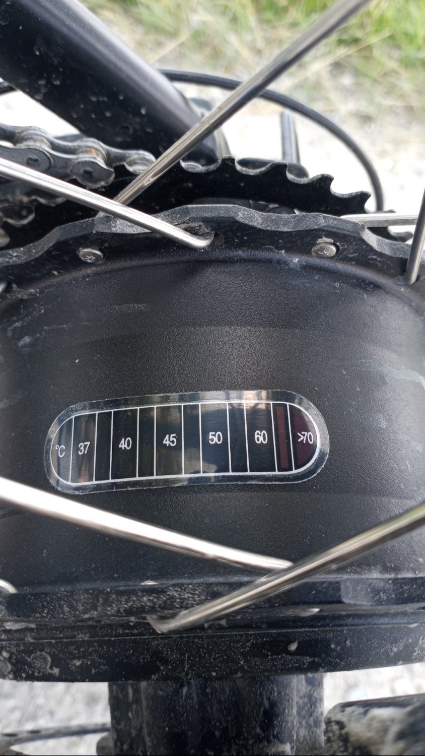

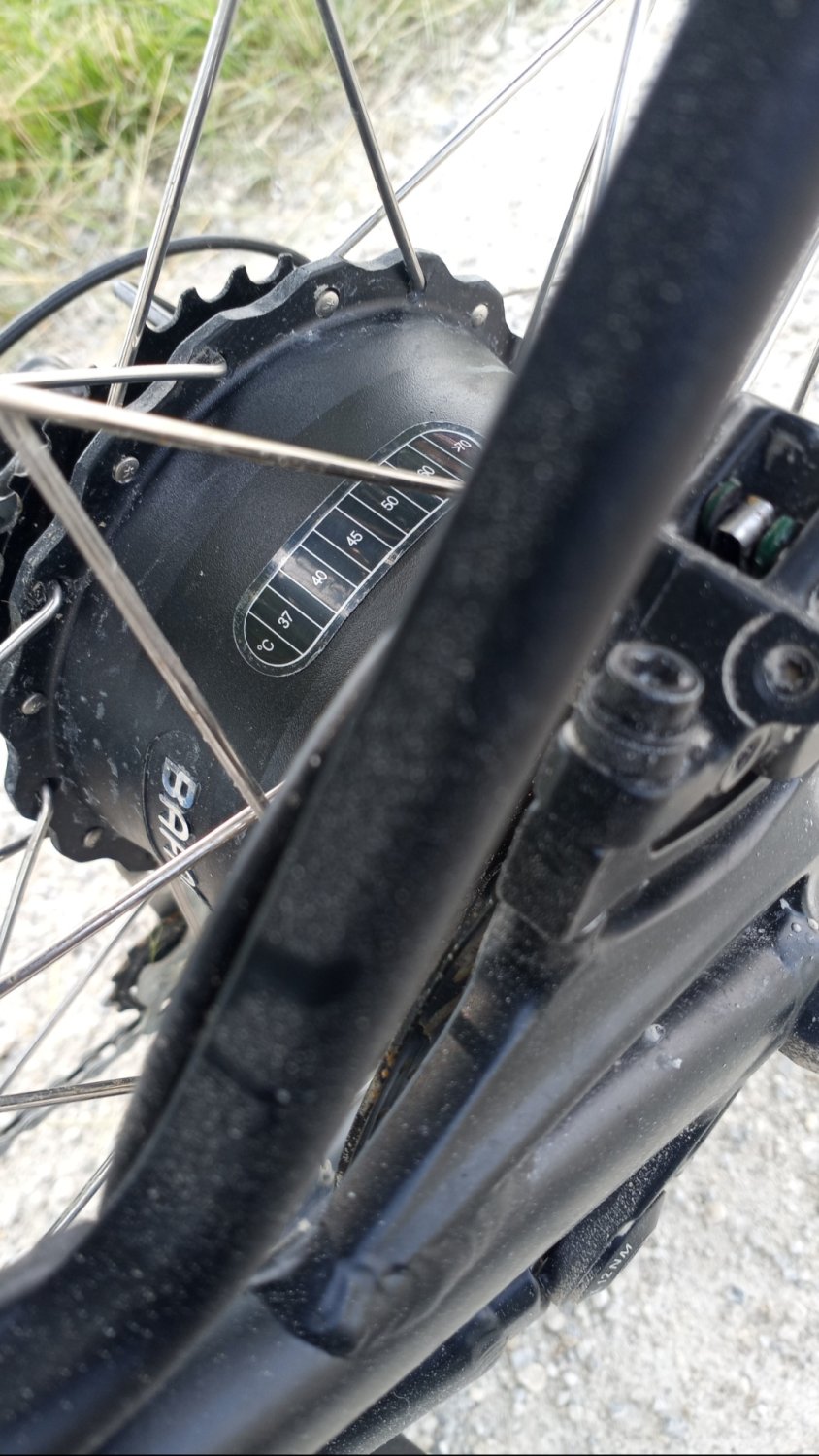

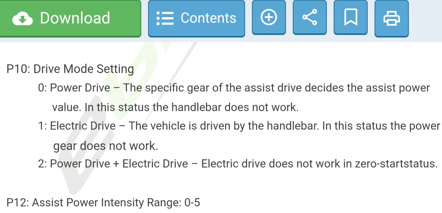

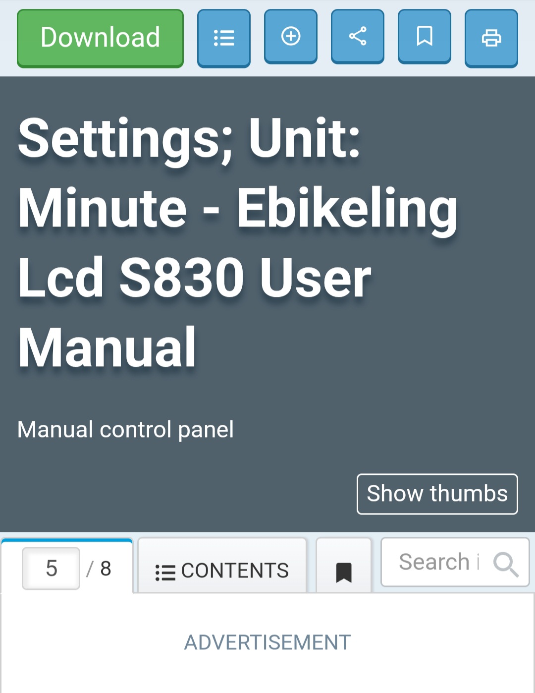

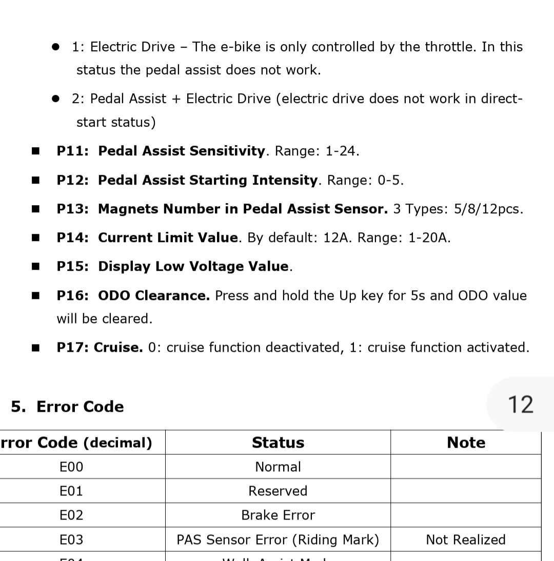

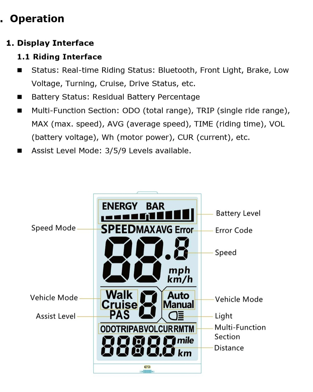

I bought a bunch of these and stuck one on my hub motor,..
It's got a better temperature range, because its for a coffee kettle not an aquarium.
Unless you're making fish soup. 😁
