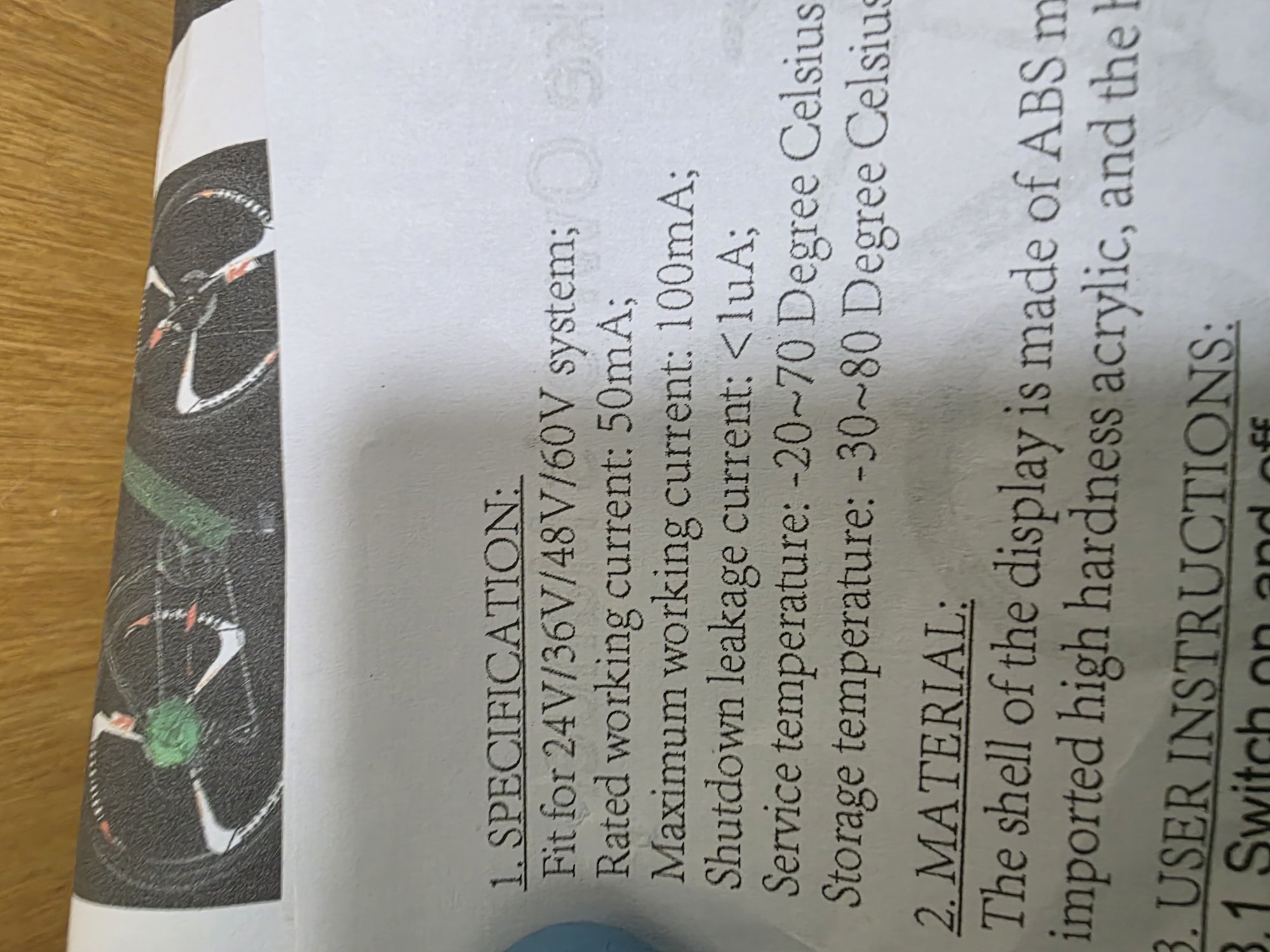

Is it safe to use a 60v battery with a 250watt motor and 36v control box on paperwork it says fit for 24v,36v,48v and 60v system but not sure?
This is info on bike i have
36V bikes with 250W motors are rarely fitted with controllers that can take 60V batteries. That little blurb is talking about something else,. It could be the display, if you have one.
A true 6)V battery goes up to 67.2 volts at max charge, Here's the max voltages
42.0V for a 36V battery
54.6V for 48V
58.6V for 52V
67.2V for 60V
Yes the information you posted are the specifications for the display only... Not the motor or controller.
Stay at 36v
