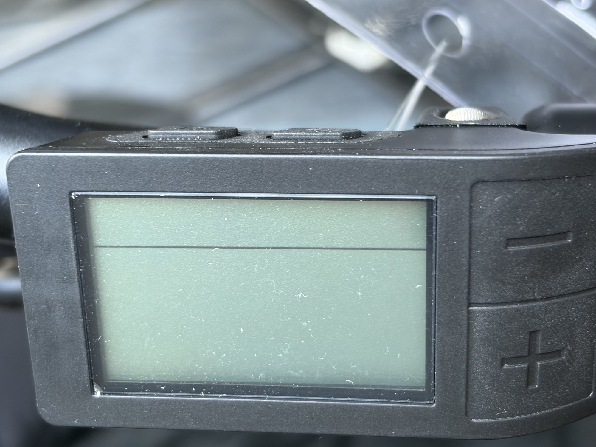

What about hacking the computer to go faster than the street limit. I held down both buttons it didn’t seem to go into a setting menu like some online.
That may not be possible. Some manufacturers have provided a feature to disable the speed limiter in the past, but laws have been passed in many areas like California, to discourage manufacturers from doing that. I would suggest riding the bike and seeing how you like it with the factory configuration before you start modding it. If the controller is embedded in the motor, it may not be easy to replace, but it is possible. You would probably have to replace the display too.
With a commute of only a few kilometers, going a little faster isn't going to get you to work much sooner and there will be places that you simply can't ride it faster anyway, like MUPs.
But if there was any shot: what would you press on this display?
Got the SL setting but it won’t change hahaha
Does one just buy a new computer?
Or a usb cable to flash it.
If flash, where do I get the file?

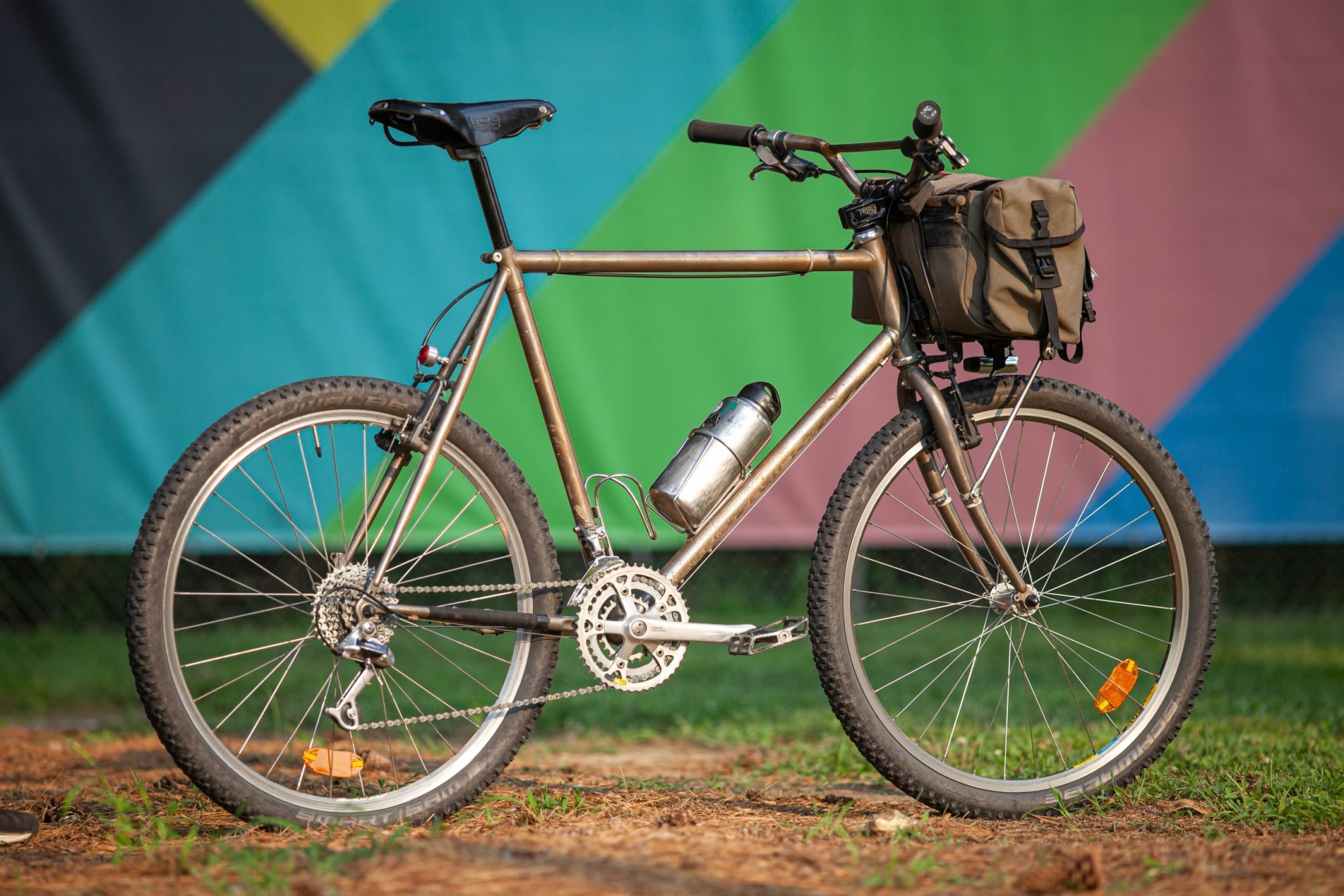

Not any help to your decision - but as I haven't heard the name in a long while... Back in the late 80s Diamondback were the dogs bollocks, one of the best MTBs around. My friend had an Apex and we spend many a long day on the mountains trashing our bikes and that bike took anything he could throw at it! He later had an Ascent, both bomb proof, clean looking steel MTBs, comparable to the Gary Fishers Konas and Marins of the time. Like GT they started in BMX and I remember one bike maybe Apex? had a stunning black lava with fiery red cracked paint job! Very cool. They won a world downhill championship, couple of XC comps and even (thanks Wiki) a bronze at the Olympics in the 90s. They also helped pioneer full suspension mtbs. But like so many MTB/BMX quality brands they were sold end of the 90s and have since apparently bounced around between 7 or so owners on a downward path to being a supermarket bike.
There are still loads of those 80s & 90s ones around, as I said, bomb proof. They are a favourite for gravel bike conversions. Here's a 90s Apex resurrected for today. Still very cool!
