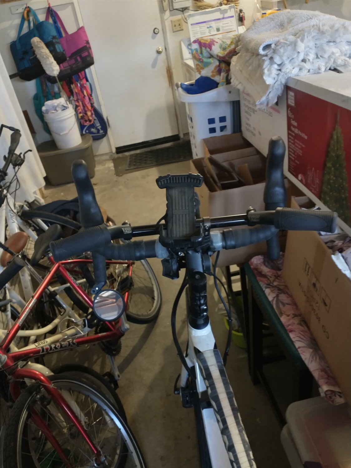

View attachment 132385Greydog, thanks for the added info... I ended up with a squirrelly-looking hybrid Mcgiver approach that actually worked for my old back...
Thank you Greydog for letting me know... Will check these out - TodHey Todbar, my son found an adjustable bike stem that can go straight up vertical. Scroll down to the bottom of the link to see it set vertically.
