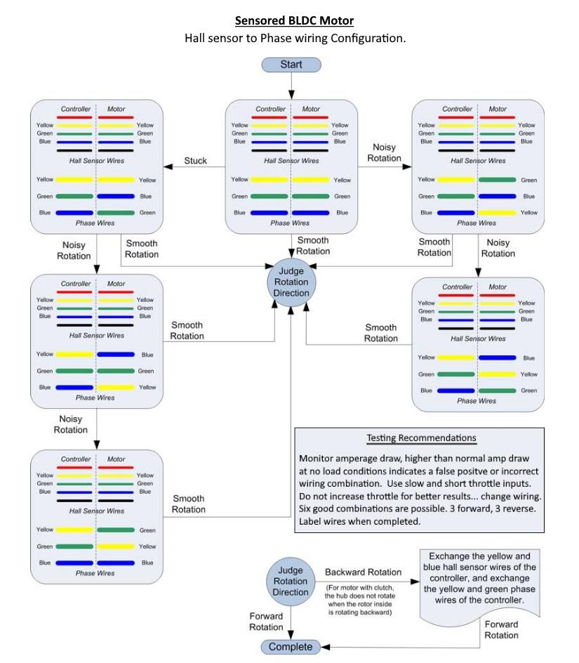

Depending on the controller, there MAY be a “self-learning” wire. The motor will make a sound if it is spinning in reverse. The wheel will stay in place. The self-learning wire will need to be connected LAST and can temporarily be connected so the controller can “learn” motor direction. Once everything has been connected, connect the “self-learning” wire. If the motor makes a sound, but no spinning wheel. Then, unplug the wire and reconnect. The wheel should now be spinning properly and you can disconnect the “self-learning” wire, as it is no longer needed.
If the controller does not have this “self-learning” wire, then trying to connect the motor hall phase wires will become a game. Not bad, just time consuming.
Please refer to the green, yellow, and blue phase wiring. Also note the diagram at the bottom right as that has more info on motor direction.
