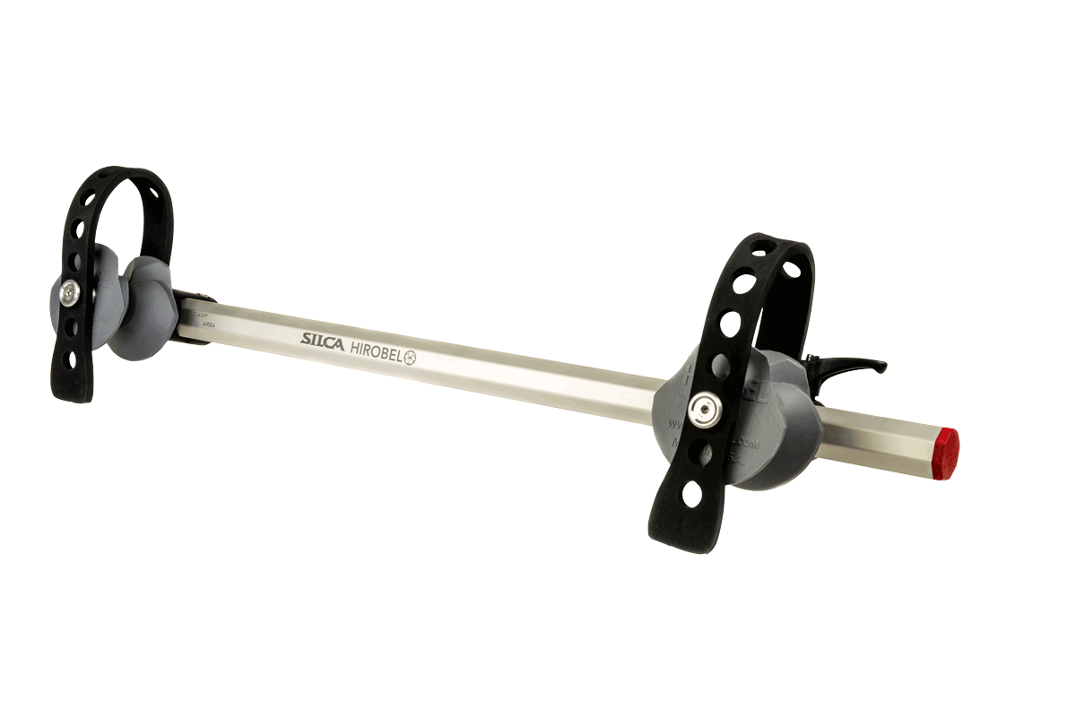

I did finally locate Silca's Hirobel carbon frame clamp which some closest to being a good support for an e-bike with a carbon fiber frame. It supports the top tube at the top tube and and again at the seat post end. A bit like holding the bike with both hands to support the weight off the ground. The Hirobel in turn is clamped into a standard bike repair stand like my Park Tool one. It is the first support that is designed for heavy bikes with carbon frames and provides full access to every component on the bike, including the wheels for tube repairs or tire replacement.
I like this carbon frame clamp. I think I'll order one. 👍
Any idea what the wheel-things that the frame sits on is made of? Just wondering if they could leave marks on the frame.
