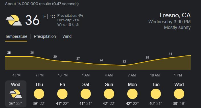

We have an entirely different issue with climate here. this is my 10-day forecast. For my USA neighbors this peaks to 108 Fahrenheit on Monday.
Here, I have to move the batteries inside but so they don't get too hot. Yesterday after my 15 mile/24km ride home my battery was 100 fahrenheit, which was the same as the outside temperature.
