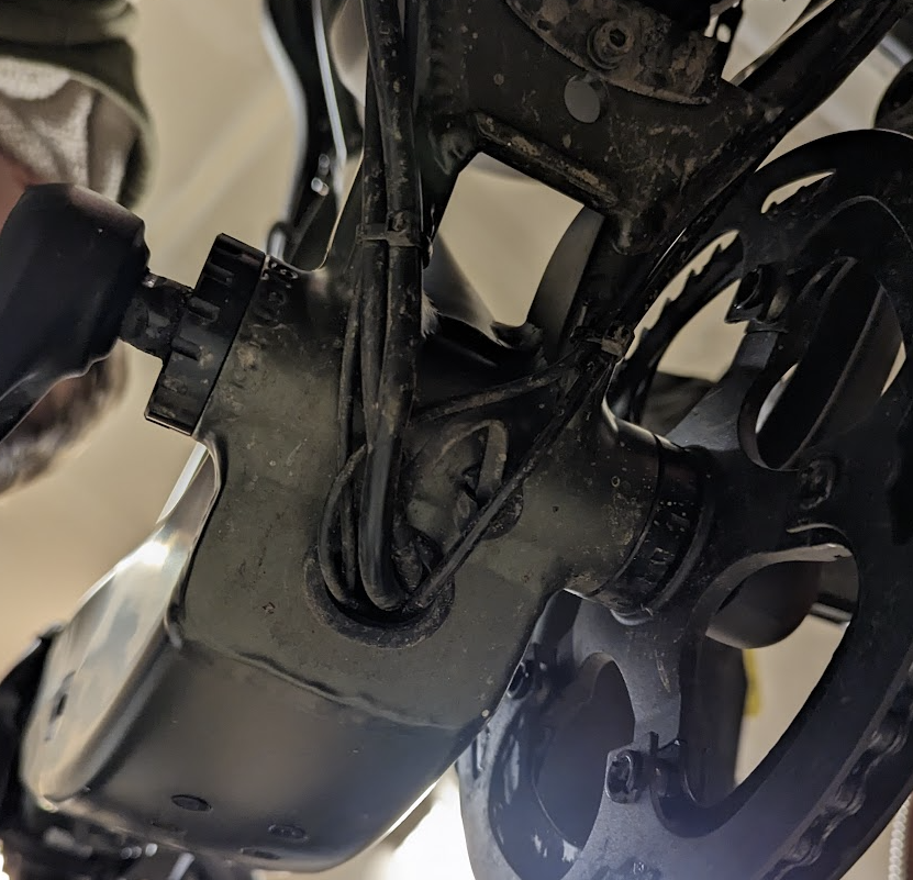

While trying to get a picture of my serial number I was reminded of an area I forgot: All of the wiring on the bike comes out from an unprotected hole at the bottom of the downtube. This issue is so well known you can buy a 3rd party skidplate for that area.
BTW, my serial number is fully in view in this pic. If someone wants to "steal" it, be my guest. Please tell me what it is, because I can't read it. I'm going to have to go back and take more pictures from different angles to read the stamped numbers.

Finally got my Park Tool CC-3.2 chain checker and I see that after 350 miles my Aventure.2 chain is already well over 0.5% wear (not quite 0.75% yet though).
If you find yourself in the same position, remember to buy two new chains, because the 116L standard length is 6 links short. Hopefully the new KMC chain is made of sterner stuff.
BTW if you were wondering if a Park Tool PCS-9.3 repair stand can hold an Aventure.2, it can, and it's very stable. In hindsight, though, maybe splurge on the 10.2 because the quick release would be nice with a bike you can't lift one-handed.
good god, chain worn to replacement in 350 miles!?!?!? are you lubing it with sand?

Good point about the chain. The stock one that came with mine was too short as if they put the normal 116 on it. Shifting into the lowest gear the derailleur was stretched straight forward and bending the mount. I'm up to 11 extra links now with a third party chain, because I upped the chainring and cogset to 53:11-36.
