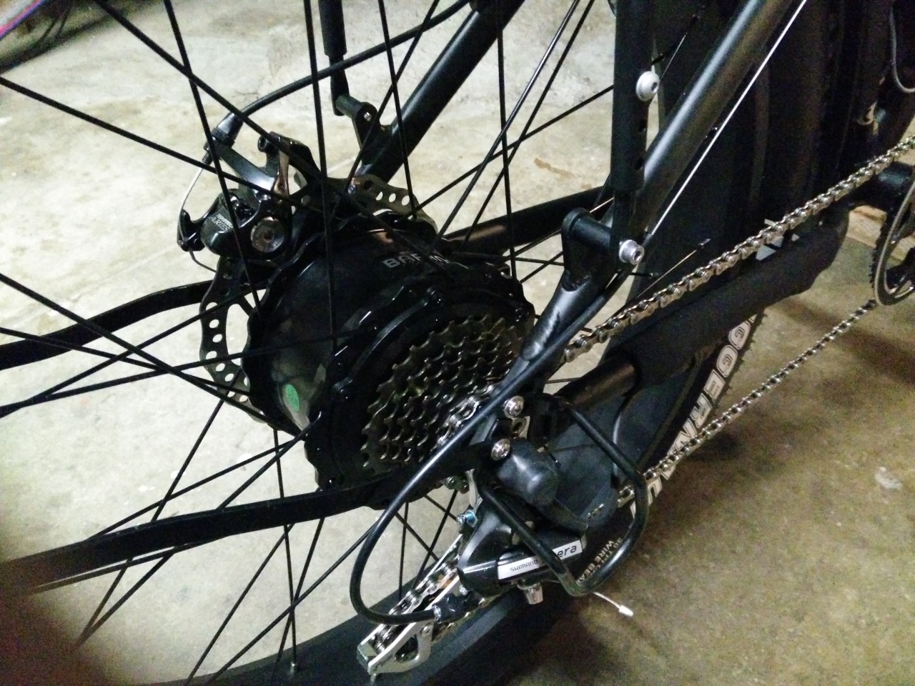

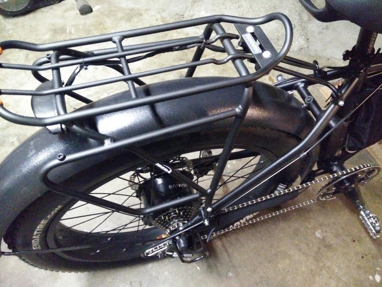

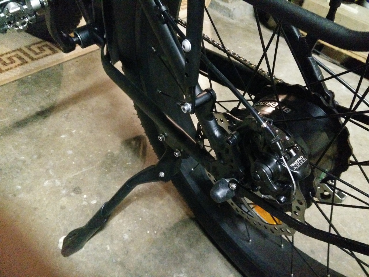

So this is for the people who are using the Ibera PakRak IB-RA5 on their radrover 2016 - how did you guys manage to fit the bottom supports to the eyelets near the brakes ? The metal standoffs which come with the kit are too wide and I had to use a lot of force to coerce the rack to sit on it - I finally gave up because I don't want to damage the bike frame or the rack.
I don't remember it being that hard to fit. The only thing I remember was the screws were tight at the eyelets near the seat. Here's how mine looks, IB-RA5 on my 2016:
View attachment 9686 View attachment 9689 View attachment 9692
Hmm - nope - I tried again - would have to bend the rack a bit to get it the way you have ... no worries I have already hacked halfway through one of the metal standoffs and will use the halves to fit it :D
