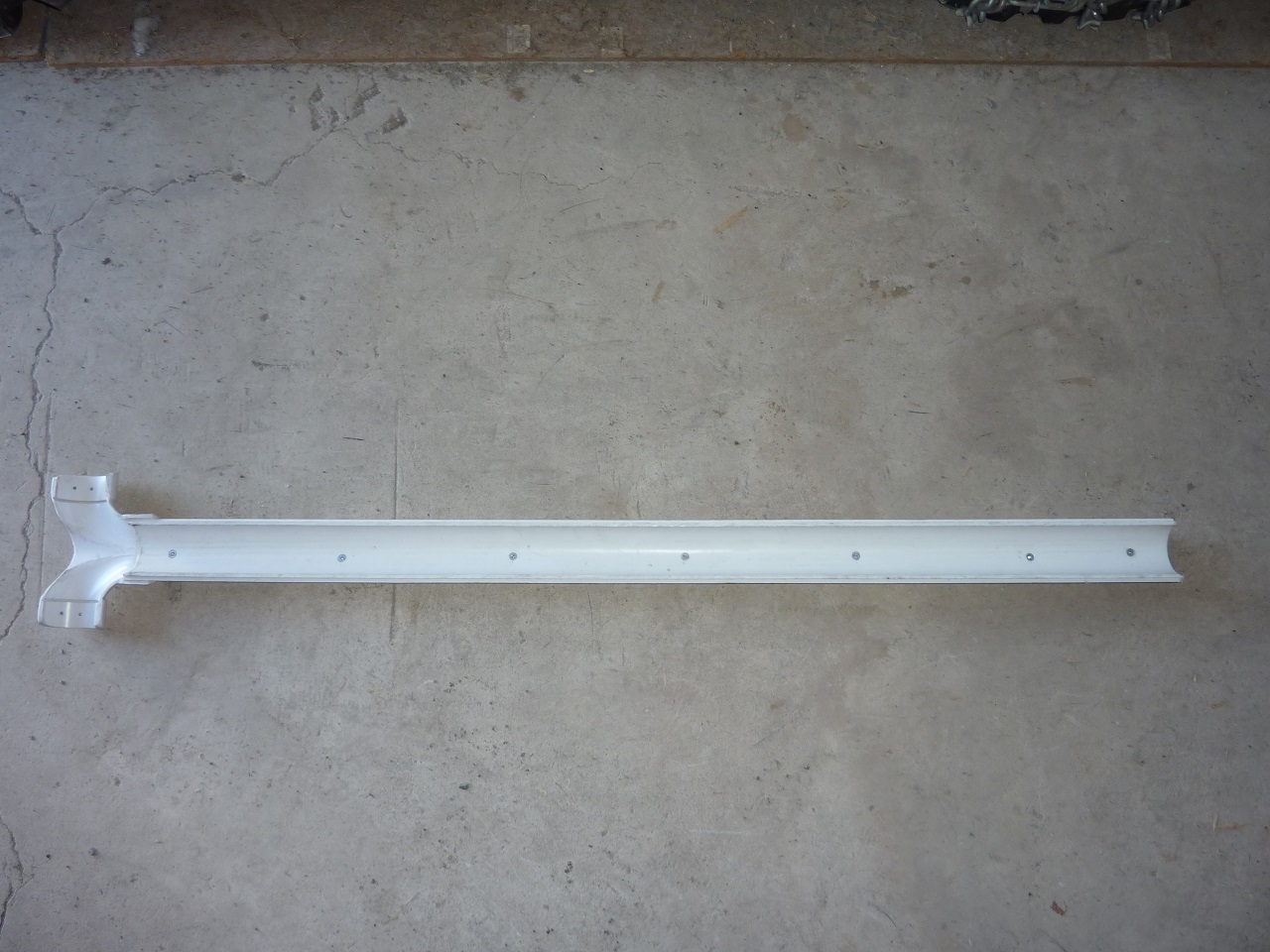

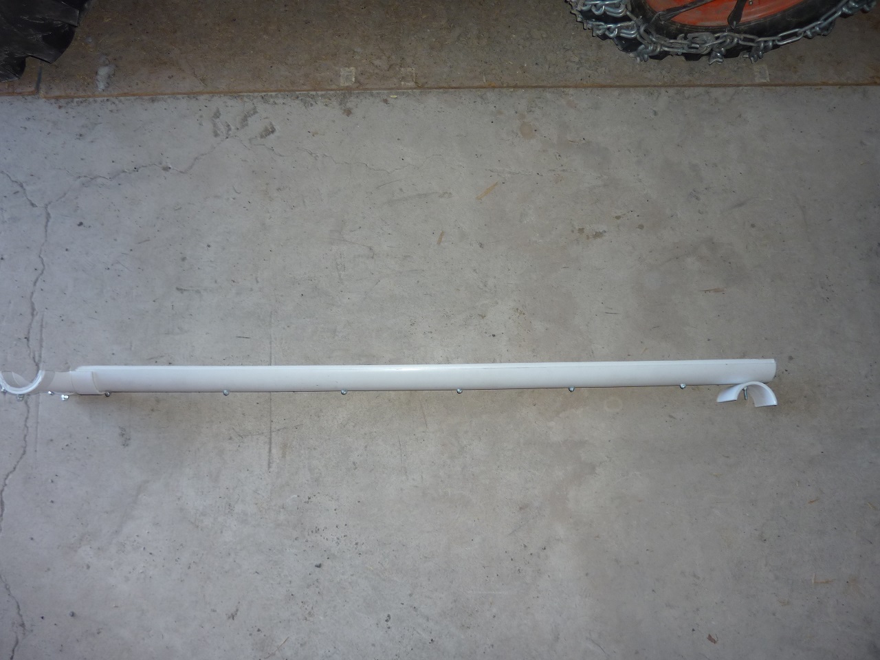

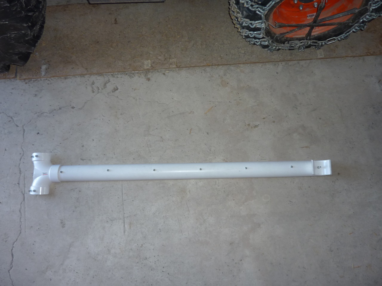

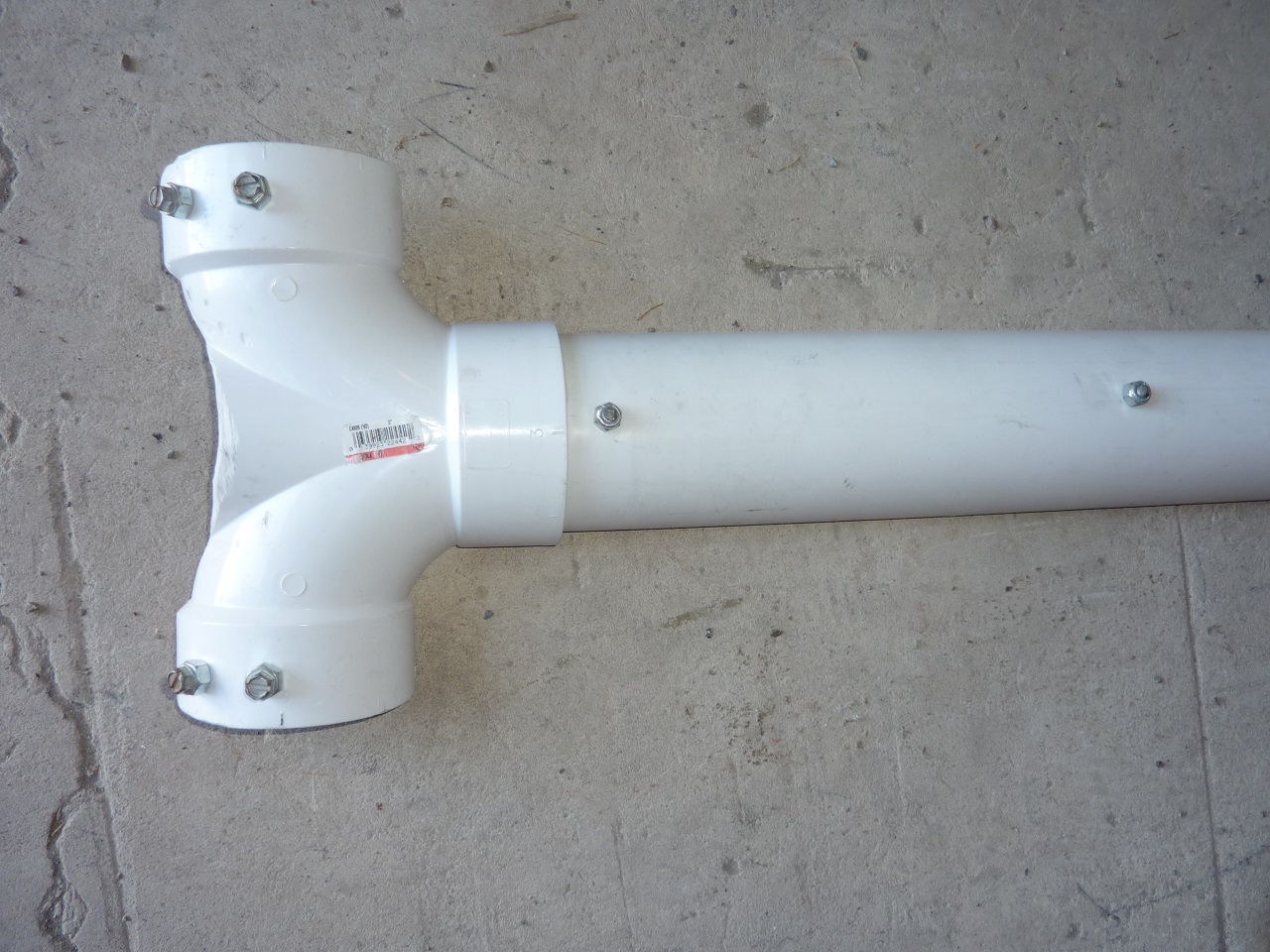

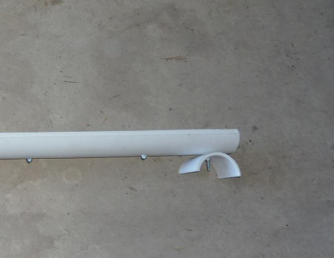

I made this one from a piece of 3" Schedule 40 PVC pipe which I split in half lengthwise. I nested the two halves and bolted them together for strength. This one is 5' long to get my bike onto a pickup bed rack but you can make it any length you wish. A hinge could be added to allow the ramp to fold if necessary.

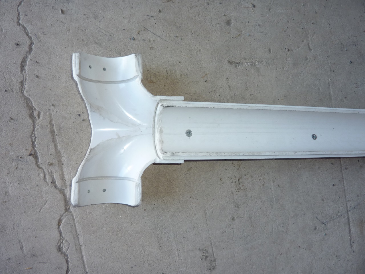

I cut a 3" PVC tee in half and bolted it to one end to keep the ramp from twisting. I added 4 lag bolts to the tee ends to keep the ramp from sliding on smooth ground.

The total cost was $14 including the bolts.

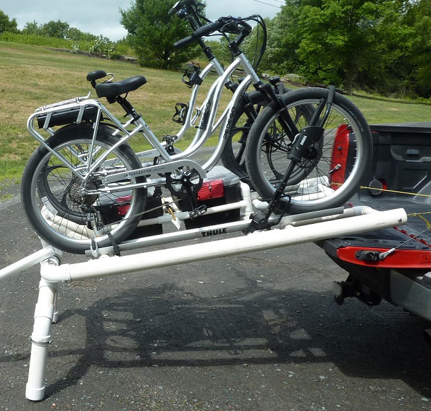

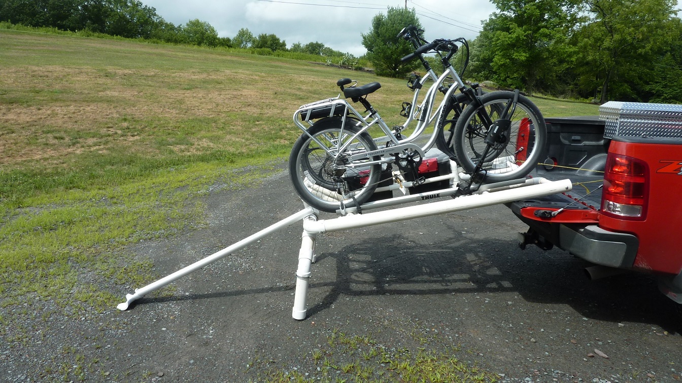

I use a pair of Thule Sidearm roof racks to hold the bikes in place on the PVC pipe "bed". Almost any type of roof rack will work, even for bikes with fenders.

In my case, the ramp attaches to a piece of 4" PVC pipe which is part of the rack. I used a bolt on the ramp which fits into a hole in the rack. I cut a small piece of pipe which is used as a "collar" to make it easy to line up the bolt & hole. The ramp lines up with the tray on the Thule rack and the bikes roll easily into place.
