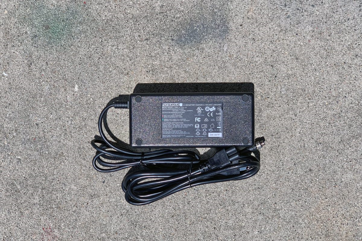

I’m wondering how many users have vale i’m wondering how many users have a Raleigh misceo IE.
It is a fantastic ride. It’s a lightweight, and durable. My only concern is to charge the battery. The charger and the battery connection is so small, that it is difficult to get the three pins In the battery aligned with the charger.
I’ve been trying this many times, and I had to replace the charger from the bike shop.
Are there any solutions to this problem?

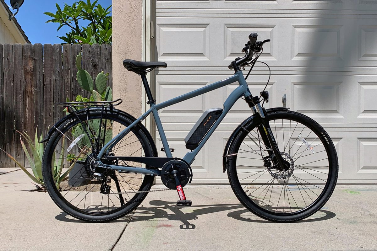

Perhaps you are talking about the new 2019 Misceo iE with the hub motor pictured below.
Unfortunately, Raleigh decided to lower the price point and go with a lot of entry-level components.
It appears that the charger for the SR Suntour rear hub motor uses a small pin conductor for charging shown below.
The original 2016/2017 Misceo iE Sport came with a Shimano mid-drive motor including the larger charger pictured above.
It appears that the charger for the SR Suntour rear hub motor uses a small pin conductor for charging.

I have a 2019 Misceo iE - and had the same issue plugging the charger cable in. I contacted the rep and he provided a short 6" adapter that attached to the charging cable and it made connecting the charger much easier. See photo.

For others having the same difficulty with the connector provided with the bike. We determined that the plastic sleeve inside the screw mechanism had become deformed and was preventing the threads from the connector from engaging while the pins were also seated in the holes. We trimmed the excess plastic so that it now flush with the end of the connector. Now it screws on more easily.
**warning - minor rant coming** "More easily" is certainly a relative description. It is by no means easy to hold the tiny connector end of the charging cable in place in a recessed battery port while simultaneously holding the rubber hole cover out of the way so that you can screw the tiny, hopefully aligned, connector in to the battery charging port. If you are like me, then you get to perform this challenge to you fine motor skills with fingers that are too big to fit in to the recessed area for the battery charging port. **rant over**
