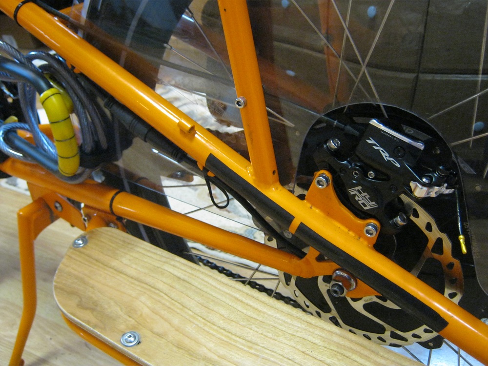

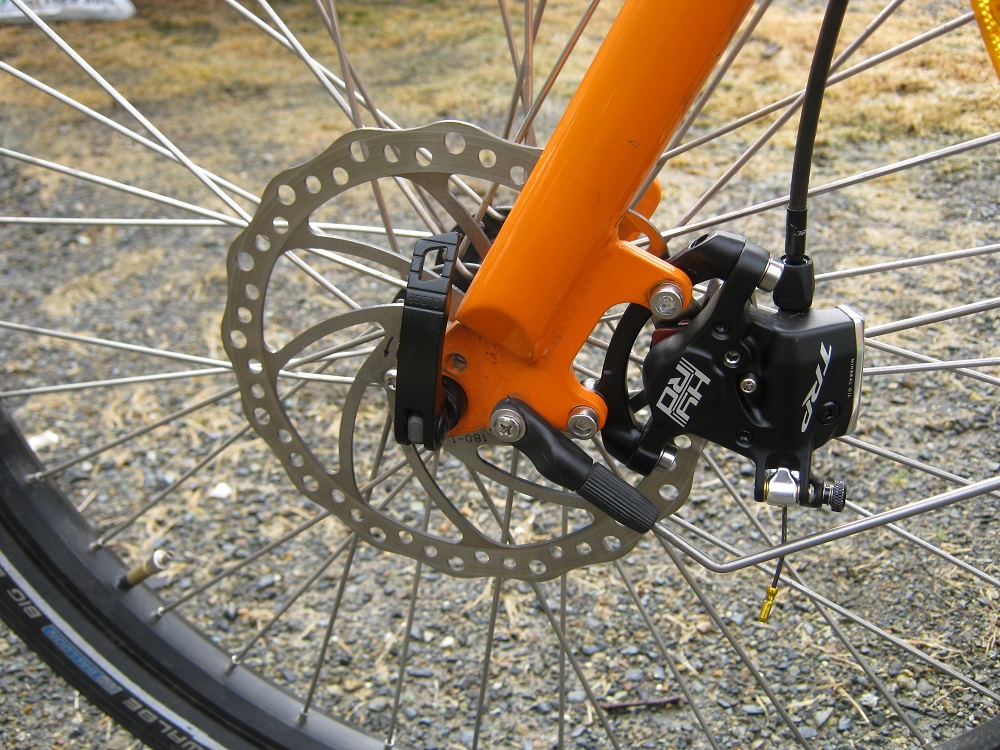

I got the cable actuated hydraulic brakes installed, wow, what a difference. A lot stronger and more progressive...and no more manual adjusting!
The front was super easy to install, literally easier and faster than adjusting the OE brake. The rear was a little more time consuming as the wheel guard needed to be trimmed and adjusted, and the cable rerouted behind the wheel guard.
View attachment 16410 View attachment 16411
