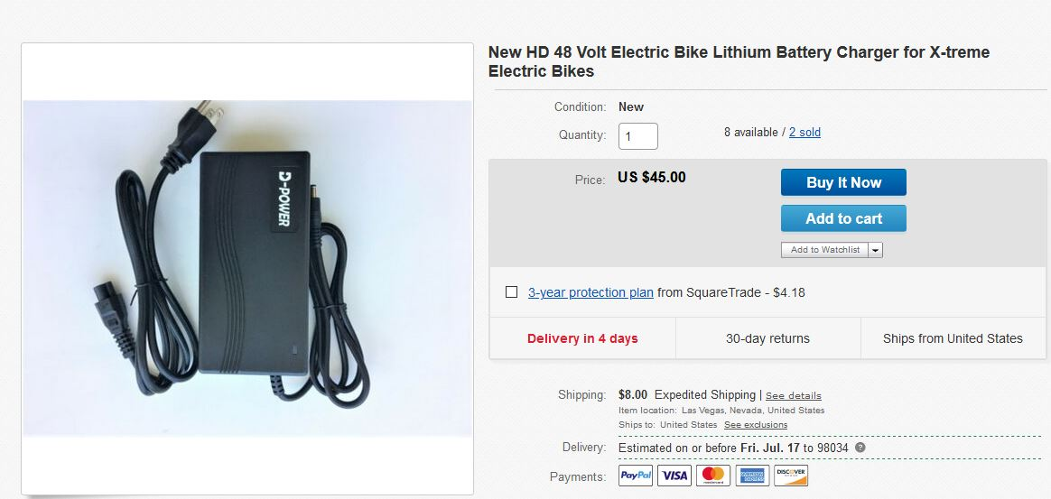

ExPatBrit: Is this the right/correct charger for a 2017 Rad Rover? Also, where/how do you change the fuse on a Rad? Thanks. Curt
The rad is 2.5 mm, this is 2.1 (center pin).
In practice a 2.5 mm and 2.1 mm barrel plug are often interchangeable (tolerances are never that tight on this kind of stuff)
You could always switch it to the bigger plug. Its only 2 amps .
What's in there now?
And not trusting the battery, or the new charger, I'm thinking I would likely be nearby to monitor how things are going.
I do this with any new battery device. No first time charging unless I'm nearby to yank the cord and/or unleash the fire extinguisher.
