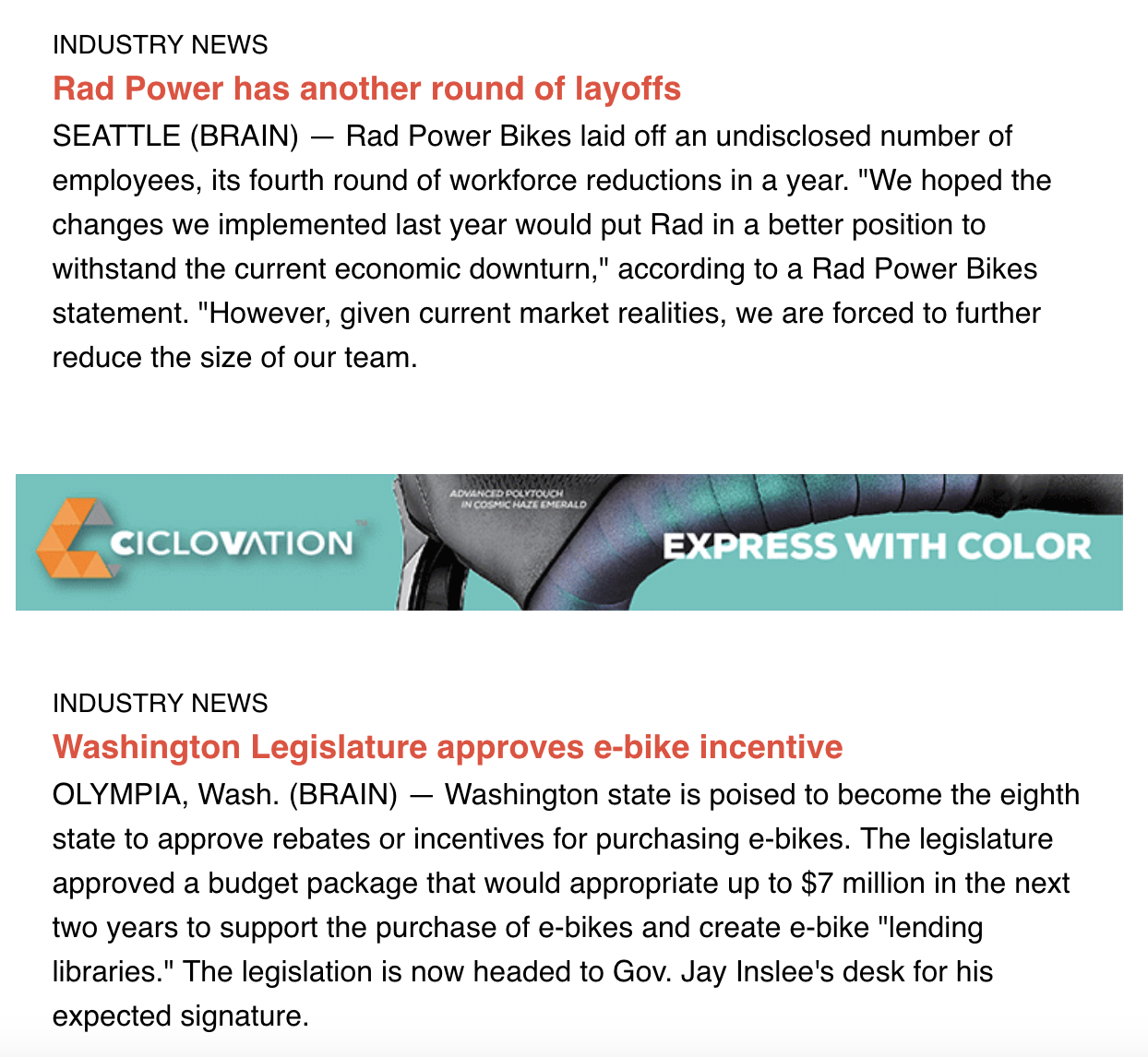

I suspect a lot of those nice support people have been laid off. I asked her point blank if they had, and she just repeated that they are restructuring. It was like talking to HR during a mass layoff.
Anyone know any more details about what is happening?
