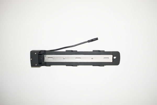

the first has to do with the Heileng plug adapters from China. I can get a replacement cradle for the battery, which has a connector and a wire coming out of it for fairly cheap. Would this also work?
secondly, regarding the waterproof case for storing the battery. It seems a bit counter intuitive to pay a lot for a waterproof case and then drill a hole in it to pass a wire. I am not at all familiar with these things, though, and may be off base
Thanks GView attachment 102354
The picture is of the rad battery replacement cable

The replacement battery cradle would also work and might be more readily available than the Hailong connector.

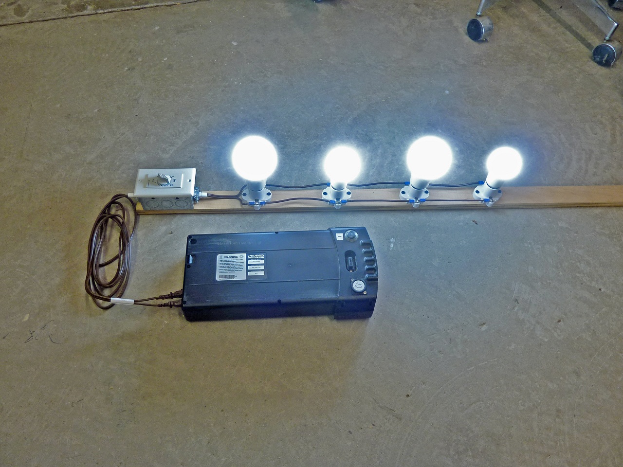

I share your interest in finding alternative uses for these expensive e-bike batteries. So far, all I've come up with is a portable light source for power outages and working outside at night. It also works well in my utility shed which has no electrical service.

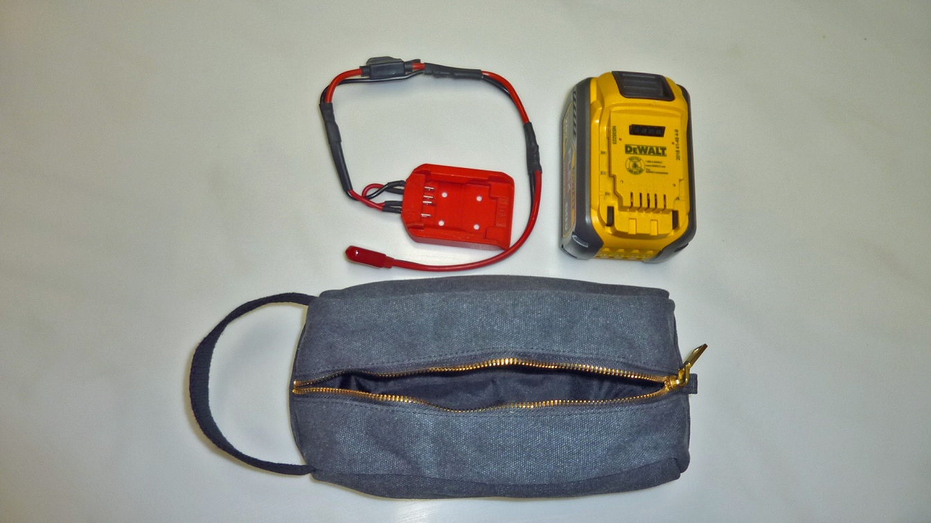

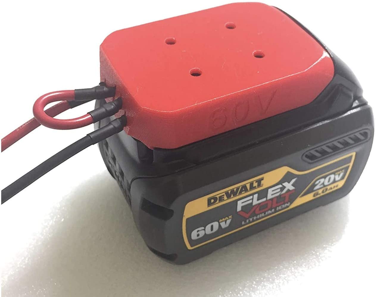

Conversely, I've also been experimenting with ways to power my e-bike using other battery types. I found these adapters which are available for most brands of power tool batteries:
I made a "range extender" kit for my bike using this adapter with my supply of DeWalt tool batteries:
I have seen this idea used to power trolling motors as well:
Of course, this method is only cost effective if you already have a supply of power tool batteries on hand.
