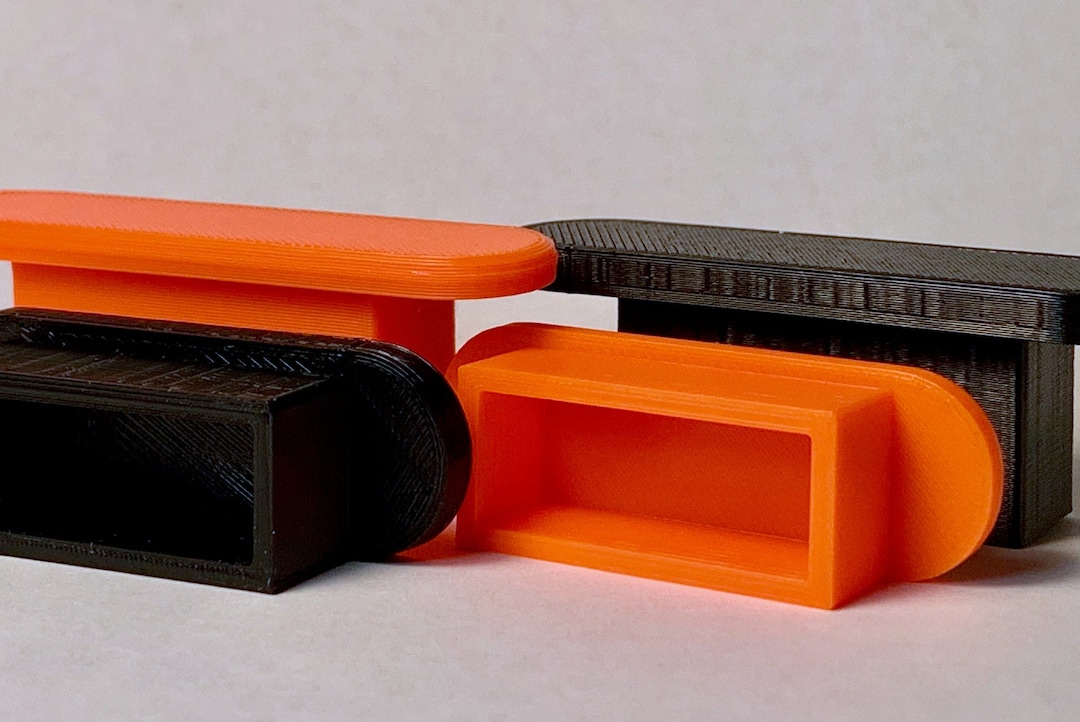

These plastic protector caps fit the battery port on the Rad. It should be possible to fabricate electrical contacts with screws or bolts to make your own power plug.

The battery caps I mentioned above fit both the battery and the bike. I don't know what the actual electrical contacts look like on the battery, perhaps you could post a picture. The idea would be to make a plug by drilling two holes in the cap and place a bolt in each one. The bolt would then make the electrical connection when the cap is snapped on.
It isn't a plug & play solution and does require a bit of fabrication.

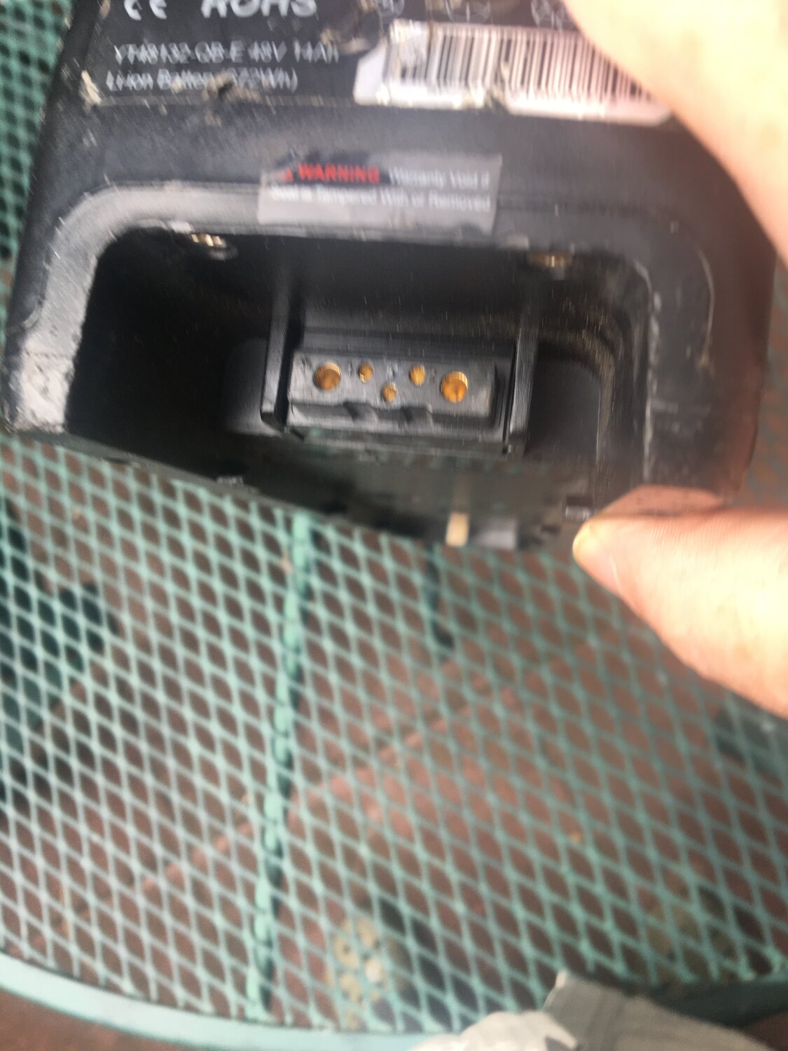

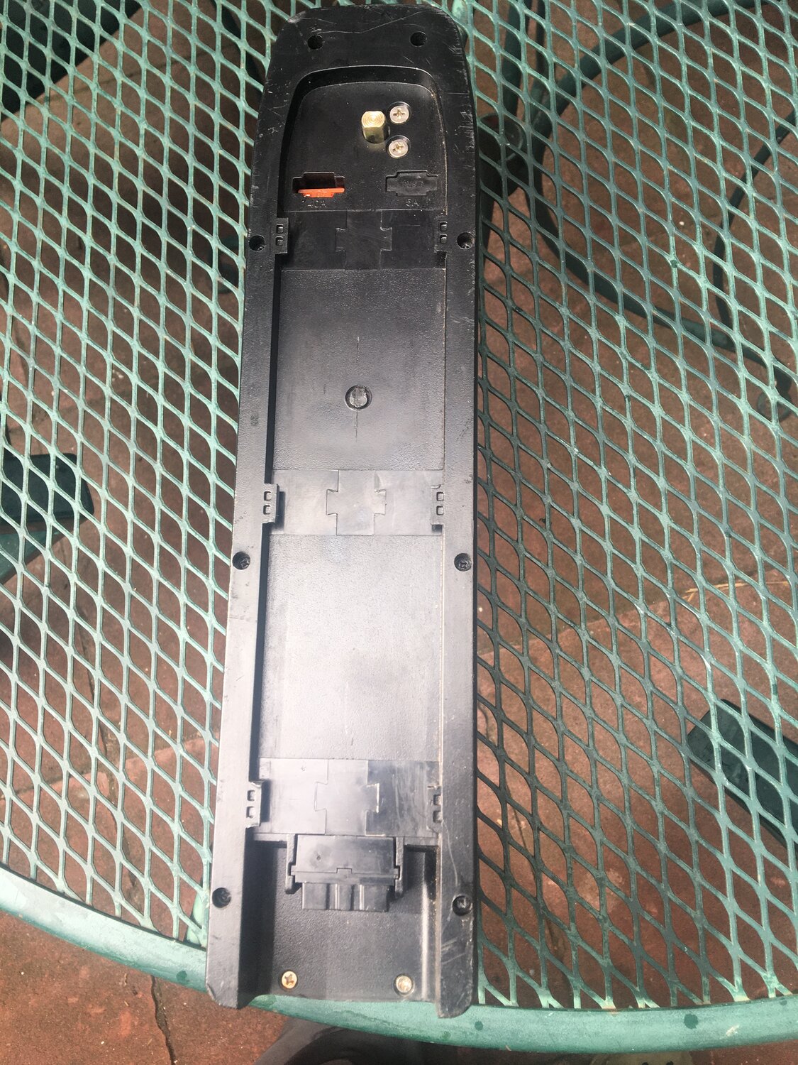

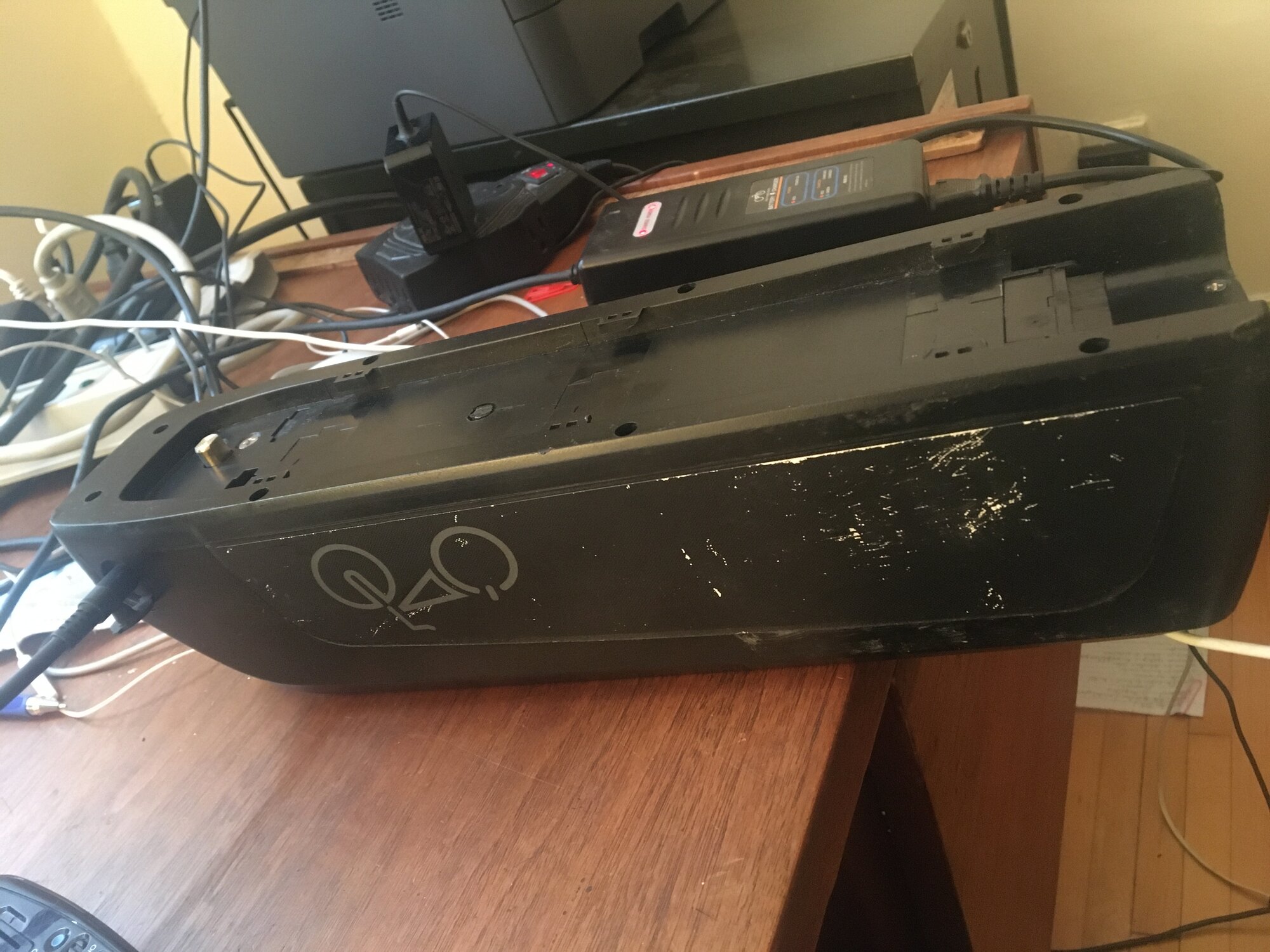

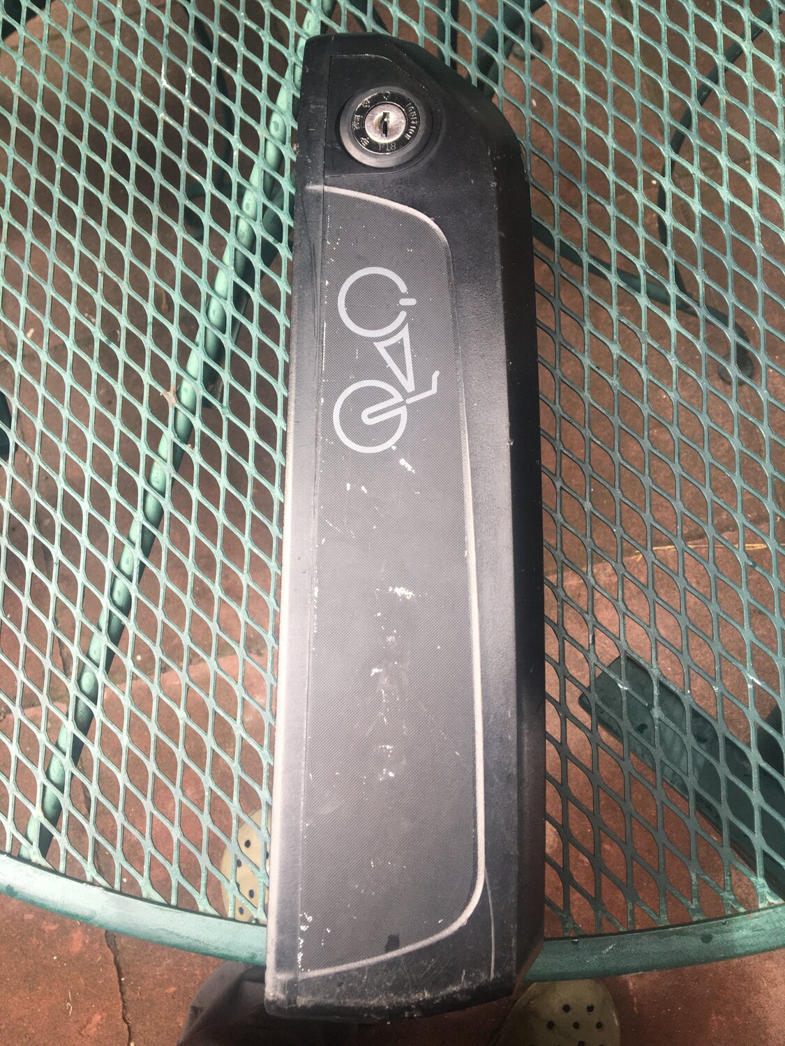

I will take you up on that offer and post a few photos of my battery. Delighted with any suggestions
Thanks G

Ok, the easiest way to do this is to order these Hailong connectors:
They ship from China and may take a few weeks to arrive. You will have to solder your own wire to the larger pins on each end. The 3 small pins in the center aren't necessary for what you want to do..
Here is a you tube video of someone who made a second battery adapter for his Rad using these connectors:
That's why I asked for photos... Exactly what I was thinking..
