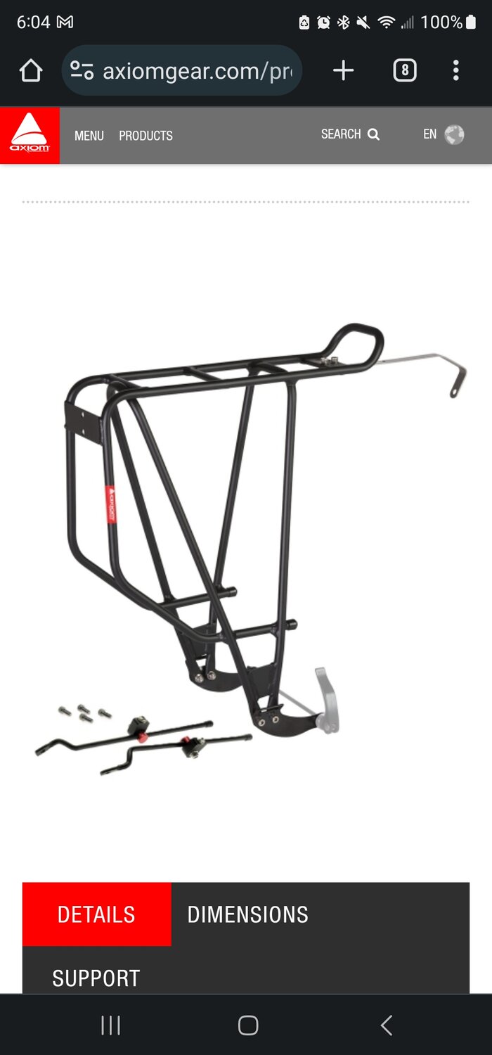

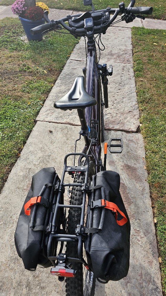

I know this post is a bit late, but I use Axiom DLX Streamliner Disc rack with Ortlieb gravel bags. I love this rack because it sits back out of the way, it fits on every bike I've owned over the past 3 years, and it now costs less than $60 on Amazon. I also use an Axiom seat post collar with a rack attachment.
What is the weight limit for that rack?
PRODUCT INFO
Compatibility: 26”, 27”, 27.5", 28", 700c
Stay length: 395mm / 15.6”
Platform size: 355x100mm / 14”x4”
Weight: 710 g / 1.56 lbs (including hardware)
Capacity: 50 kg / 110 lbs
Part Number: 171271 - Black
It comes with a center mount bracket (mount to fender eyelet) as well, but that's not as sturdy as the two arms connected to the seatpost.
I put this rack on ebikes, mountain bikes, gravel bikes. It fits everything with plenty of clearance for fenders, etc.

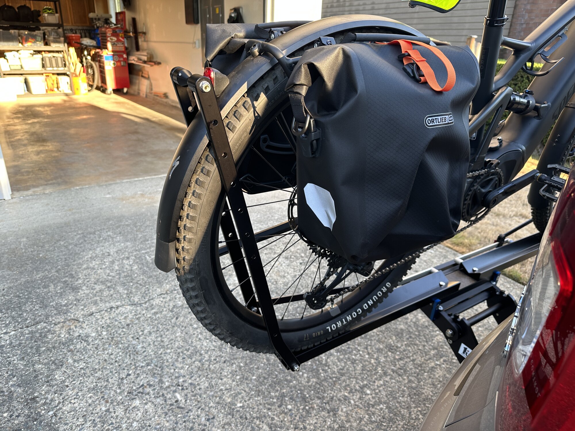

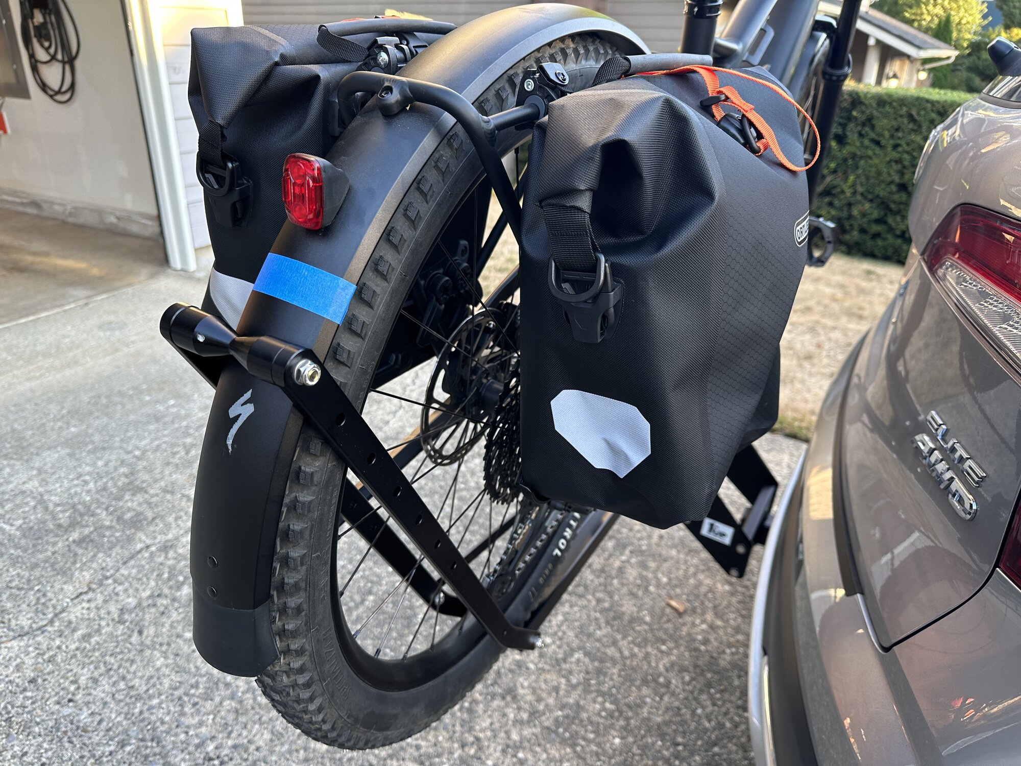

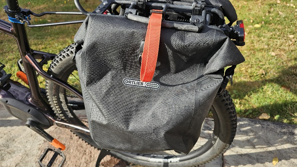

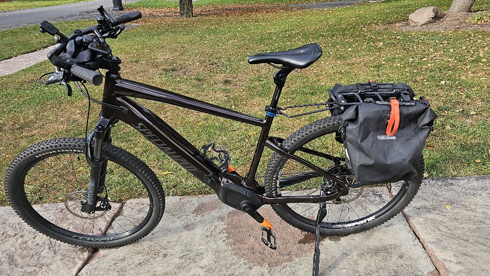

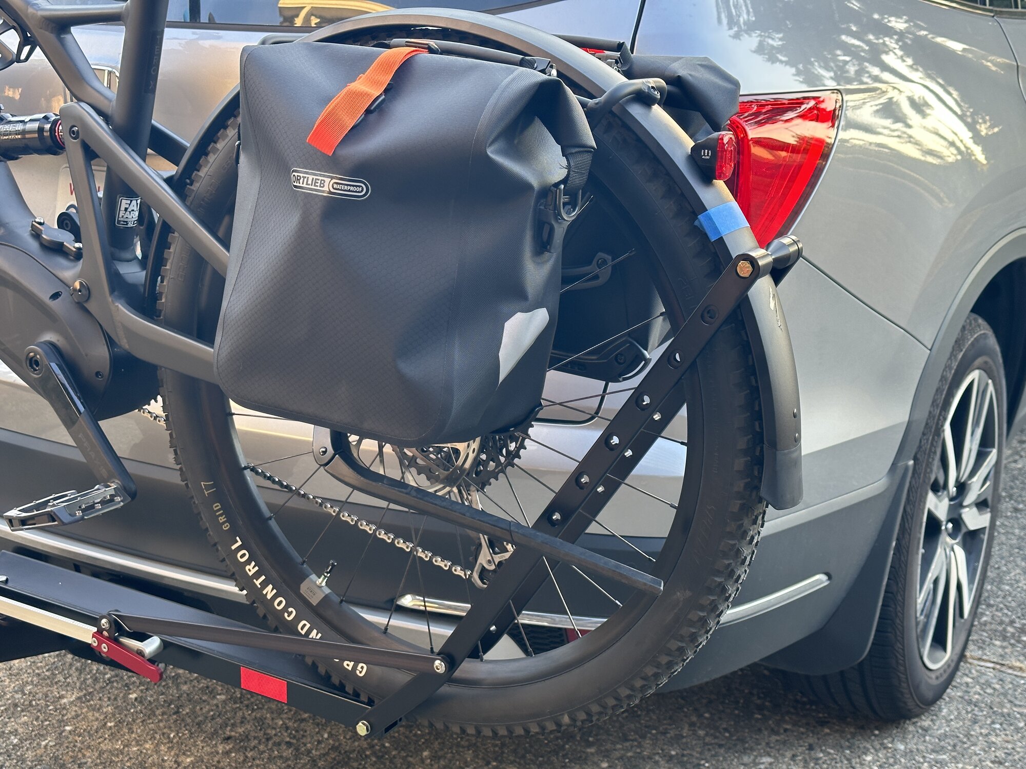

I use Ortleib Gravel bags on a Tero 5.0 with a Salsa Alternator rack fitted to the back and a Tero X 6.0 with the stock fenders and panier rails that support the fenders. The Ortleib Gravel Bags are no nonsense, lightweight, and water proof.
