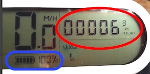

I was playing around with the new display unit I received (the updated LCD control unit) and I see there is another metric that comes up called, "Distance To Go." It will display in the user's choice of either mi or km.
What is this estimating? Distance To Go for what, exactly? On my display unit, even after resetting it, it was showing 6.3 mi to go. Can't be distance left on the battery because as you can see below, my battery is at 100%. I looked at the manual for the new display HERE, and there is no additional information about that reading.
Also, there is a new setting for the Ah. What is this? What should this be set to? It can be changed with the + and - keys. But again, no mention at all in the manual from Easy Motion about this setting, what it corresponds to, or how it should be set.
The manual leaves much to be desired as it's missing explaining all the features

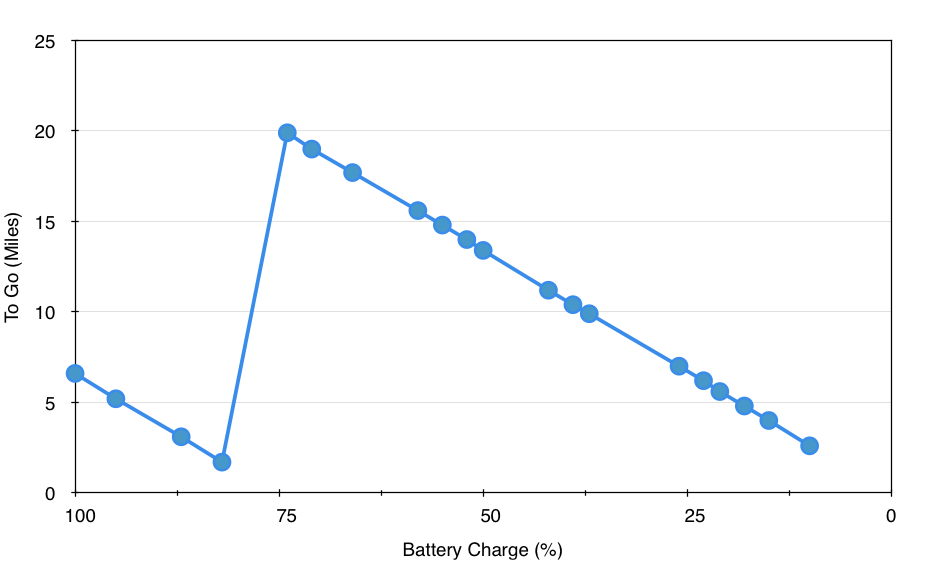

The Miles to Go readout is not random and is in fact very ordered over a wide range of battery charge (see chart below). However, as can be observed in the chart, there is a discontinuity above approximately 75%.
If one extrapolates the data contained within the linear portion of the chart for % battery charge values between approximately 75 and 10%, the line intersects the y-axis at approximately 27 miles. The linear regression of that data yields the following equation: y = 0.2691*X - 0.045 and has a correlation coefficient of R^2 = 0.9999. In other words, the algorithm appears to be based upon the assumption that a full depletion of the battery will yield a trip distance of approximately 27 miles.
Given the extreme linear nature of the response, it appears that the algorithm used to generate the "To Go" readout is based upon the same information used to generate the Battery % Charge readout. That information appears to be contained within the electronics inside the battery enclosure, since both the "To Go," and the "% Battery" values return to the same readings when the battery is removed and reinserted into the frame. The presence of a "Fuel Gauge" on the battery supports this assumption.

Neat analysis. You could send this to EmotionUSA tech people and educate them :)
Interesting discontinuity at ~75%

Note that in the graph above at no time does "mi to go" ever estimate a range higher than 20 mi. BH/Easy Motion claims the bike gets between 30mi and 60mi per charge, depending on lots of factors.
The highest mi to go my bike ever showed on this new console was 19 mi, and that was after the console started with "6.3 mi to go" on a full charge, then decreased down to zero over a few miles, then reset itself when mi to go ended at "0" and displayed 19 mi to go (similar to the graph above).
Whatever is being measured is not accurate, as far as I can tell.
The data from the graph above was generated with an 11.6ah battery. Values could be different, depending on battery size. It is apparent from the data that the values from 100% charge to 75% are not indicative of expected distance. If one wanted to use the values prior to the discontinuity, one could add "20" to the number (e.g. 20+6.3 = 26.3), which would provide a reasonable estimate of range.
However, this does not mean the actual distance on one battery charge will be 26.3 miles. The actual value could be 16 miles, 26 miles or 36 miles, or some other value. The BH manual makes a statement to the effect that the actual miles will depend on terrain, speed, input from the rider and other factors, which makes sense. Nevertheless, the algorithm seems to have ~27 miles as a range assumption, which is outside the 30-60 mile range referred to above.
It also seems that the "To Go" value will most accurately predict the actual miles to go, the closer the battery is to full depletion. That is to say, the accuracy will be better the closer the batter is to empty. This would require additional data to demonstrate; but is based upon the apparent simplicity of the algorithm and direct observation.
Easy Motion's top ah battery size is 11.6 at this time. That's the battery my Street uses (which is the same bike you have). My wish is for an accurate range estimate, right from the get-go, even if the battery is fully charged.
If Easy Motion plans on updating the display code, perhaps they could either eliminate the discontinuity altogether, or if that is not feasible, display no numbers in the "To Go" field for the first 25% of battery depletion. The current display generates "To Go" readings for the first 25% of charge that are confusing due to the discontinuity. The current algorithm gives the impression of being a "beta" version.
One can also imagine more advanced algorithms, that add a multiplier based upon the PAS level. Even more advanced algorithms could be envisioned, such as described by Ravi above that take into account previous or current ride data.
