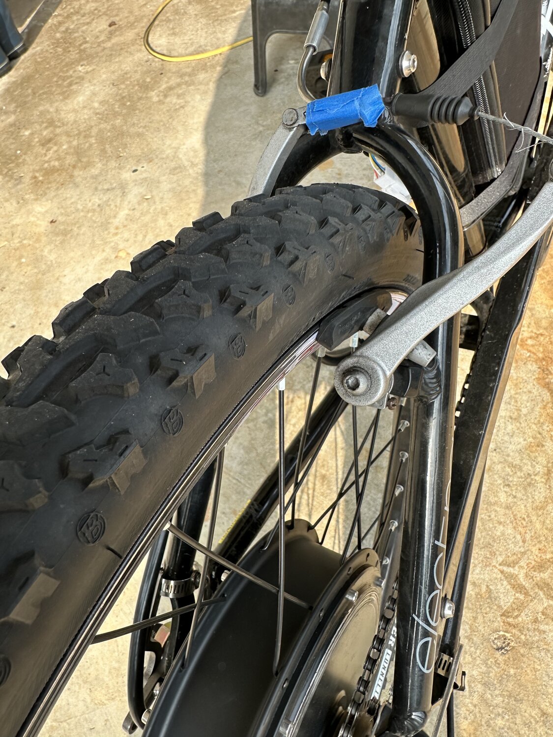

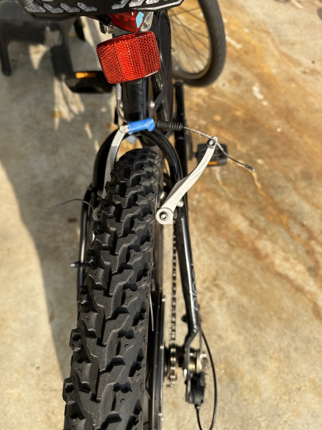

I do have a question I have a rim brake I can’t seem to get it to work correctly is it repairable or just get a new set up
The brake arms are not centered over the wheel. You have to adjust the two springs on the arm pivots so they stand up centered over the wheel. You have to adjust the pad position & tilt so they hit the rim squarely. Then you adjust the cable so there is just enough play that the handle can pull the arms tight against the wheel.
Park Tools great video on adjusting V/linear pull brakes. Even after 20+ years of doing it myself I learned a few helpful things from the video.
