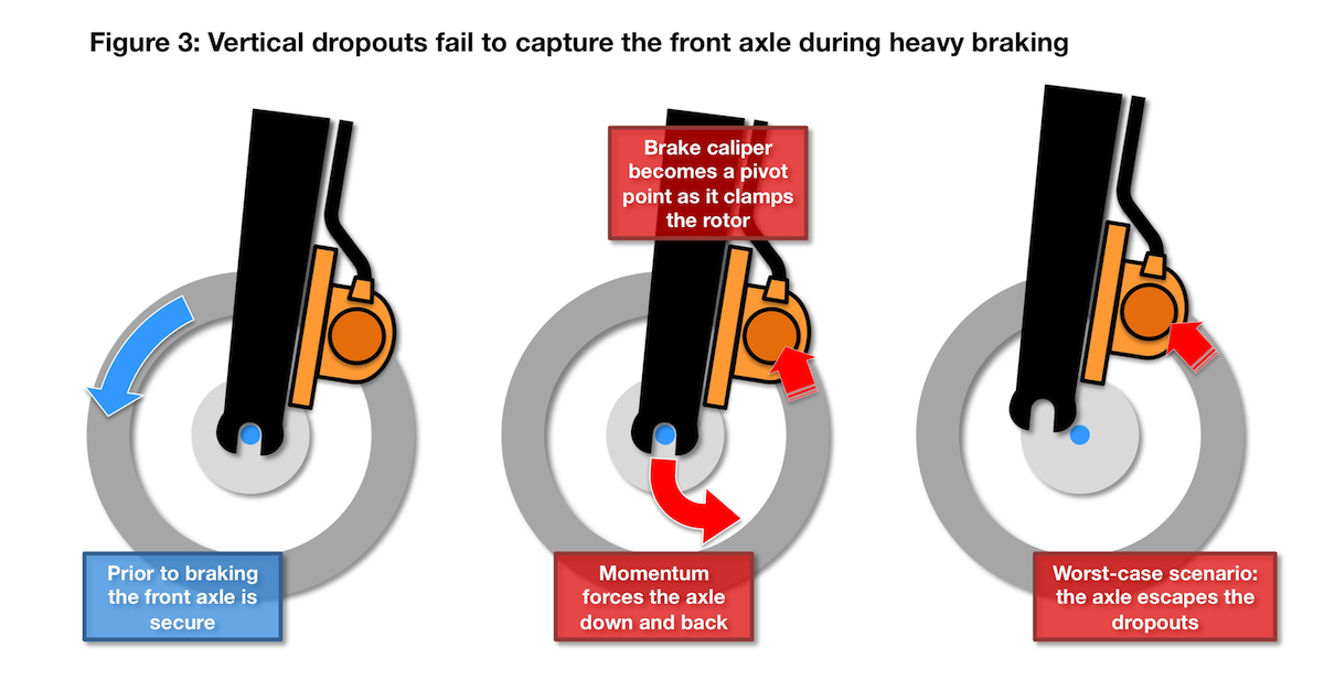

it’s not really “downward braking force,” it’s a rotational force in reaction to the rotor getting squeezed “above” the dropout. there is a downward component which wants to push the axle “out” of the dropout if the dropout goes straight down or mostly straight down. it was discussed in a little more detail on another thread here, or maybe it was at a different forum, but it’s real. easily solved of course but i have no idea if rad has done so or not.
the diagram referenced in the first post explains it better than my very rusty physics:
Has anybody ever heard of anyone getting injured from this before on a Rad? Can't help but wonder if the shaking and wobbling the bike was doing going down the hill was caused by dropouts that were floating before the descent.

I've never heard of this sort of failure before, I can picture how it might happen if the wheel is in the air and has enough rotational energy but in the real world I don't see it happening. Especially when the center of gravity shifts forward and effectively traps the wheel between the ground and the dropout.
Exactly what I'm thinking, but who knows with a second person on the back. Could the weight distribution affect things? Frankly, I think the lawsuit is ridiculous. CN
