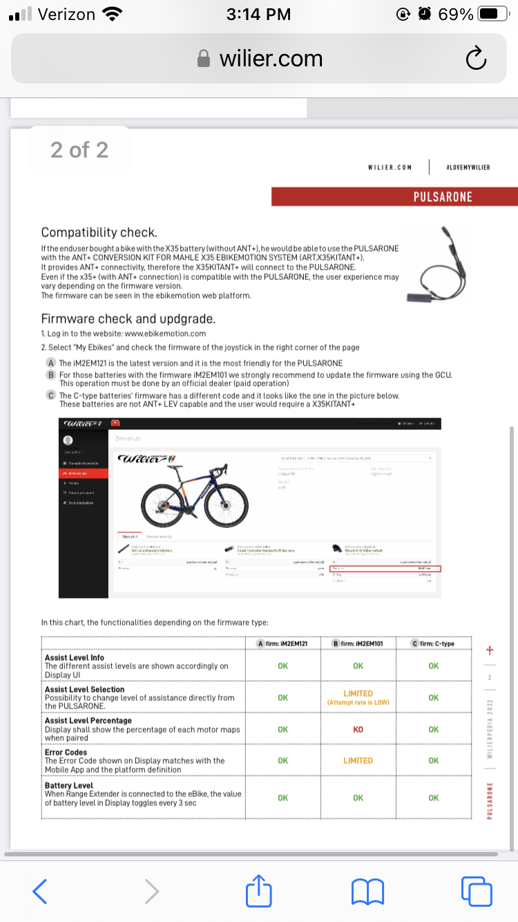

I think my battery needs to be upgraded. It shows 3 types of batteries that can be paired with, but my battery isn’t on the list. My Joystick data version is
iM1EM119 . Do you think it needs an upgrade to pair with the PulsarOne?
Here’s the manual for the PulsarOne:
I’ve also attached a screenshot of the page from the manual regarding firmware compatibility.
Hope this helps!
